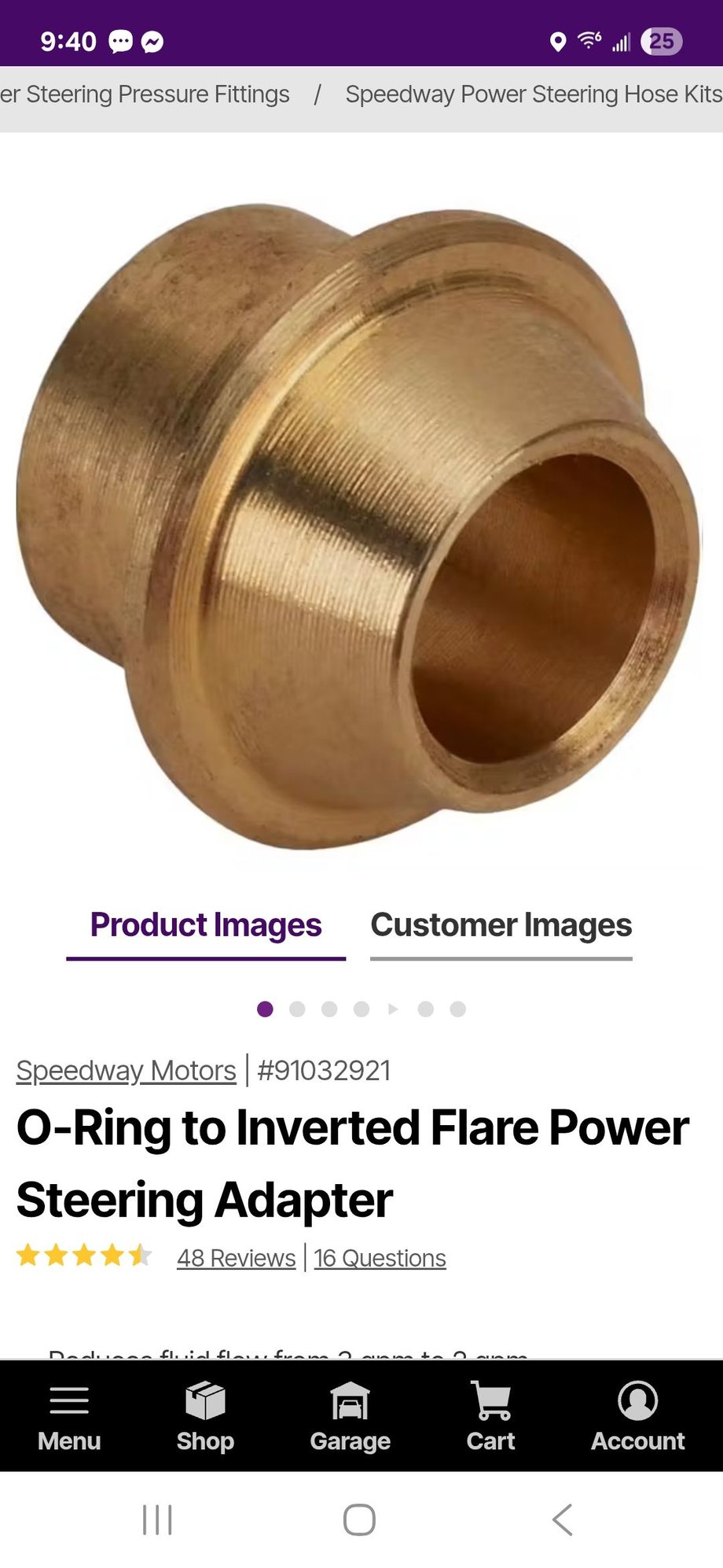

I installed the brass fitting but it leaked. I couldn't pry it out so I drilled it out. Replaced the fitting with the correct fitting.... not the adapter to adapter to another adapter that Borgenson provides. I also replaced the low pressure hose, for a slightly longer one... so it didnt kink going into the back of the pump.

Im about to install my 4th, I use these instead of the ferrules in the kit... they give more threading
also I use one of these for return line to avoid the kink
