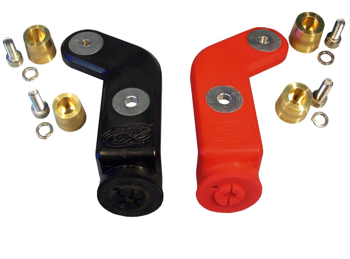

Here's a simple solution to use a side terminal battery - convert to a post with options

Thanks Richard!
Those are really nice.
I can’t make out the label, who manufactured those?

XS Power-
https://www.crutchfield.com/p_122555...apter-Kit.html

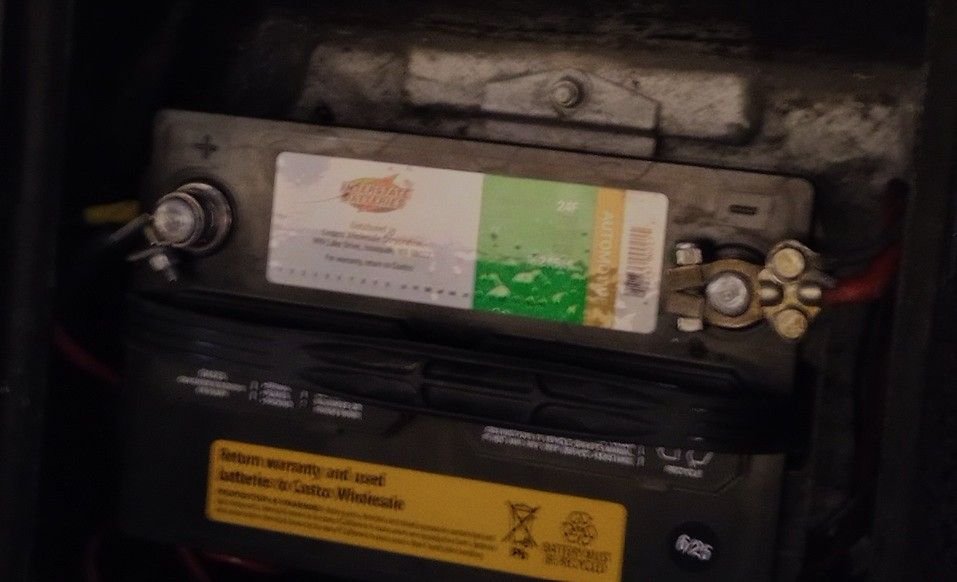

I put this battery in my 68 a couple of months ago. May need to slot that rear mount sliding plate.
--Costco item number 1624514 refers to a Costco Interstate 24F STD battery.
It has a group size of 24F, 700 Cold Cranking Amps (CCA), 875 Cranking Amps (CA), 12 volts, and a reserve capacity of 130 minutes.
The battery is manufactured by Interstate, but sold under the Costco Kirkland Signature brand.
