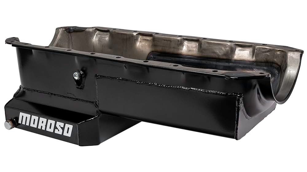

Another option is Moroso's Road Race pan with a kickout sump. I ran this on my BB, you get ground clearance and the capacity.

My Milodon 31188 is no lower than my QuickTime bell housing. I like having the 6 qr capacity and the stepped design helps keep the pick up covered. I had a Moroso pan originally but would lose oil pressure on hard acceleration in 1st or 2nd gear due to the G forces and pickup becoming uncovered. Never an issue with the Milodon.

Another option is Moroso #20411. I have it on my 69 and am using the stock windage tray with it. Fit was perfect.
