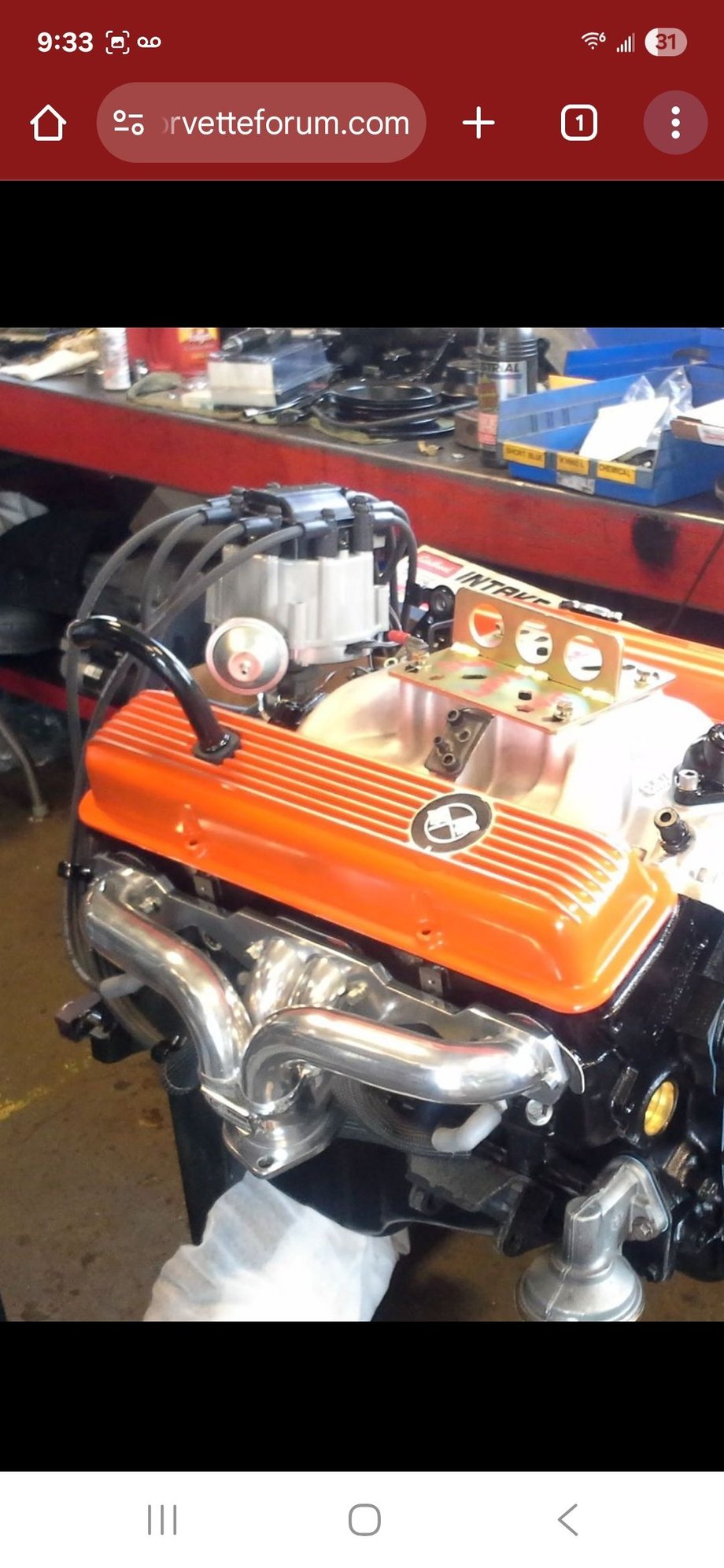

Thinking about block hugger headers and looking for experiences.
this is NOT about performance gains or losses, I currently have long tubes in a 1970 L46 car, I am installing 69 style side pipes and likely HighFlow Performance chambered pipes which are made to attach to factory manifolds, the block hugger headers would be as close to manifold exit and easiest to tie into the side pipes.
They are awfully close to the engine so how does this effect engine temps, I dont mind running some header wrap at the collector area but looking for anyone with experience in headers with factory style side pipes.

thanks... I absolutely plan on ceramic coated like the photo I posted, I've installed ceramic coated headers before and for under the hood headers the only way I would go.
my question was more about heat near the engine with the block huggers as well as motor mount clearance from those who have installed them.
block huggers wouldn't be my first choice in headers other than connecting to factory style side pipes.
I've located a brand new set of ceramic coated block huggers I can get for $100 locally... cheap enough to check for the clearances

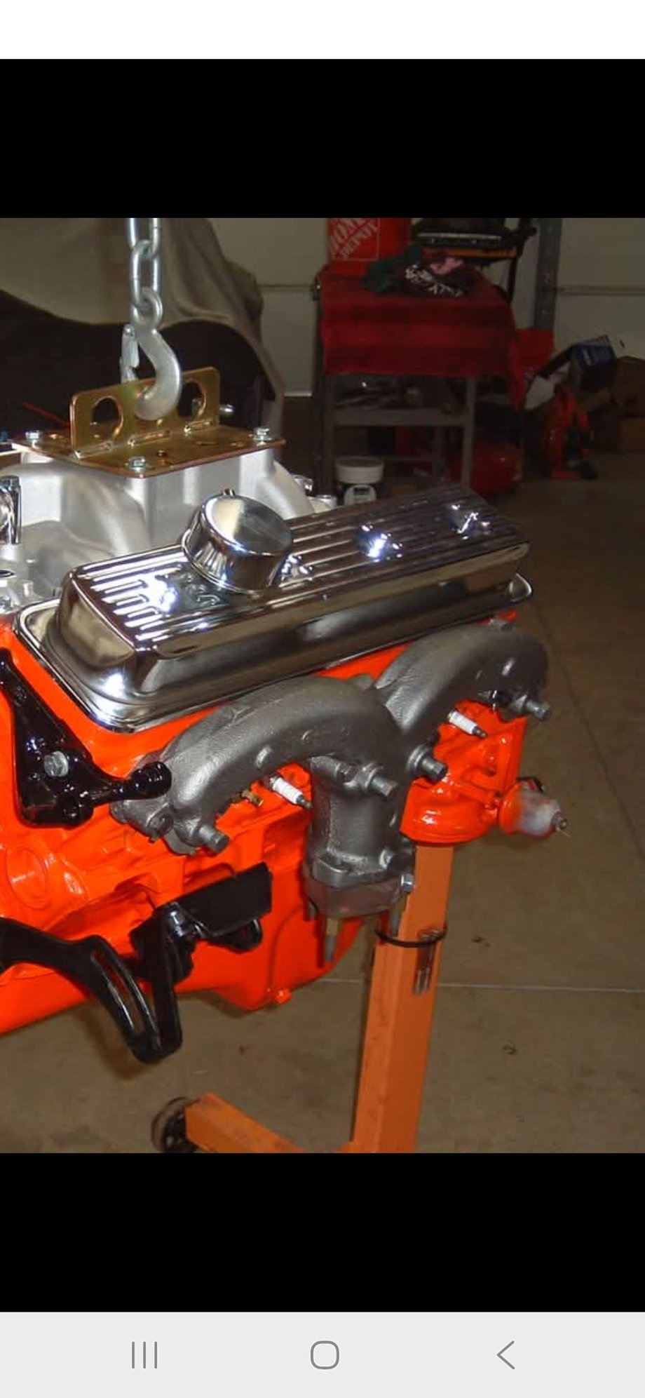

I believe the block hugger outlets are in exactly the same place as the stock rams horn manifolds.
Some of the side pipe options require that.
thank you... the block huggers are definitely closer to the block over stock manifolds however I just discovered these super shorty headers that will be much closer to manifold exit point and further away from block with no worries of motor mount clearance. I believe im just going to order these... I can fabricate what might be needed to tie in.
Now the question is which HighFlo pipes to use... stock sound or mild

if you look at the stock manifold exit location its not close to where the block hugger exits, further down and closer to the block... very close to the motor mounts
but im thinking these will be very close and the direction im going
