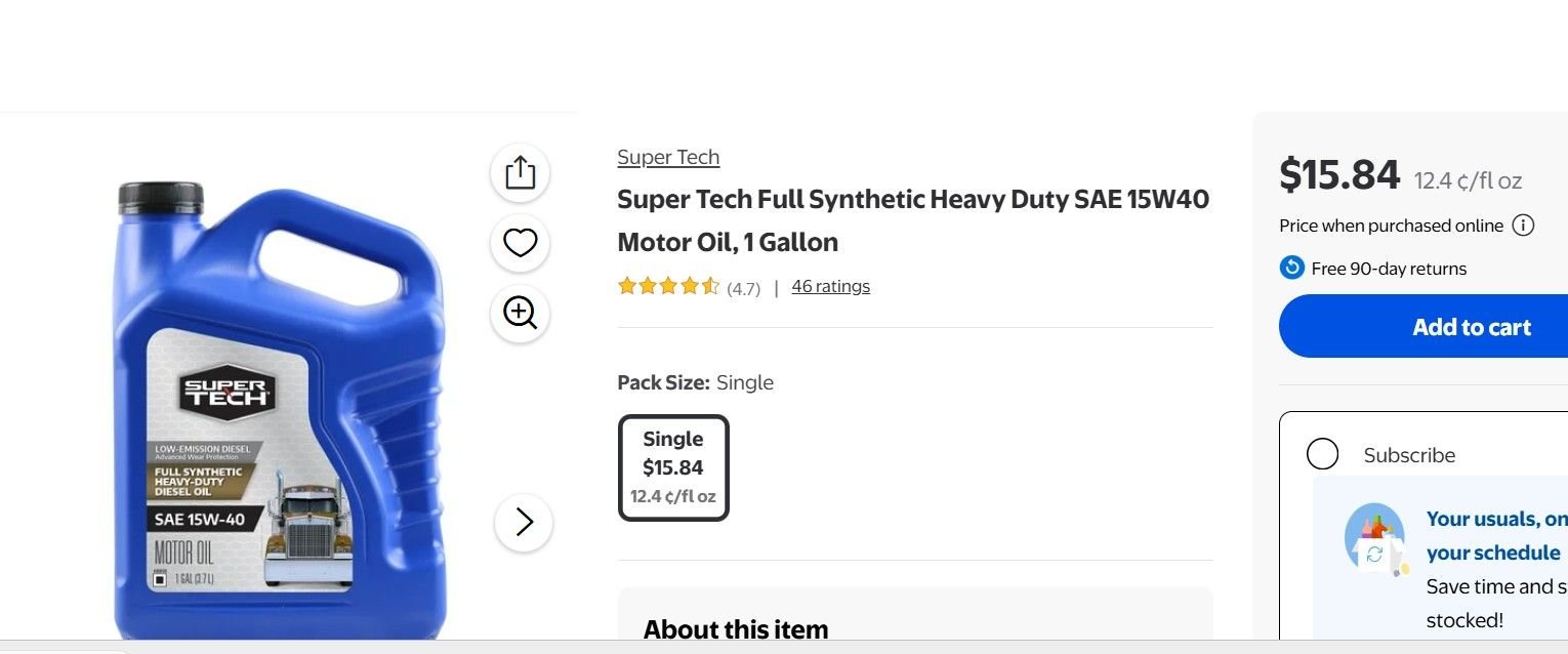

Started using this when i could not find 10w-40 easily. Full synthetic 15w40... never really cold and didn't even worry about it when using old 30-weight ages ago....
