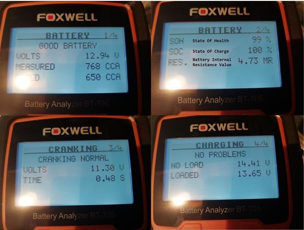

Isn't there a auto parts store there that can analyze the charging system, Like O'Reillys or Autozone here?
I have a Foxwell BT-705 Analyzer...
To check the condition of your charging system, battery must be in the car, you can preform a out of car test but that just checks the condition of battery.
4 of 4 shows the charging system with No Load and Loaded, Lights on HVAC fan speed High, Stereo & Amps mid volume...
I don't have many high AMP draw Accessories
Currently I have a 80amp alternator installed. The original alternator is 63amps...
