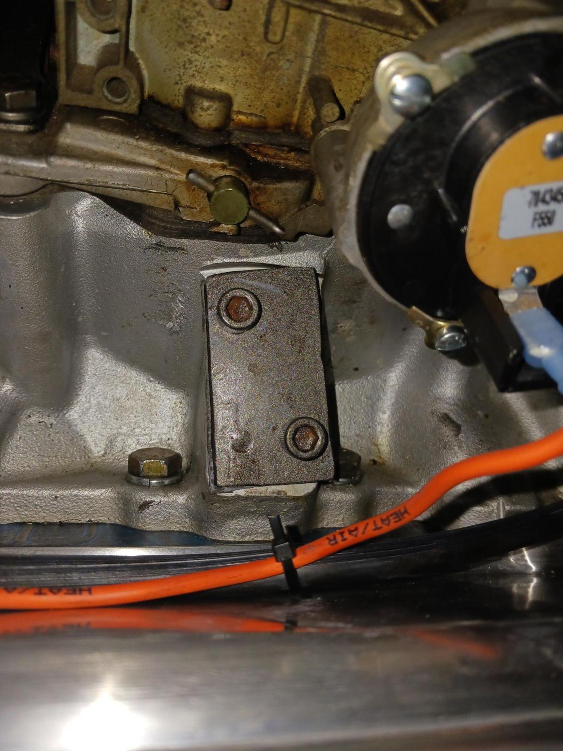

Not the rockers. I replaced the Proforms with the Comp Cams Magnums, same noise. Just before I left yesterday on vacation I had a thought to use the hose in my ear again instead of the stethoscope and check for exhaust leaks. I was poking around with the hose end and think I found the source, but I still don't get it.
Because the Trickflow heads don't have a cooling water crossover large enough for the choke tube, I changed to an electric choke and made a plate and gasket to cover the hole in the intake manifold:
Choke tube cover
Choke tube cover
The ticking is coming from this cover, specifically the right side of the cover. OK, not my best fabrication work. At first I thought 'ahah, vacuum leak'. But no, that's water passage under there. The gasket doesn't leak, so what the hell?
I'm writing to Trickflow and Mike Jones to see if they have any ideas. But does this ring a bell at all?

That's an exhaust crossover. No water. It's an exhaust leak you hear. There are a few ways to remedy this.

Well, crap, I didn't know that. Or forgot, it sounds familiar now that it's obvious. That totally makes sense though based on the sound. I'd been chasing around the carb with the stethoscope, but that wasn't getting the air-flow thing that was so loud with the hose. I just lost 3 weeks of driving and hours of shop time over a leaky gasket. What a dope....
Thanks again for all the feedback. Will fix it when I get home in two weeks.
