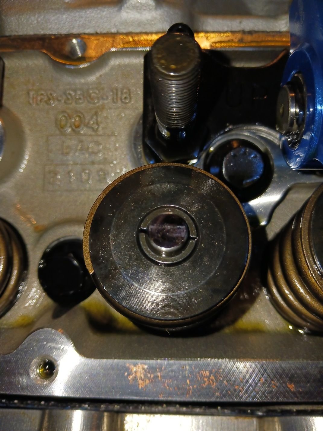

Oops, I just re-measured the deck surface to valve stem height, and the new heads are actually ~1/8" taller. Here's some pics:
I blackened the tip and rolled it a few times, heres the pattern.  This is #6 intake.
I blackened the tip and rolled it a few times, here's the pattern. This is #6 intake.
Side view of the geometry, valve closed.
#2 tips, the partial imprint on the intake valve tip doesnt look right?
#2 tips, the partial imprint on the intake valve tip doesn't look right?

Be sure to look for looseness in the rocker arm trunion bearings. They might have trash in there and ruin them in short time.
Hope you bought the lifters from Mike. No warranty without that.
The valve cover mounting surface is higher on aftermarket heads so not sure how you are measuring things. Good to reduce leaks and clear the valvetrain.
The rocker arm stud pad height is not a factor. Different pad heights just end up with more threads exposed above / below the rocker arm nuts. The valve stem and the pushrod tip and rocker arm itself stay in the same place no matter the stud pad height, so no change in geometry.

Head manufacturers move the valve seats from stock. If the valve stem tip rides higher, you need longer pushrods. If the lift changed, you need different pushrods if the base circle diameter on the cam changed, you probably need to check your geometry..... PLENTY of reasons to check.
The stud screws up or down in the same plane CENTERLINE.... but the rocker arm geometry DOES NOT CHANGE because of the difference in boss height.

Did you adjust the guide plates to get the rocker arm tips aligned with the valve stems? That #2 witness mark is a concern. Not all the way across pattern is rather odd. Definately look at the tip alignment/condition and the condition of the trunion bearings. This could be the source of the noise.
Getting the pattern centered is not as important as getting it narrow IMO. If you end up with a narrow pattern with a slight bias to the outside you would be fine. Better to be short sweep with higher pressure closer to the middle at full lift. That said, your noisy valvetrain is not caused by the pushrods.

Chris/Mark - when you say 'trunnion bearing', I assume you're talking about the center pivot bearing, not the roller tip? They all have a little end play, but don't seem to be loose otherwise. I'd go with the stock rockers as another check, but they don't fit the 7/16" stud.
In spite of the odd witness mark on #2 intake valve tip, all the rollers seem to line up fine on the valve tips. Good thing, there's not much adjustment in the guides.
Based on more trials with the adjustable, bought 7.9" pushrods from Trickflow. Will get back with results.
