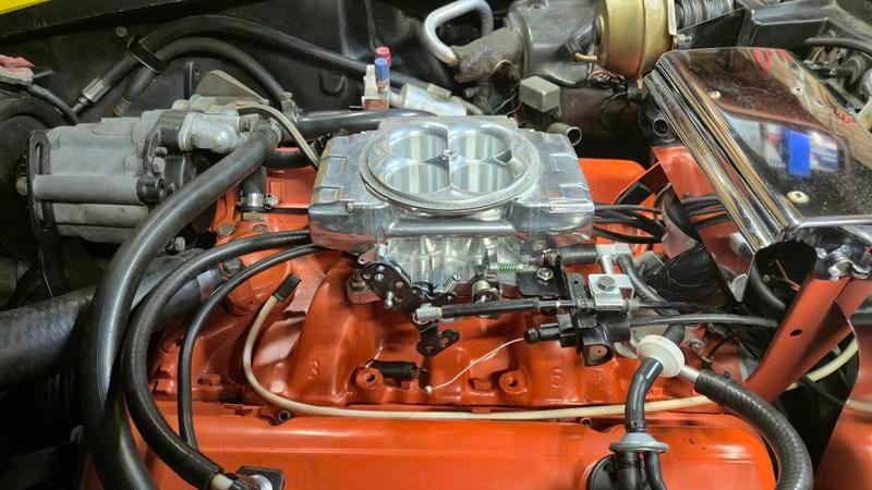

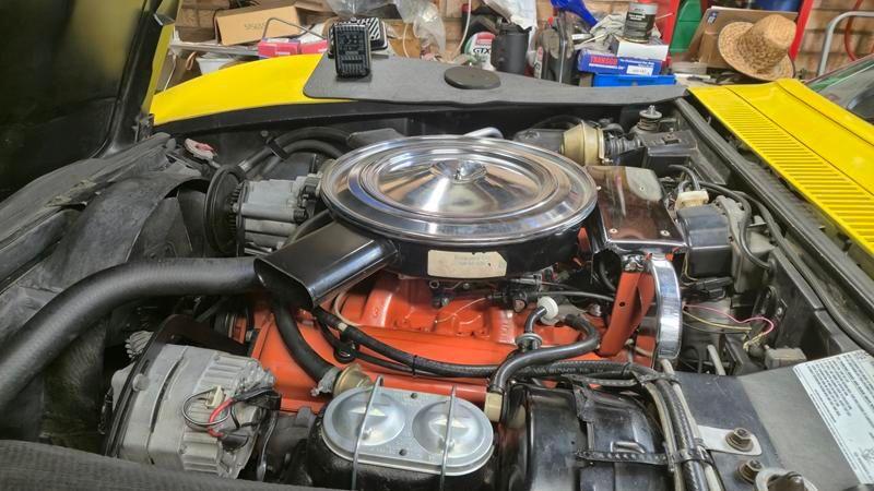

First off, they do not fit a stock type air cleaner very well, and do not fit under a std 72 c3 hood very well.
Here's my 350 1972 with a Sniper 2 fitted to an Edelbrock 2101 manifold.
Hyperspark distributor and round canister style coil under the stock shielding.
A quick 3D printed spacer to accept the original air cleaner indents and to suit the round Sniper 2 body.
Plenty of room under my stock flat hood.
Cut off the original air cleaner 1" breather tube and replaced with a 3/4" tube at about a 10° angle
Even looks stock(ish) under there, unless you bend down.
Have only had it back on the road for about a month, winter here.
Only problem was created by me when extending the cts wire and had created bad joins.
