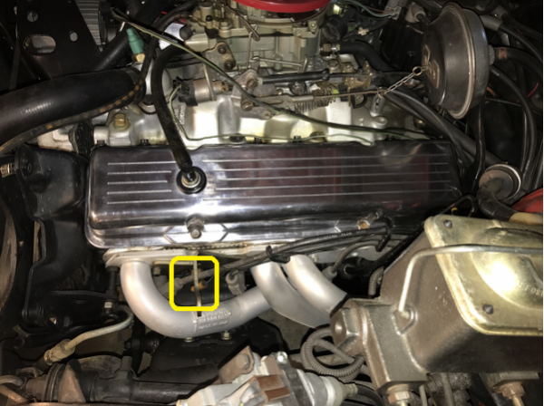

Gentlemen,
need direction to find where does the temp gauge connect to the engine? Trying to diagnose a non working gauge first without having to dismantle the console…..
TIA
(1980 350 automatic, cam & headers)
DW

Drivers side cylinder head between cylinders 1 and 3 below the exhaust ports.

Should be a green wire. It is on my 74.
If you short the wire to ground it will peg the Gauge.

On my 77 it's also a green wire, covered by a black heat protective sleeve however. Comes off the alternator harness, goes right where post number 2 shows it.

Here are a couple more photos.
You can see the green wire and woven heat 'sheath ' pretty well.
Regards...
