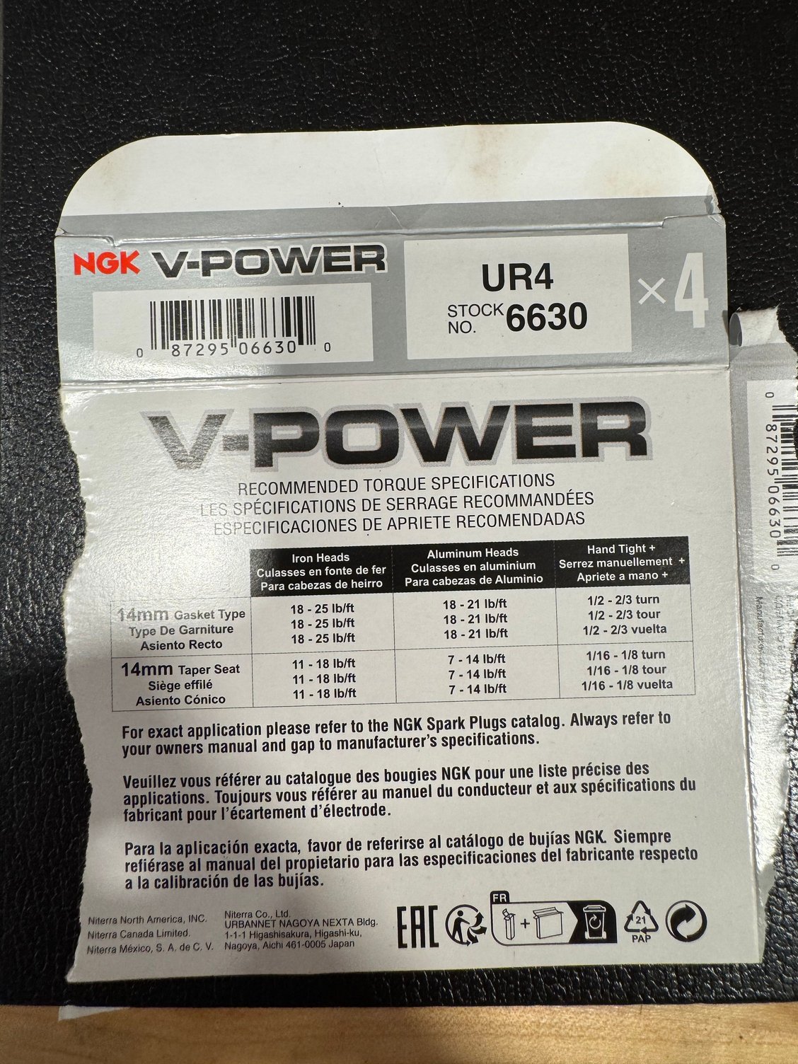

Attached is the NGK cross-reference guide.

I went with these for my 72 stock ls5.
