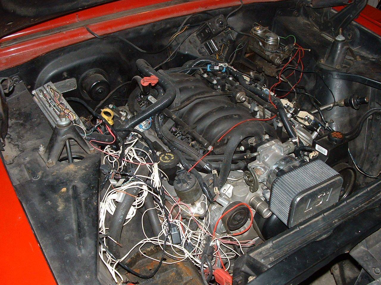

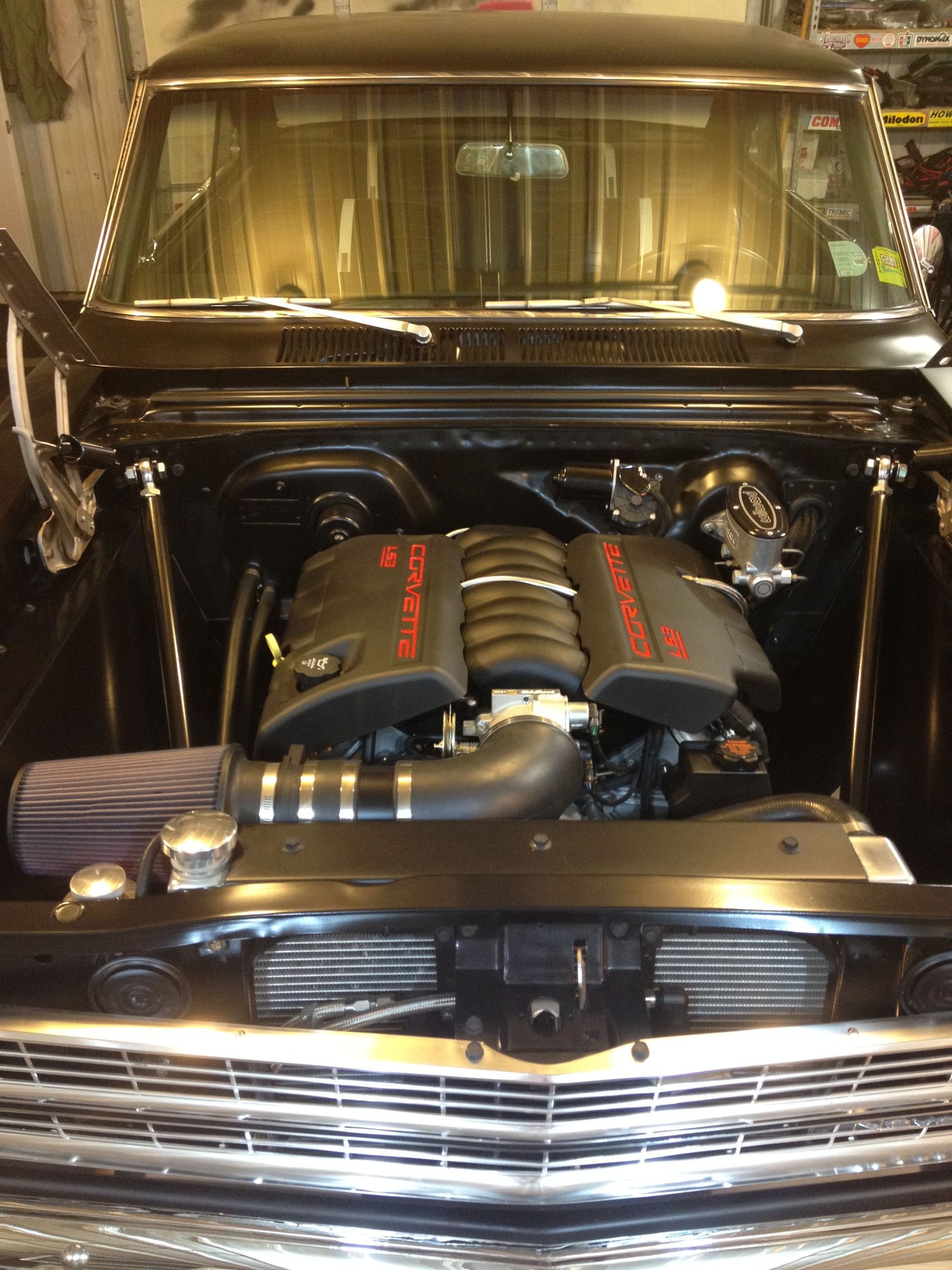

So you think you have wiring issues?
I bought this 67 Nova with a LS swap. Previous owner got totally hosed by a local LS swap expert. Before and after pics. LOL.
