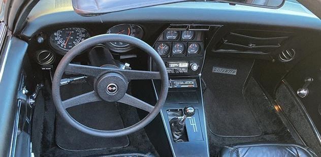

I dont have any LEDs, just good old incandesant. I need set in the car, I honestly havent been in the car since we bought it, been redoing the front end. I honestly think the dash is a pre-78, where it has a seperate speedo and tach pod, ,not one big square fishtank. Do you guys know what the indicators would show on 77/older models , with this style dash? ...I know we dont have a actual glove box, but the glove pockets.

Interesting!
That's a 77 interior (plastic center gauges, separate tach and speedo), with a 76 steering wheel.
There should be triangular cutouts at the bottom of the speedo and tach for the turn signal indicators.
I'd check that the VIN on your car matches the engine, the door sticker, and your title. Perhaps someone just really liked the 76-style dash and steering wheel. Or perhaps your car is made out of a few other cars, in which case some of the year to year differences might bite you with your electrical issue.

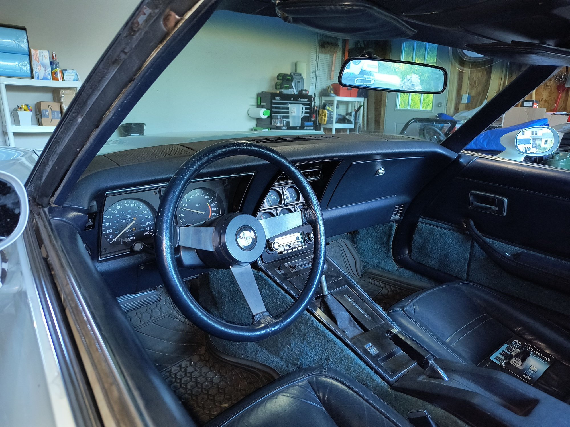

So that pic I posted, was just a Google image search, it's not actually mine. I am going to get a better view of mine here tonight, so I know when I'll be home with.
I've check the door tag to find out the original color, and I'm fairly certain it was assembled in December of '77, in the VIN has the eight and so it's a 78 model year.
I do have the larger back window, the bubble or the arrow version whatever it is called, Big slope piece of glass versus the vertical notch of the older ones.

I was way wrong, my car does have the 78 up style dash...sorry for misleading, Ive spent more time under this car than in it. I did discover though, we dont have any interior lighting, no dash lights no indicators no dome/map light. Does this sound like it may be a/some fuse issue, or possible a bad headlight switch? The switch does activate the lights, and they do pop up when running. but turning the **** makes no dim or turning of lights on or off. All turn signals and 4 ways operate, all brake and parking lights come on as well, just nothing interior.
heres my car too to show I was wrong about the dash

I'd stick to my original suggestion. After you check all of the fuses (78 was the last year for glass fuses), check the printed circuit boards on the back of the gauges.
Also, twist the headlight switch. There's a coil rheostat inside. Sometimes it corrodes in a single spot, but other spots work.
