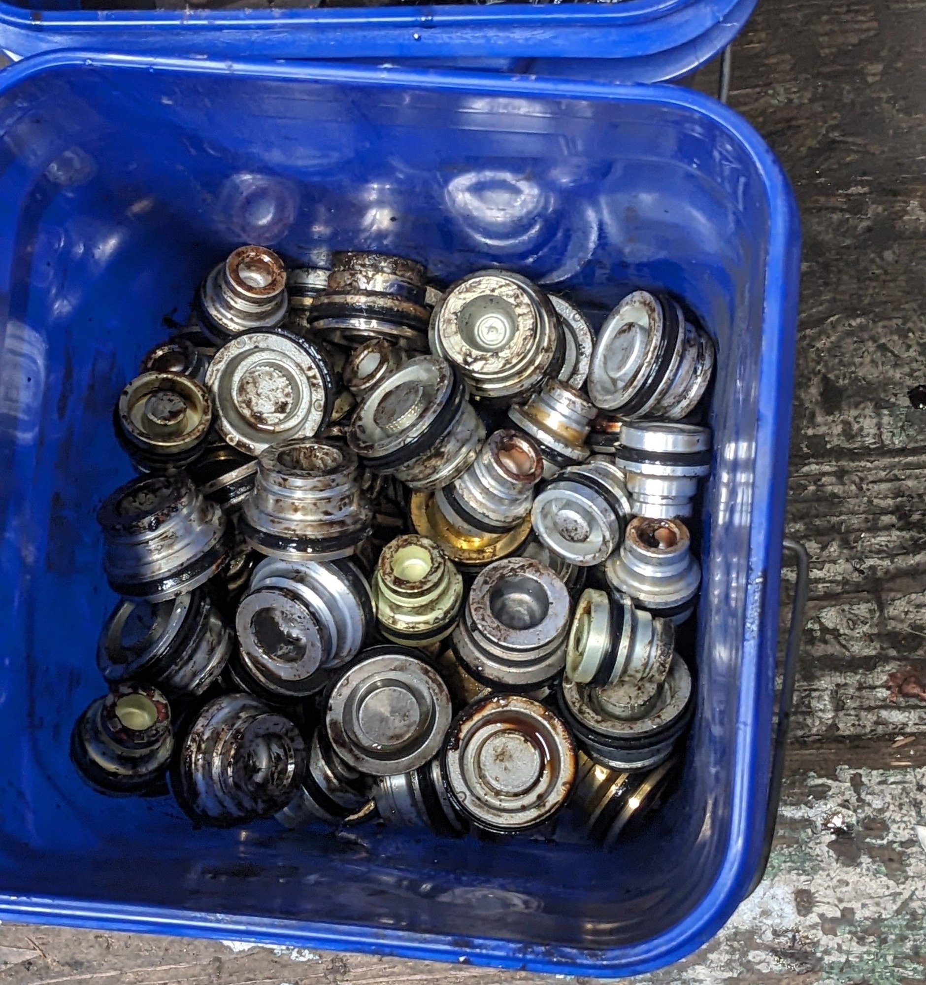

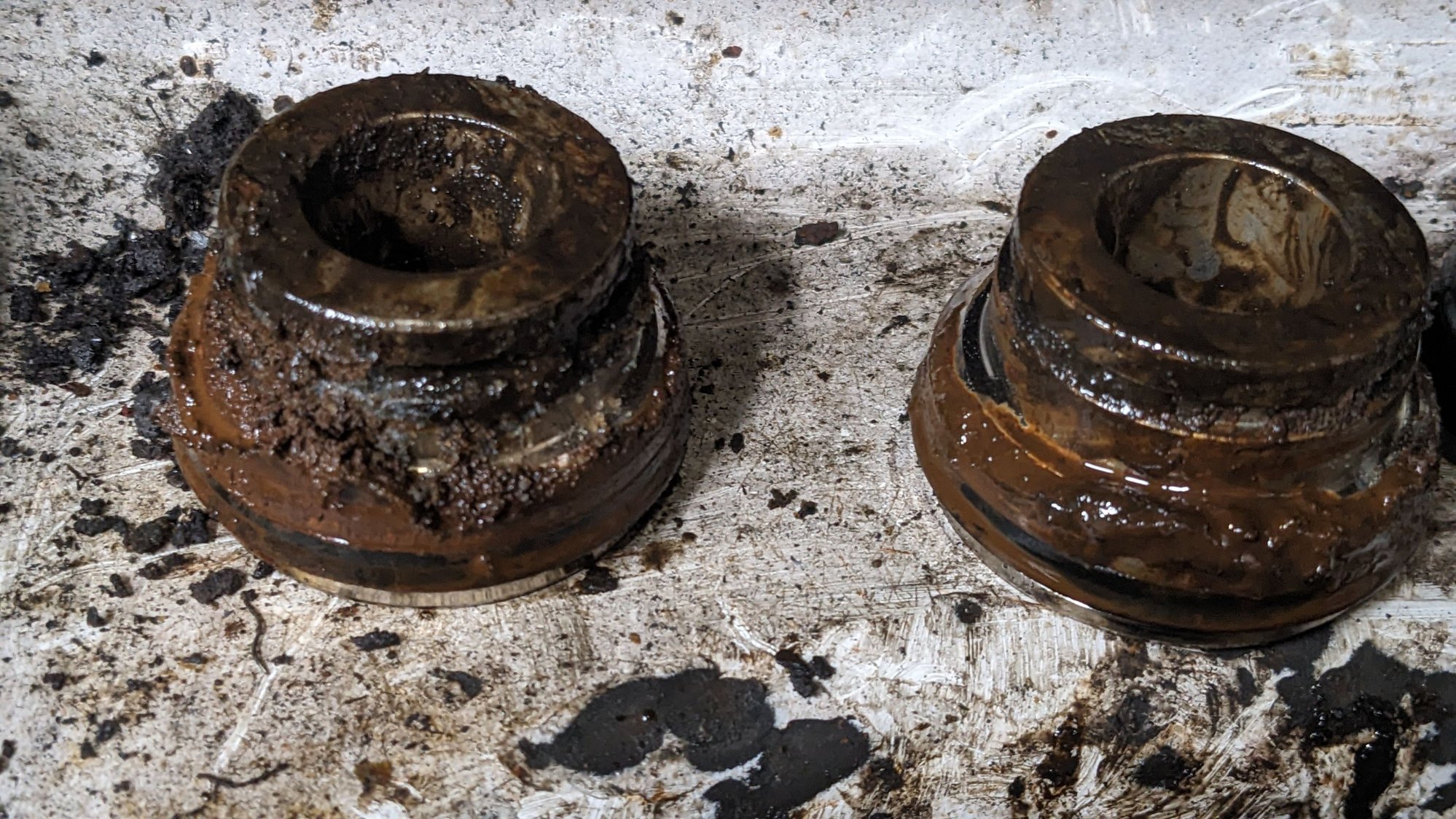

Some of them look like this when you open them up: Water in the brake fluid does this. The air sneaks past the caliper seals, and the brake fluid absorbs the water like a magnet. Very frequently there is brake fluid past the dust seal, but outside of the caliper seal, where it should not be. This means the caliper seals are leaking ever so slightly. Even if you do not see it on the ground, yet. But apparently it is enough to let some moist humid air come in contact with the brake fluid.
This pair is obviously particularly bad. This set had to be pried out. Even the aluminum eventually corrodes. But the red goo is iron rust, from the iron calipers. Even when the bores are SS sleeved, there is still plenty of iron exposed to the brake fluid. So any moisture becomes a problem.
But once the deposits build up thick enough, the piston will **** and jam, as seen by the witness mark here. And the deposits did not look too bad even, in this set. Note that this is a S.S. sleeved caliper, so the sleeves do not prevent this corrosion.
I can not tell you how long it would take for moisture to sneak past the caliper seals, but it tends to happen faster the longer the car sits, and the seals are not exercised, so then they relax and leak. When the car and brakes are excercised at least monthly, there is a lot less trouble with these seals.
This simple couple dollar conductivity tester checks for water in your brake fluid. Every mechanic should have one. Normally I use it to check the master cylinder reservoir. But C3 calipers leak thru their seals, so I would squirt a little fluid out and check that, and see if it is time to flush. It measures 0 to 4% water with four lights.
All leaking, all had deposits.
A few months worth of cores. All leaking. And at least 80% of them had SS sleeves.
Keep that fluid clean!
