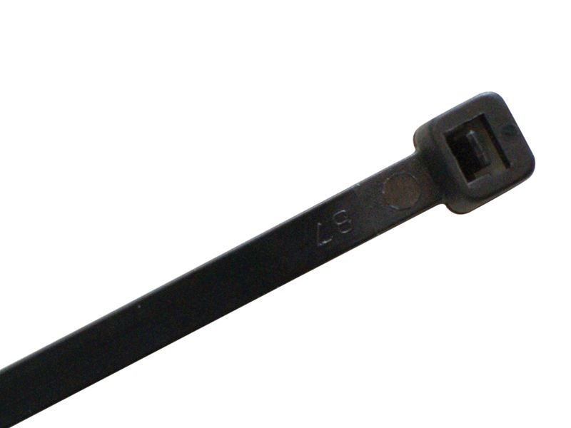

Back in the day when my car saw a 1/4mile at the time-
Disconnect at the intake manifold- as to stop ANY vacuum leaks in the system ( hoses/tank/actuators/valves)
and
THIS- around the linkage

Well, that looks like a time efficient method. I've got some of those heavy duty ties on hand.
I'm also blocking off more of the air entering the grills. I don't have much overheating issues, and I'm constantly trying to reduce the amount of air entering the engine compartment and getting under the car. It ought to reduce the amount of air trying to lift the headlights as well.
