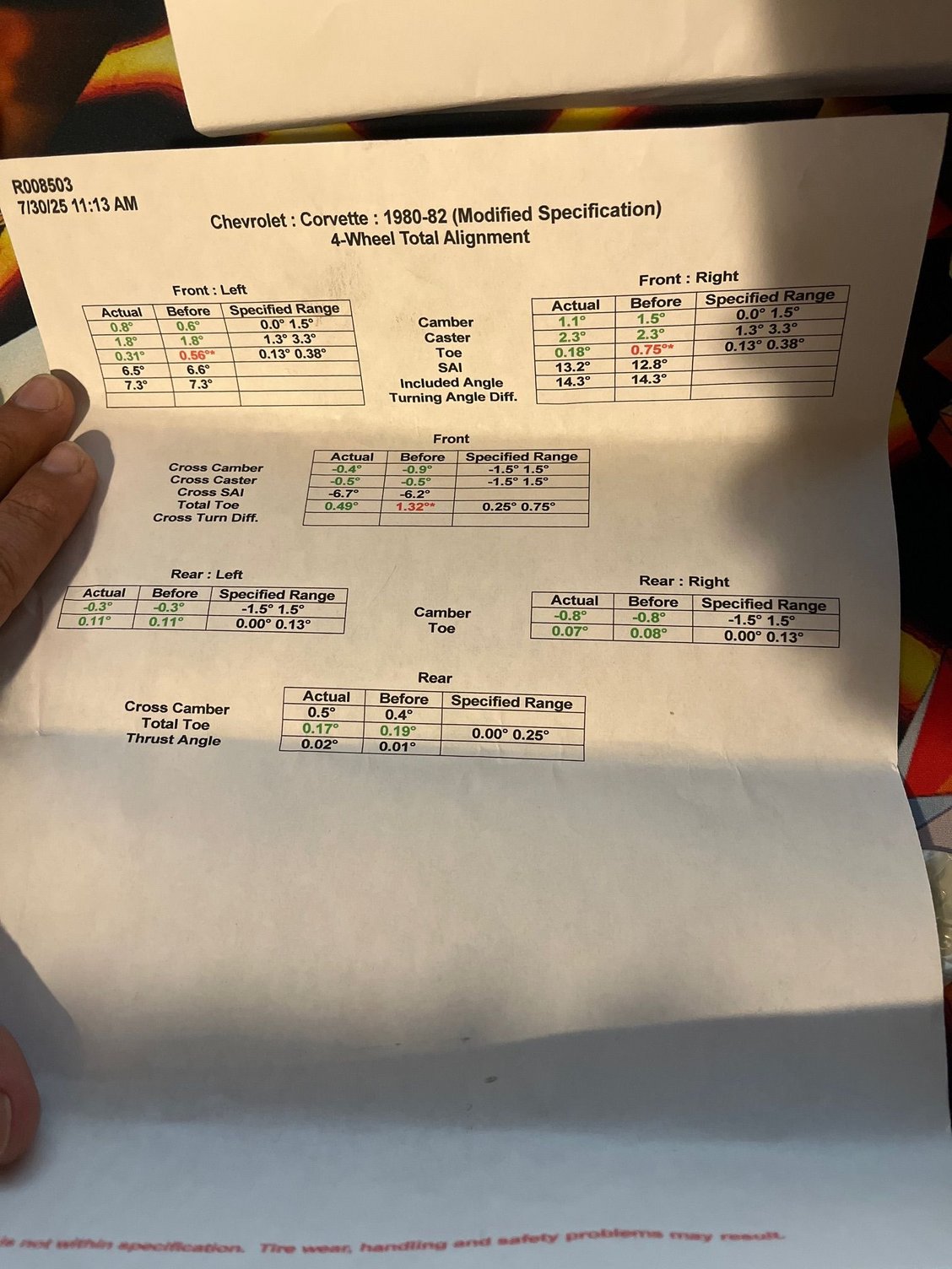

It has also come to my attention that I have the older spec sheet from my regular tech; it is listed as 1981 at the top and the rear specs and front specs have a totally different specified range.
On the older sheet it is listed as -0.5 to 0.5 degrees cross camber and caster and the new one says -1.5 to 1.5 degrees cross camber/caster.
The rear says -1.5 to 1.5 but the old also says -0.5 to 0.5 degrees.

On your posted alignment sheet, I see several issues.
I am not an alignment tech, I was a physics teacher and near national level race car driver and suspension designer with 30 years of racing, testing, modifying, and driving.
Most of the "suggested alignment specs" for our old C3s are not correct.
Even the ones built-in to the alignment machines.
Even the old GM ones were based on bias ply tires and are totally not appropriate for radial tires.
I ABSOLUTELY DISAGREE with the "suggested spec" above that zero rear toe-in is acceptable.
IT IS NOT.
These cars need a MINIMUM of 1/8" rear toe-in to not feel squirmy. (0.3 degrees the way the machines measure them today).
Their "suggested range" does not even go high enough! LOL
This car's IRS has a lot of rear toe-in change, aka bump-steer, and the rear toe is necessary to compensate for that.

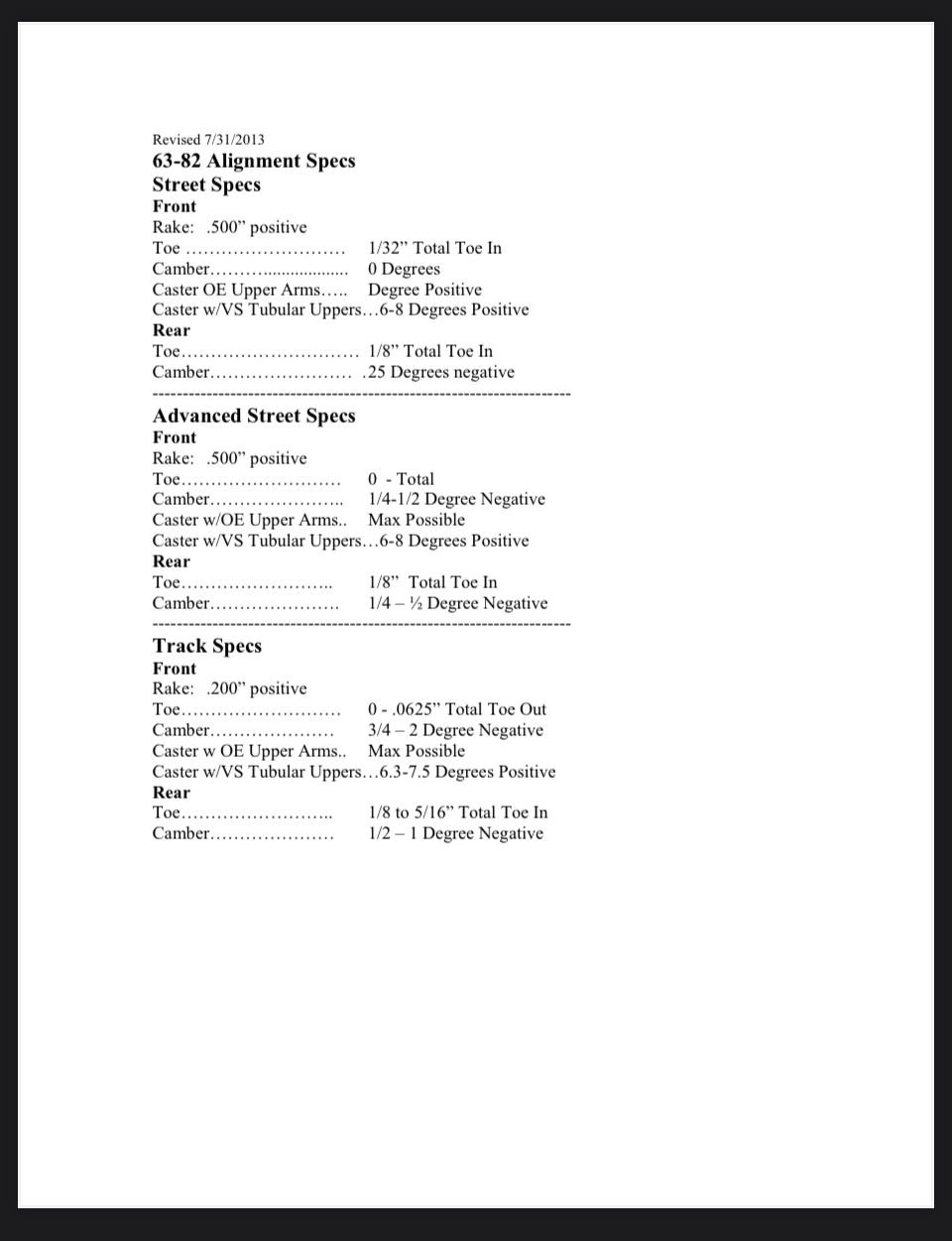

IIWY I would hand the alignment guy these alignment specs from Van Steel.
They have been building, racing, and making parts for C3s for like 50 years.
They know what they are doing.
If they will not align the car to your specs, find another shop.
I have experimented with my alignment and found those specs work very well, I agree with them 100%.
Either street or advanced street is suitable for a cruiser, most would not notice the difference.
The #1 spec to meet, and the one that is the most unusual, is the 1/8" rear toe-in.
The rest is more normal.
But as a 30 year race car driver, I absolutely can not stand any spec that varies from right to left. Caster or Camber. It just ain't that hard! Staggered Caster or Camber setting will make the car pull left or right.
And you have both, in the Fr & Rr.
