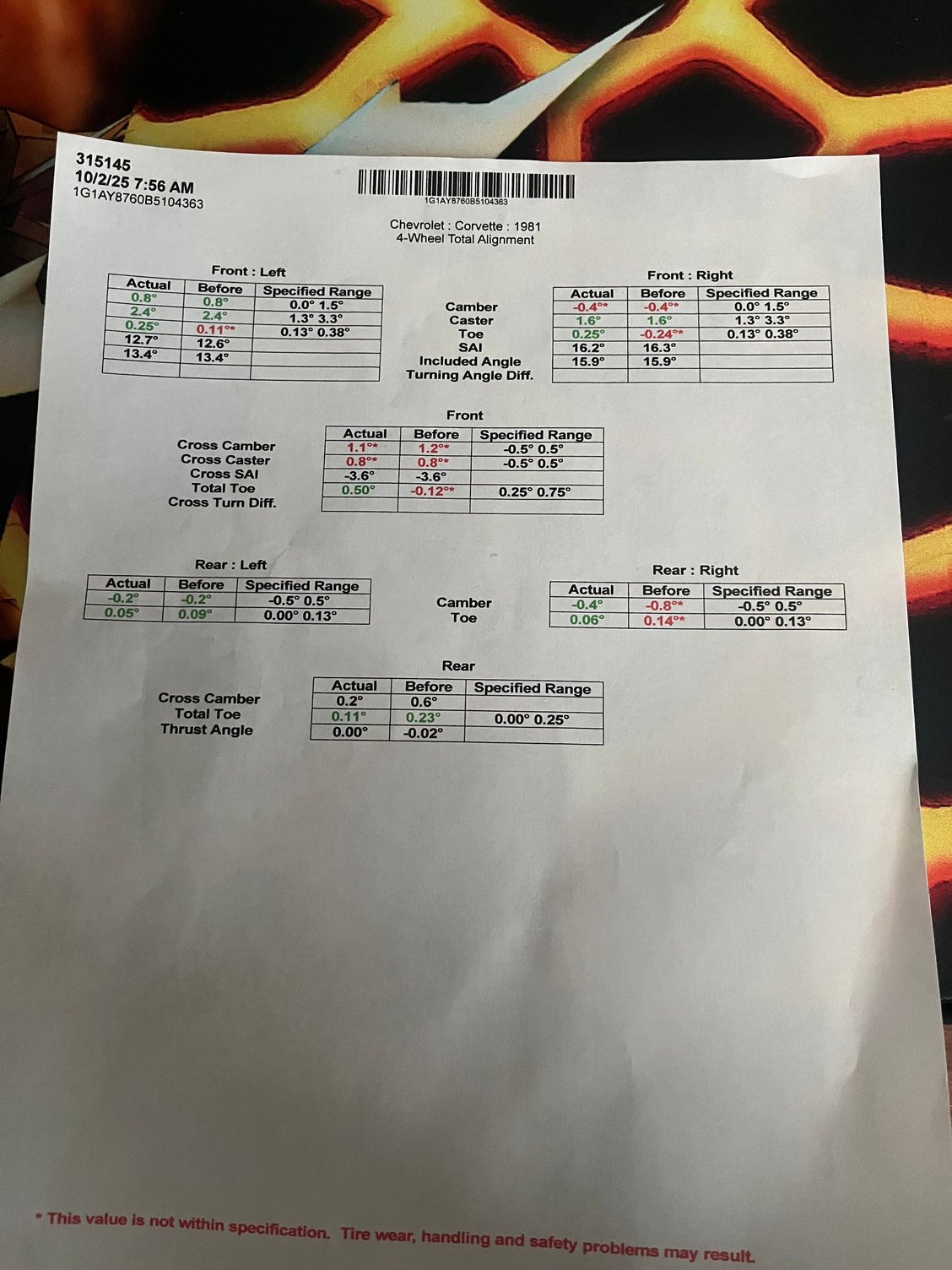

Okay everybody today keeps getting fun. I had a conversation with the service writer over the phone and she thought the car was 4WD so I could already tell what was going to happen.
I spoke to a different service writer about the problems I saw, within one hour he said the different "master tech" finished the alignment. I was told that shims were missing from the front top right control arm (and they were...when he was done they were so loose I pulled them out with my fingers...) and that the drifting was from road crowning. I asked him how he did the alignment without using the proper shims and he told me "We don't carry shims, and its an additional $60 to install them." (I had my own pack of Dorman shims and they refused to use them unless I paid them.) I explained the issue again and told him he was not going to charge me labor for shims on a lifetime alignment but he clearly didn't care even though they screwed it up. So this is the sheet I was left with.
After inspecting it myself, he did tighten the sleeve jam nuts on the rear. The trailing arm shims are still slightly loose on the passenger side but tighter than before, and I took the stack of shims out of the top of the control arm closest to the A/C compressor because they were going to fall out while driving anyways. Its very difficult to find anyone to touch the alignment on my car in my area and judging by this sheet I will assume the problem will persist.
Side note; I did provide them with the Van Steel alignment specs from this post and asked the tech about it and he told me "Those are unverified specs I can't do those."
