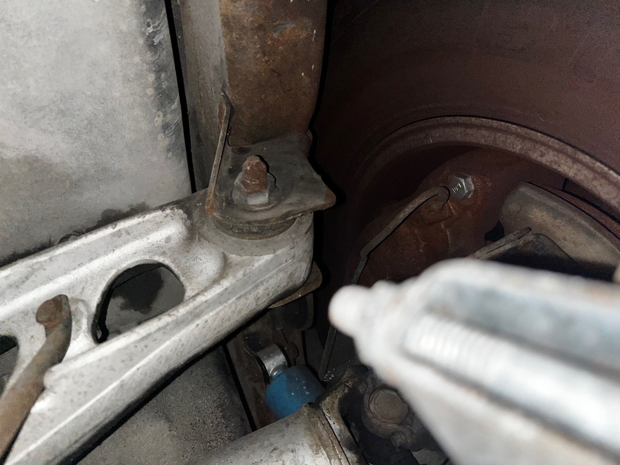

Ok so I squeezed under the car to take a look to see if this is affecting the current drifting issue.
The differential carrier bushings are completely shot, definitely need to be replaced and its leaking badly from both yoke seals. (When I replaced the U-Joints I did not notice it leaking so it must have started in the past year. Yet I have nothing dripping in the driveway and I have never taken out a yoke so my experience with that is zip.) Both trailing arm bushings didn't look great, pretty flat and rock solid. I looked at the shims and as you can see in the pictures; they look pretty old. I'm guessing a pretty safe bet is to start with those bushings but it looks to be quite the bugger to get them out.
So yes you are absolutely correct, turns out I missed quite a few bushings on the rear....

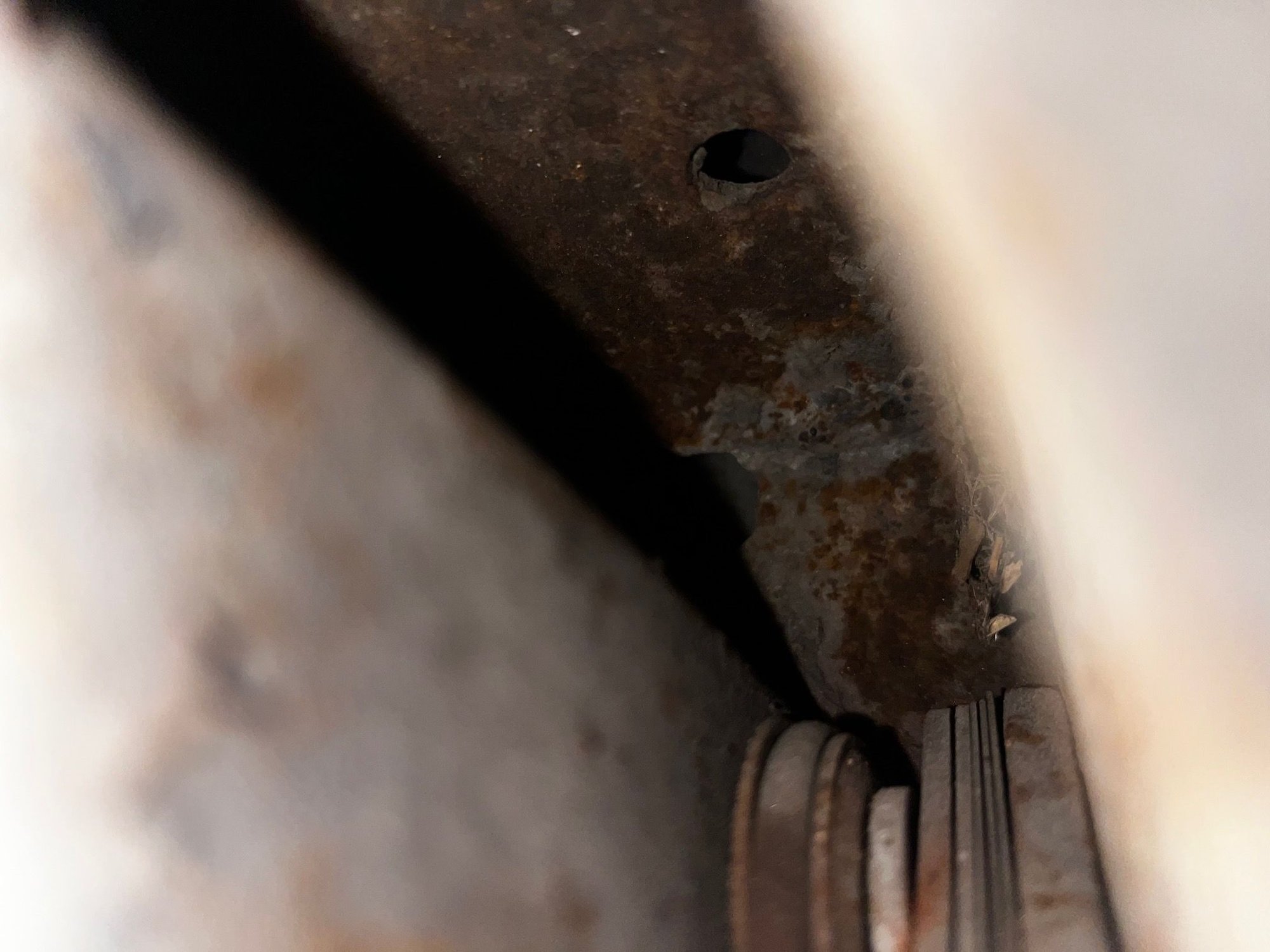

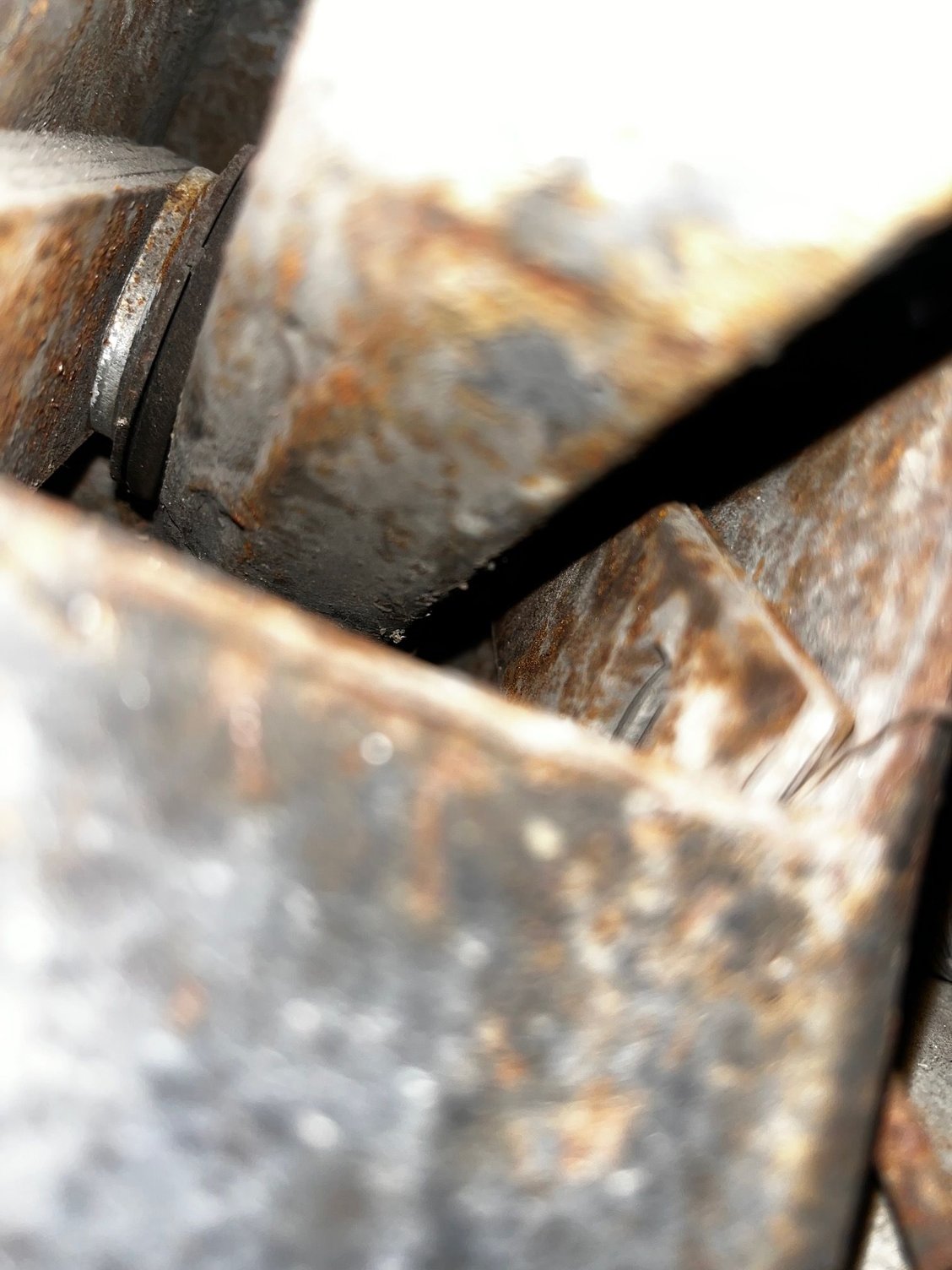

Originally Posted by RonnieJamesDio
Can you move the shims in the pic by hand without loosening the bolt? They don't look like they are tight to each other -- but should be.
Old Sep 28, 2025 | 01:30 PM
  #37
leigh1322's Avatar
leigh1322
Old Pro Solo Guy
Posts: 8,082
Likes: 4,431
From: Marlton NJ
The way to check the integrity of those trailing arm bushings is to stick a crowbar in there near the bushing.
See if you can pry the trailing arm up, or side to side, or if any crumbly bushing parts fall out.
Any of those would be bad.
1/16" of an inch is one thing, that might be bushing flex, more than that is a fail.
But I think I too see an air gap in the shims. Best to check that.
Is the big cotter pin in there that holds the shims in?
If that is missing, I have seen shims fall out.
The shims should be very snug. So much so that the last one needs to be tapped in. No slop at all.

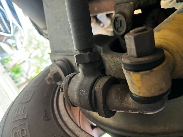

Ok I put the car up on jacks and this is what I found.
The adjustable strut rods have a nut completely loose on both sides, driver side bottom and passenger top. The lower nut on the driver side is actually in the middle of the threads as pictured. The shims on the passenger side trailing arm I can actually wiggle and move up with my index finger so there is somewhat of a gap, but the pin is there. Driver side shims are tight and don't budge either and the pin is also on that one.

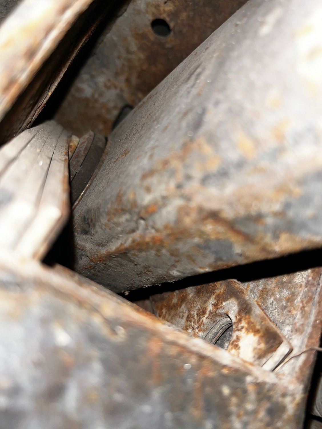

You shouldn't be able to move them with just a finger, they should be tight with no space to allow that kind of movement. What's happening is that the forward end of the arm is moving left and right which is pivoting on the strut rod and half-shaft and changing the tire tracking on that side. In other words, you're not only steering with the two front wheels but have an additional non-controllable steering wheel in the rear.
