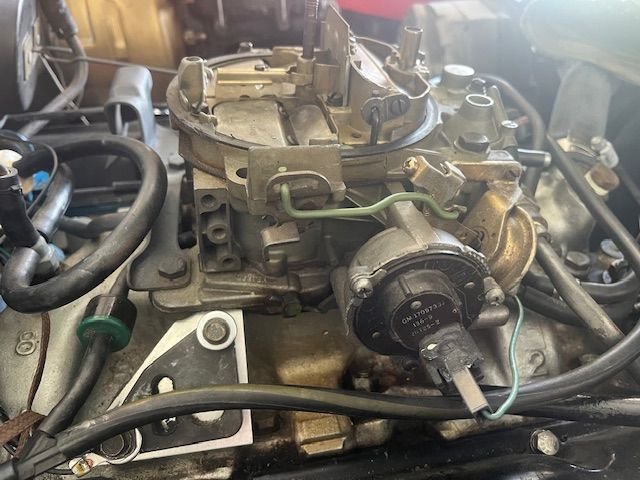

So I'm trying to figure out the non functioning Tach due to the MSD install and I try to start car and it won't start. Ran great yesterday. I smell fuel and notice a large puddle of fuel that came out of accelerator pump or somewhere and leaked down the side of intake on driver's side. All the spark plugs are soaked with fuel. It still has spark so that didn't fail.
So I assume the carb is flooding the plugs and I need Lars to rebuild it? Are the spark plugs done or can I dry them out?

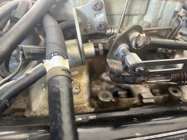

Factory Q-Jet, 1980 L82. I cleaned it up but the pocket there on the intake was puddled with fuel where it says #3 .Opposite side passenger side is dry

A thorough cleaning and rebuild with new gaskets could never hurt, but I would try running the car with the air cleaner off and find exactly where it’s leaking from first.

Car won't start now. Plugs are soaked with fuel instantly. I thought maybe the new MSD box was failing but it has good spark. After thinking about it, this could have been a fire on the road. God must be looking out for me.

So I removed the plugs, blew off the fuel and let them set over night. I also poured some oil onto the top of accelerator pump and let that sit overnight. I saw fuel coming out of it so I assume the seal is dried out but it runs good now and no flooding or fuel squirting out but the carb needs a rebuild. Thanks for advice.
