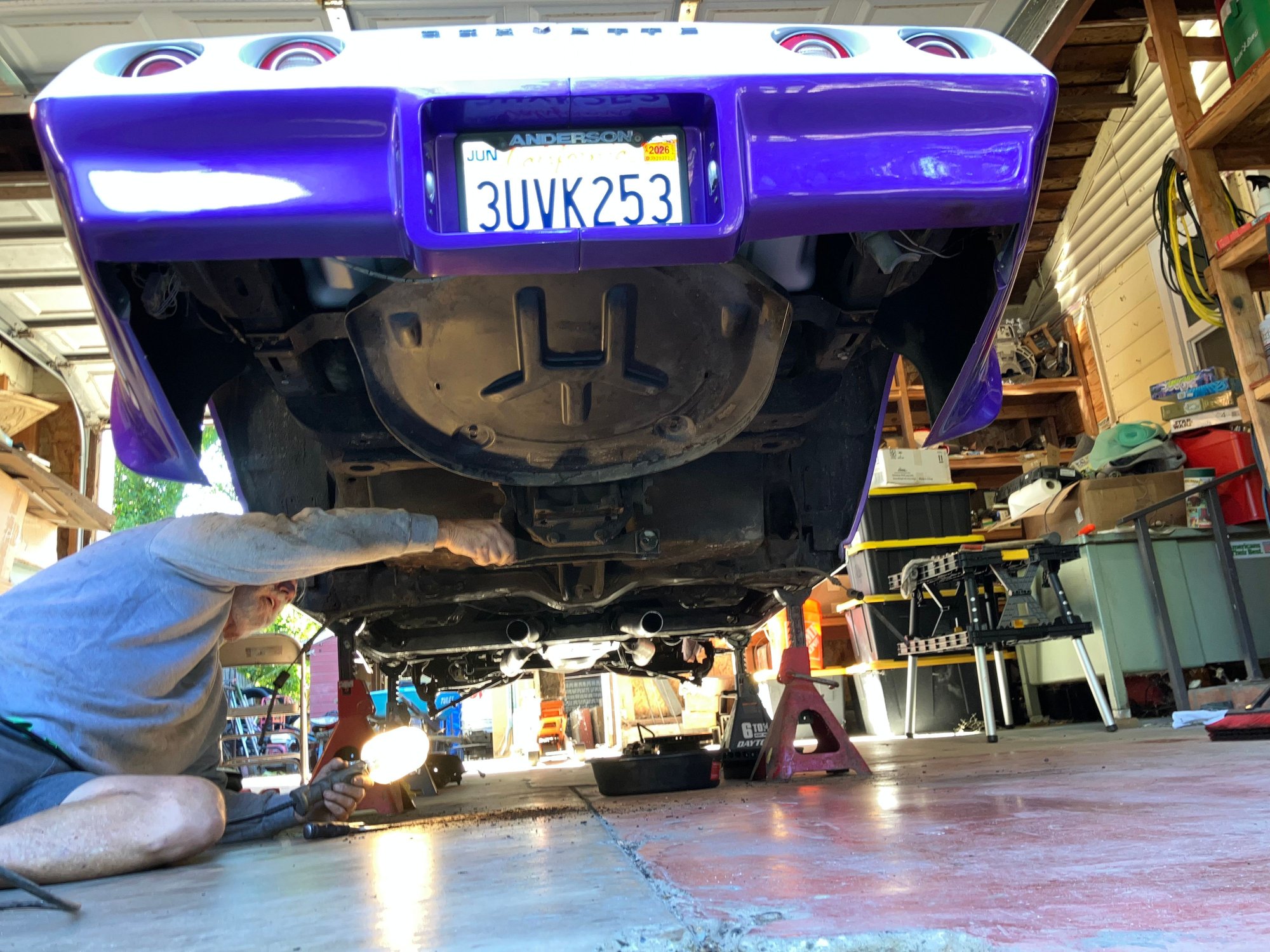

Hello!
I’m replacing all suspension bushings and shocks on my ‘73, rear shocks were dead, getting leaf spring re-arched, replacing the rubber between the leaves, new trailing arm assemblies, half shaft U-joints, etc.
Figure while it is in the air, might as well do the body mounts.
I saw some silicone mounts advertised, but really just want this car to be pretty much stock and smooth a ride as possible. I’m not racing and don’t want to spend what it would take to make this model of Vette handle better. I’ve always loved the body design of these cars and just plan to cruise around in it.
Any recommendations on body mount bushings/suppliers?
