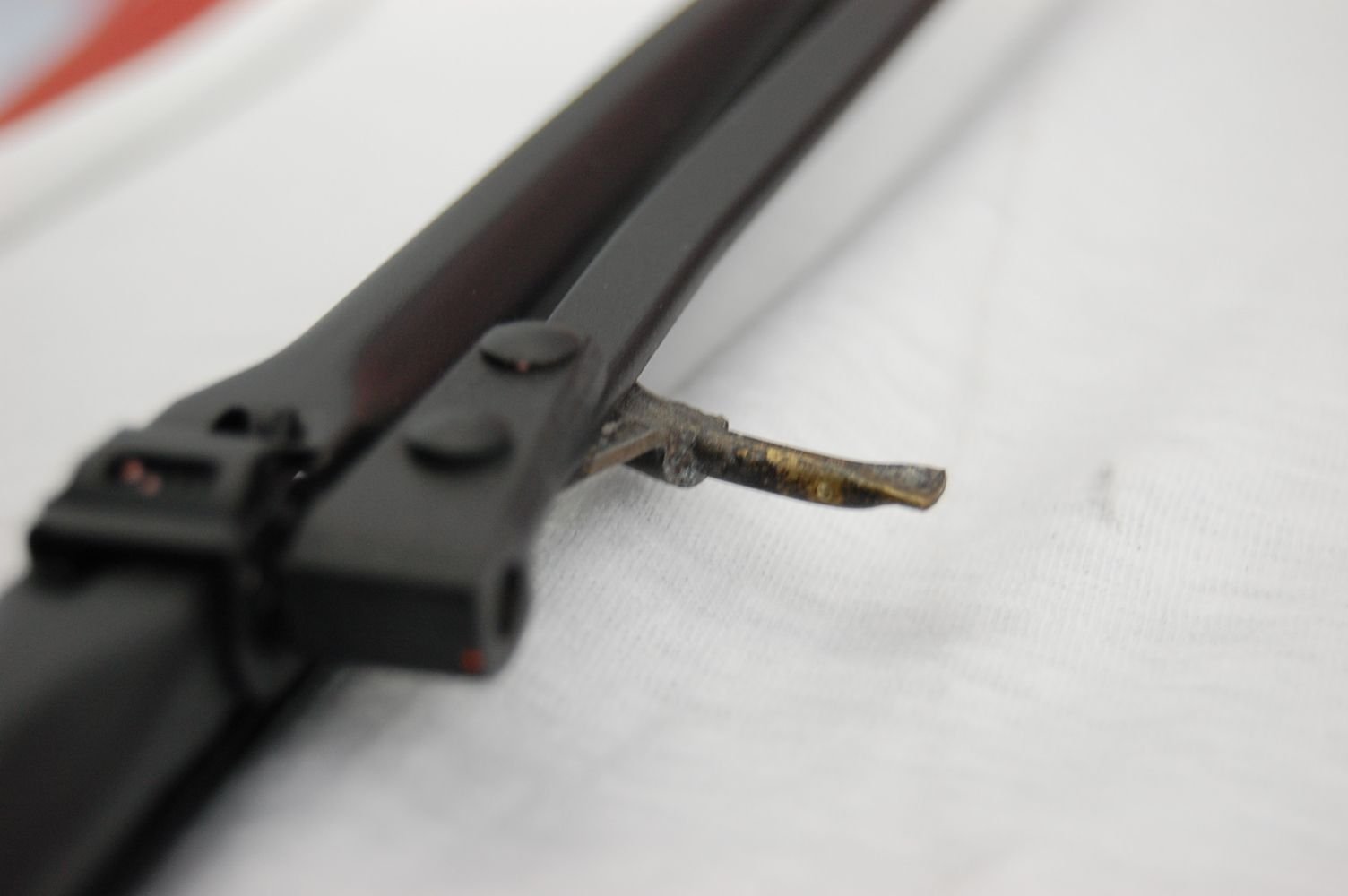

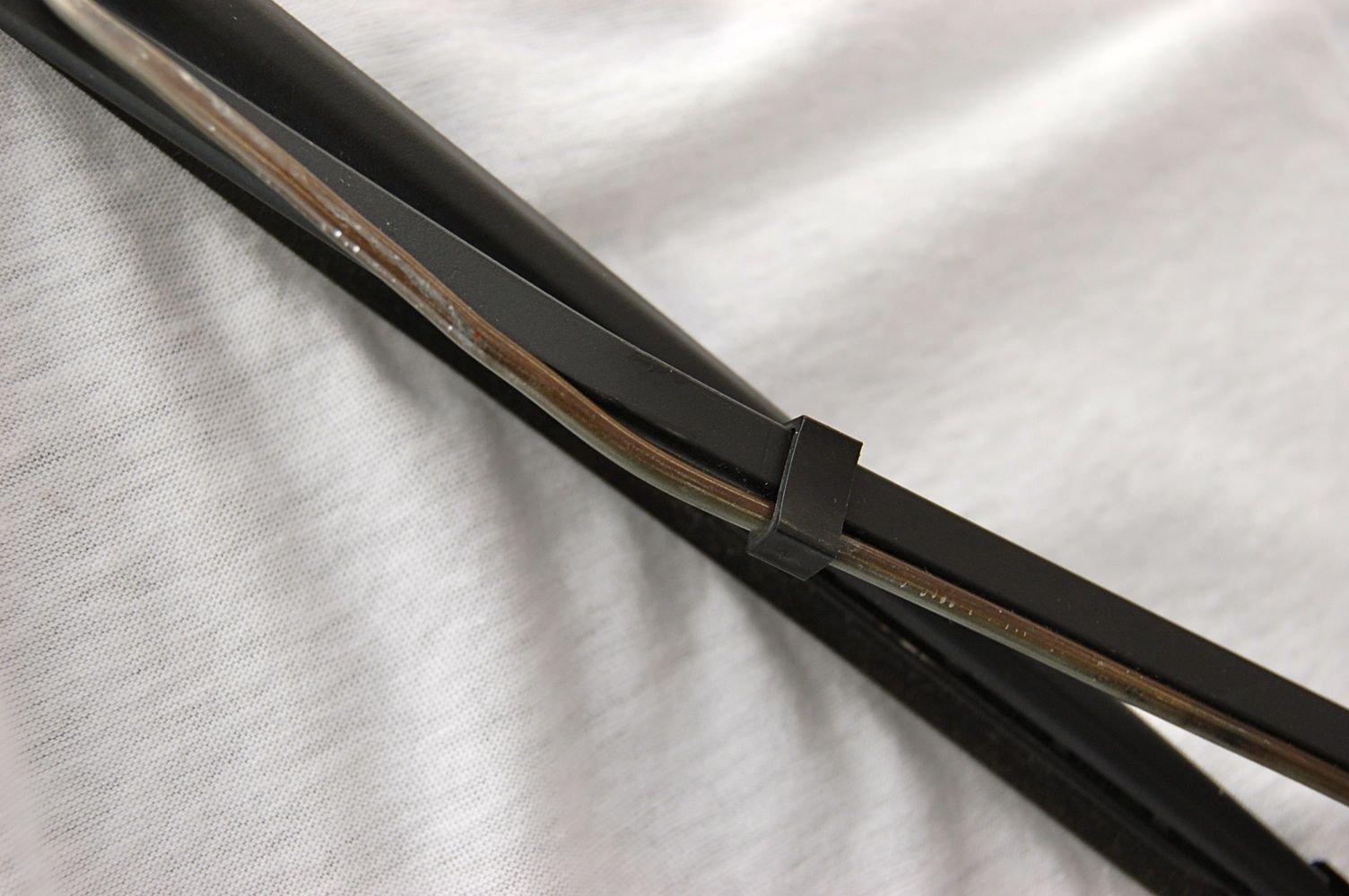

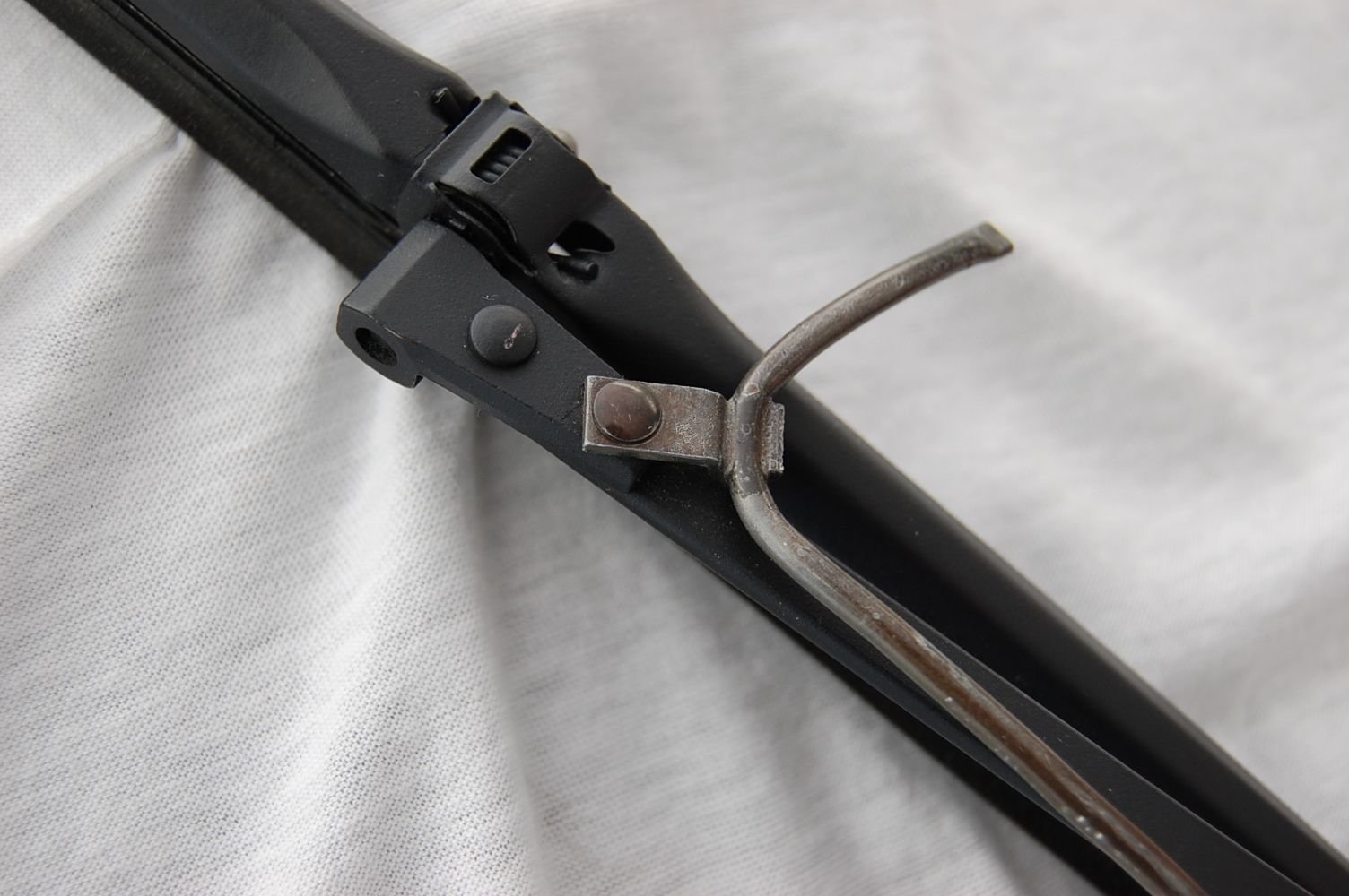

Very early cars (68 until ?) had the nozzles mounted in the cowl grill. Rubber hoses ran to them.
By 70 (maybe 69) there were long copper tubes with a nozzle attached to the wiper arms by solder/rivits and tiny plastic clips. Hoses ran from the pump to the tubes.
Don't know how long this method remained in production.
Regards....

Was wondering what the heck those were. How does the fluid escape the copper tube? They are pinched at the end.
Old Oct 27, 2025 | 09:40 AM
MelWff's Avatar
MelWff
Posts: 18,620
Likes: 2,553
There is a small hole. Start at the pump head and remove one of the small hoses that run to the arm and see if water squirts out when you activate the wipers. Wet the windshield first to prevent scratches on a dry windshield.
