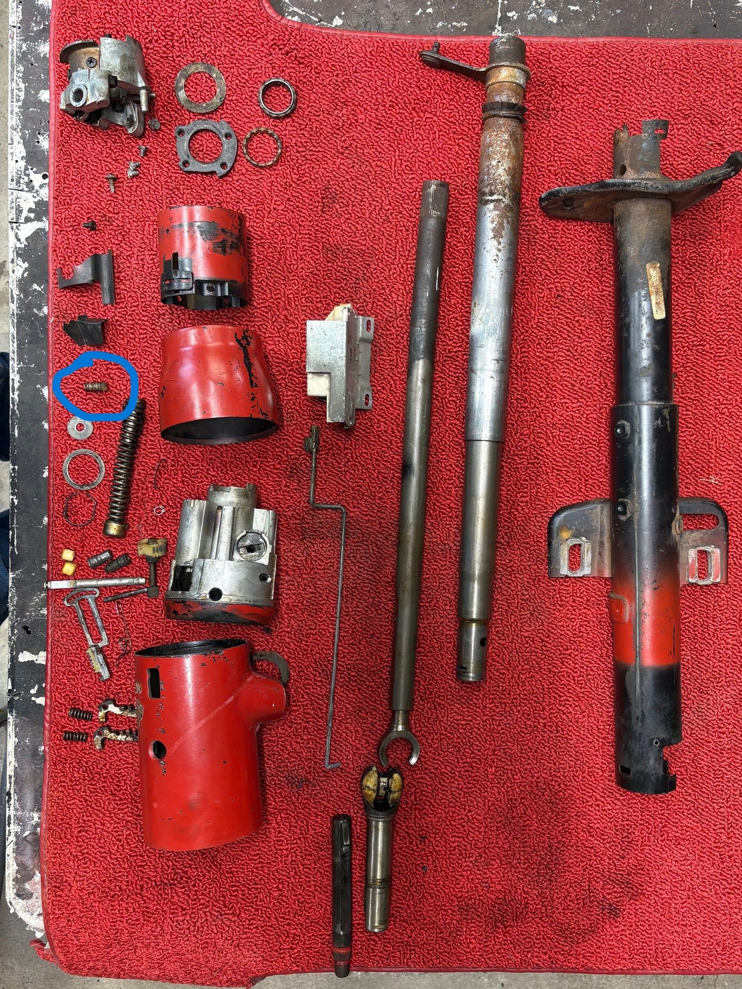

Default Steering Column Help

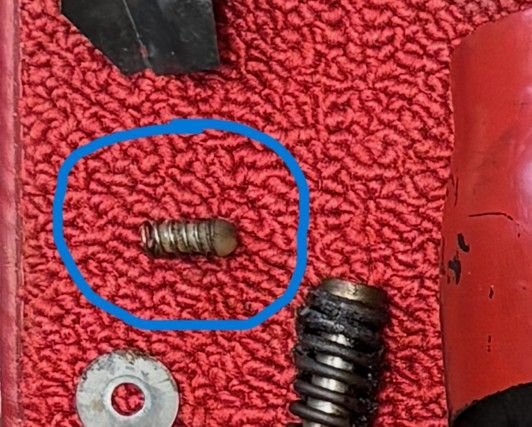

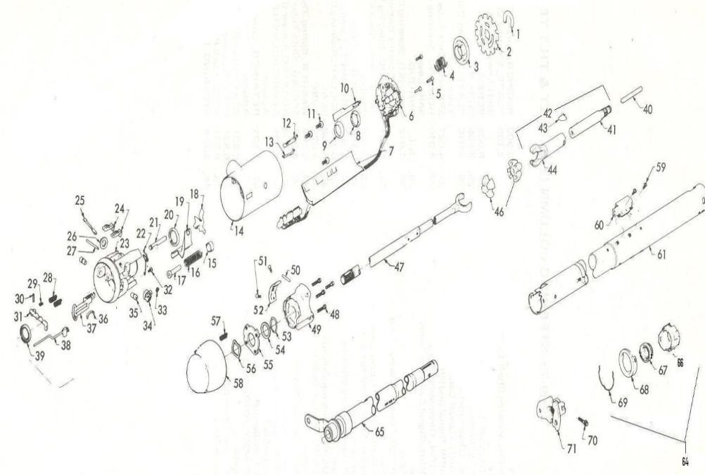

Calling on steering column guru's. I found a donor column for my early 69 to harvest the lower shaft from because mine was bent. I have taken ton's of pictures on disassembly and there is always one part that falls out before you can document it. I need to know what this is and where it goes see circled in BLUE. It's a white nylon pin with a spring around it. I cant find it on the exploded diagram.

I have Jim Shea's papers laying around on my hard drive somewhere. I'll look and send them to you. I have the parts book and maintenance procedures. Hopefully it will show you what you're looking for. I am going on vacation for a week starting Wednesday so I'll try to find them before then but no promises. Maybe PM Jim

I have the Jim Shea papers and went through them and I'm still stumped. Thank you.

That goes in your shift bowl. If you look down from the top into the bowl, you will see the hole where it goes. Just use some grease on it to hold it in when you reassemble. I marked the shift bowl in yellow in your picture. That is one of the rare early 69 columns with the longer exposed shift bowl. I have a couple here I redid. Very nice! I know these columns inside and out and am not far from you here in Glen Cove. Let me know if you need any help.

Bill thank you very much for the answer. This column has been a bit of a mystery because it doesn’t match a lot of the diagrams. The car is an early September 68 build. A lot of weird little things.

So is that #17 fitted into #16 in the parts drawing?

nope that’s the big spring for the tilt mechanism. It was exactly like 69ttop502 described. It went into the bottom of the shift bowl.
