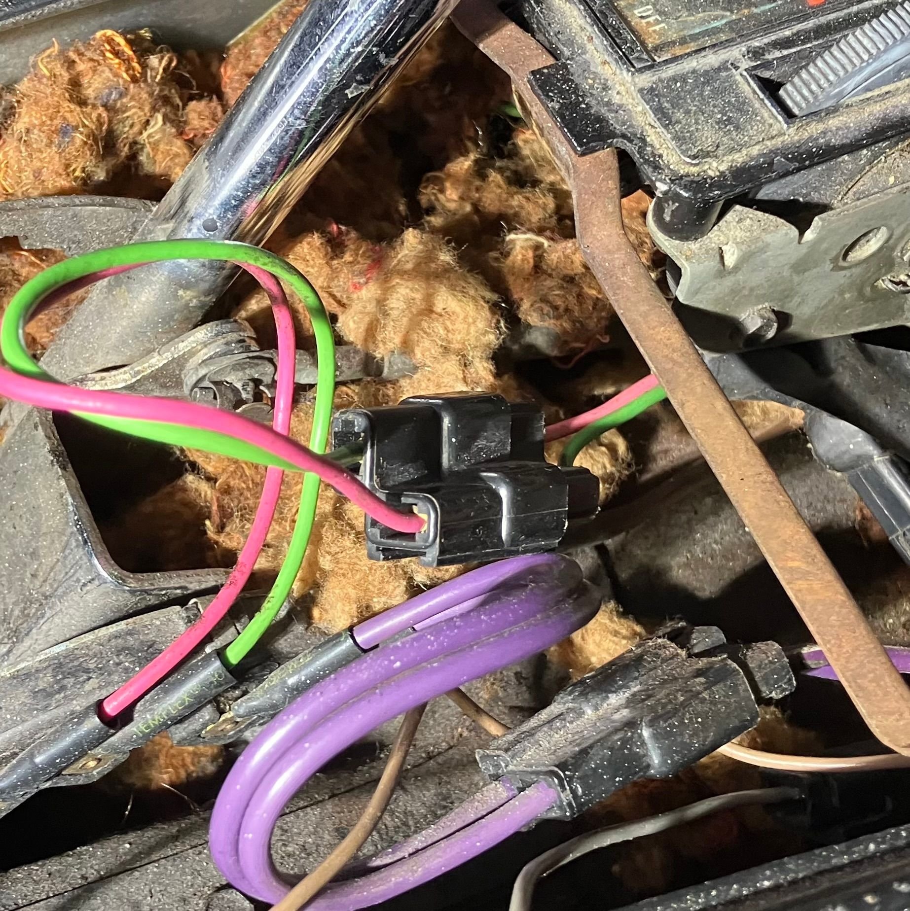

Hi guys, a silly question from someone new to C3s. It appears my neutral safety switch has gone bad (72, auto) and I am trying to replace it, but what I thought was a wire connector appears to just be one solid piece of plastic, no tabs or anything to separate the 2 ends. Am I missing something?

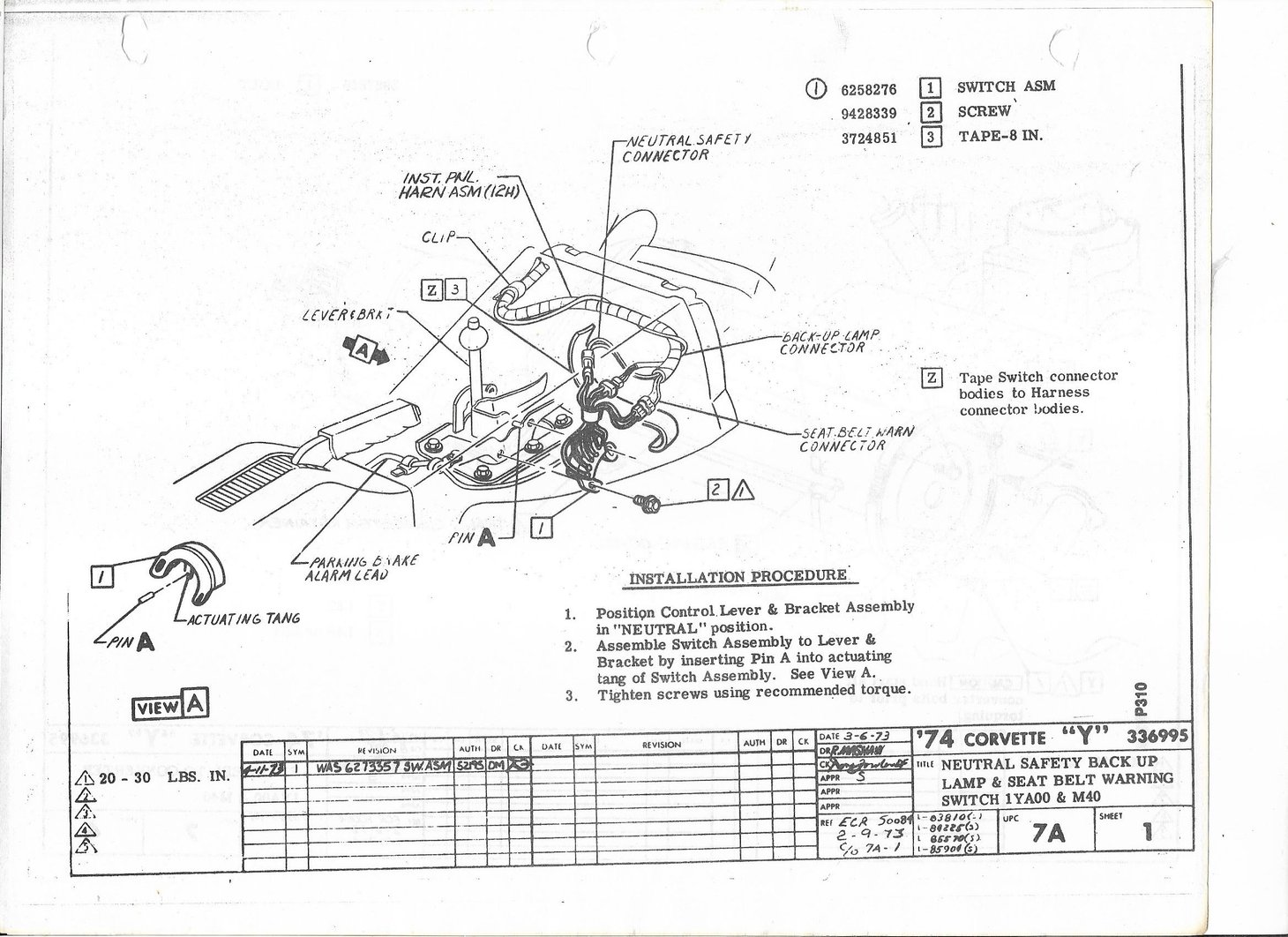

Default Does this help?

Thank you, this looks like it will be very helpful as I dig into this. But I am stuck at step 1, I can't figure out how to undo that connector.

LT1impala
Here is a picture of mine.
They just pull apart.
Hope it helps.
https://www.corvetteforum.com/forums...post1606580516

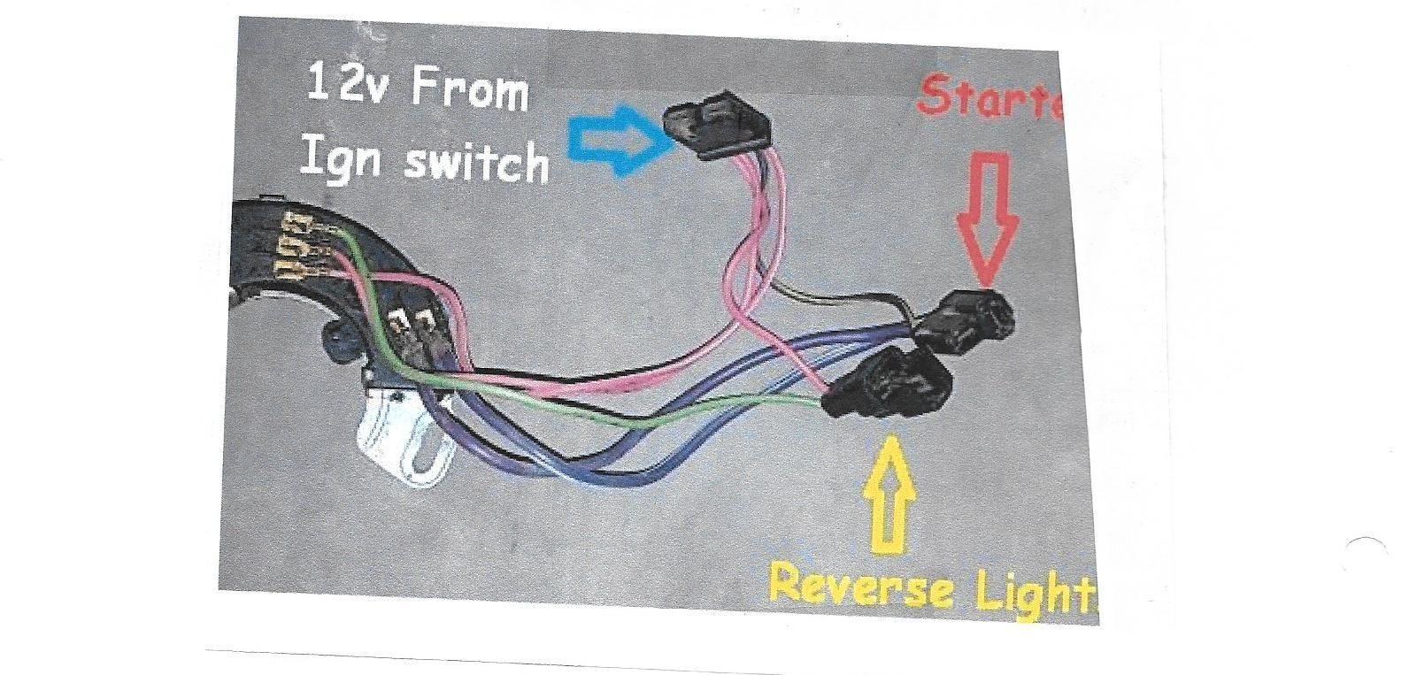

Well my fix lasted about a month, back to not starting plus one reverse light out. I got a new switch thinking the previous replacement may have been defective, but still no go. I tested the wires and found that there is no power at the purple and white. (pink and green have power). This will probably be over my head but just in case, are there any simple or obvious things I should be checking before I give up?
