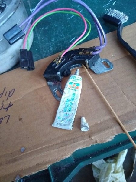

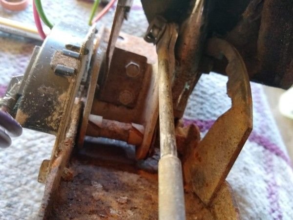

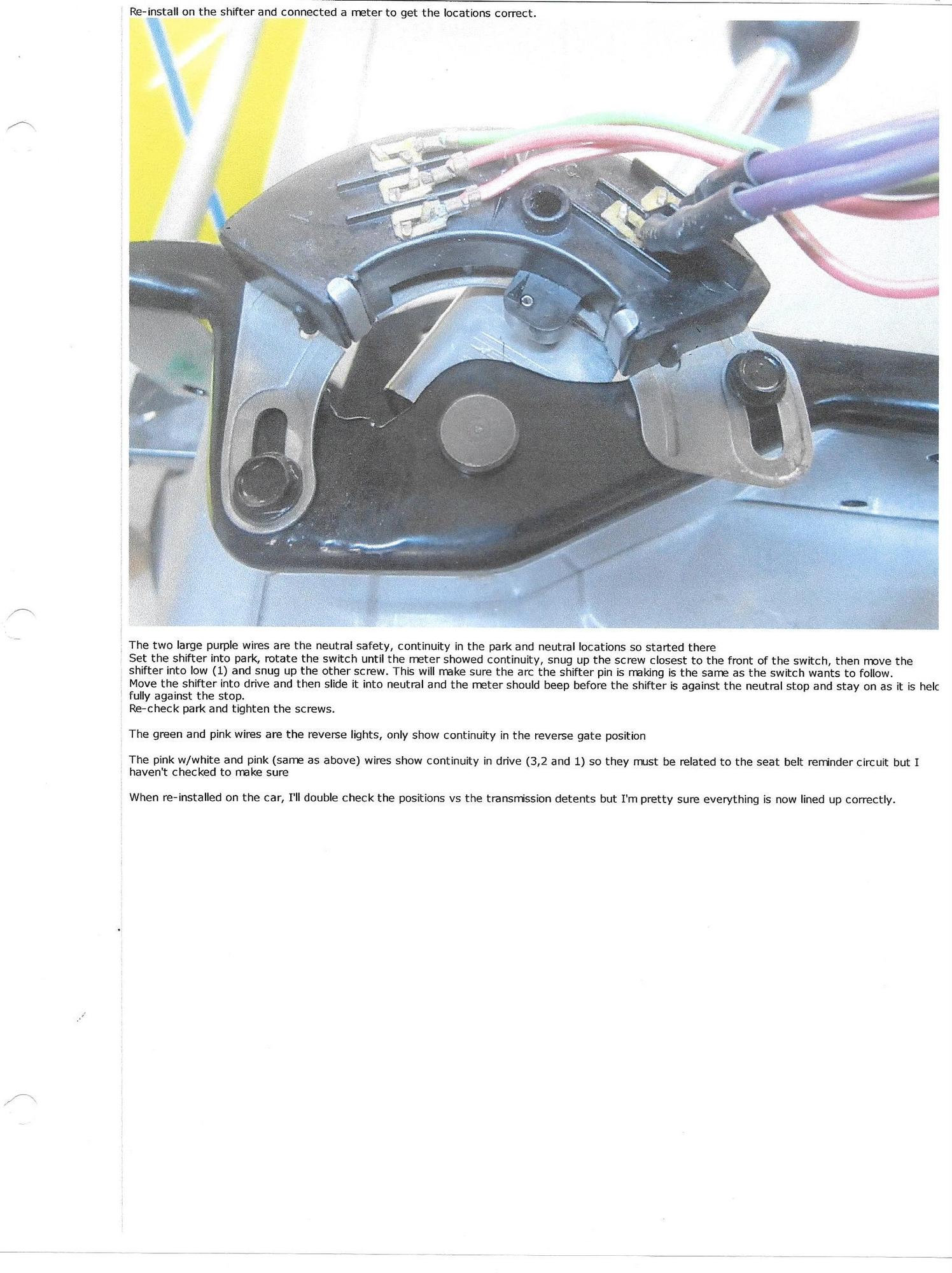

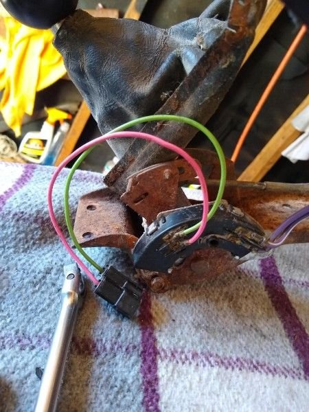

I had Manual for like 38 years and did not have clutch-interlock hooked up from when I bought it.. Wasn't a big deal to me since I grew up with old cars that did not have the interlock for Manuals.
When I put in the 200-4R I recognized that I would need to hook this up. I located the leads where I had stashed them and hooked them up to the Auto Shifter that bought on flea-bay. The contact assembly was a bit grungy when I got it, but I cleaned it up well and put in some dielectric grease..... I was ok with buying a new one but I figured I'd try to get mine to work.....and HOLY COW! It works just fine and the car only starts in Park and in Neutral.
You might try just cleaning and using some dielectric grease in there. Can't really hurt. I'll see if I can find a picture of how rough it looked....
OK, found some pics. If yours isn't as bad as this you can hopefully getting it buffed up.
