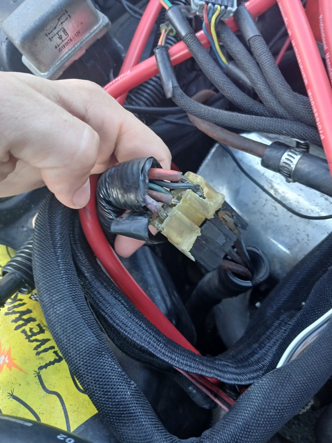

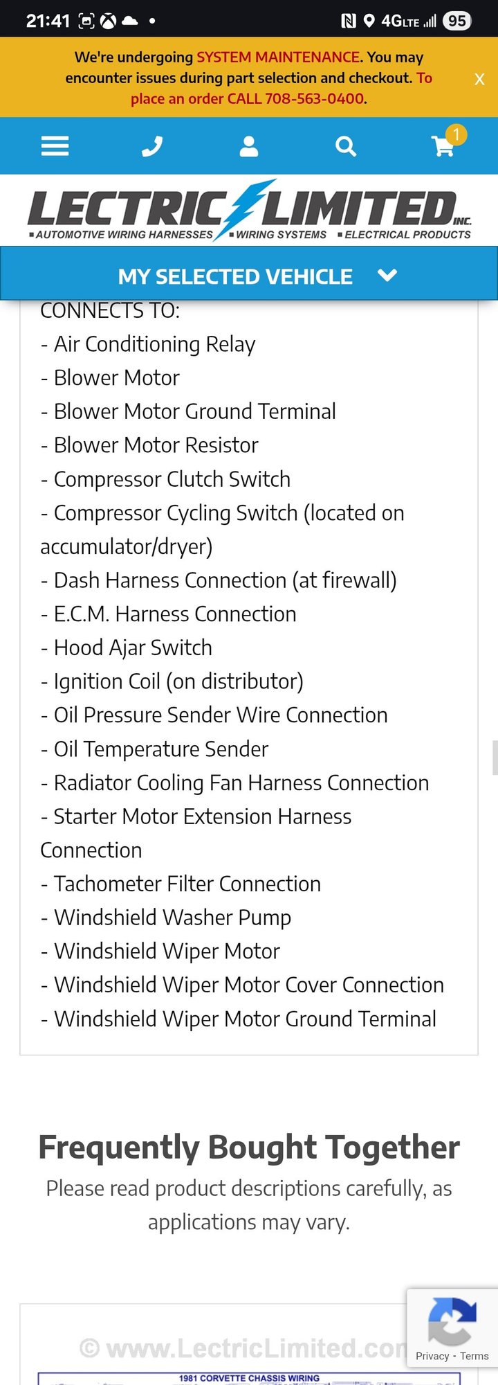

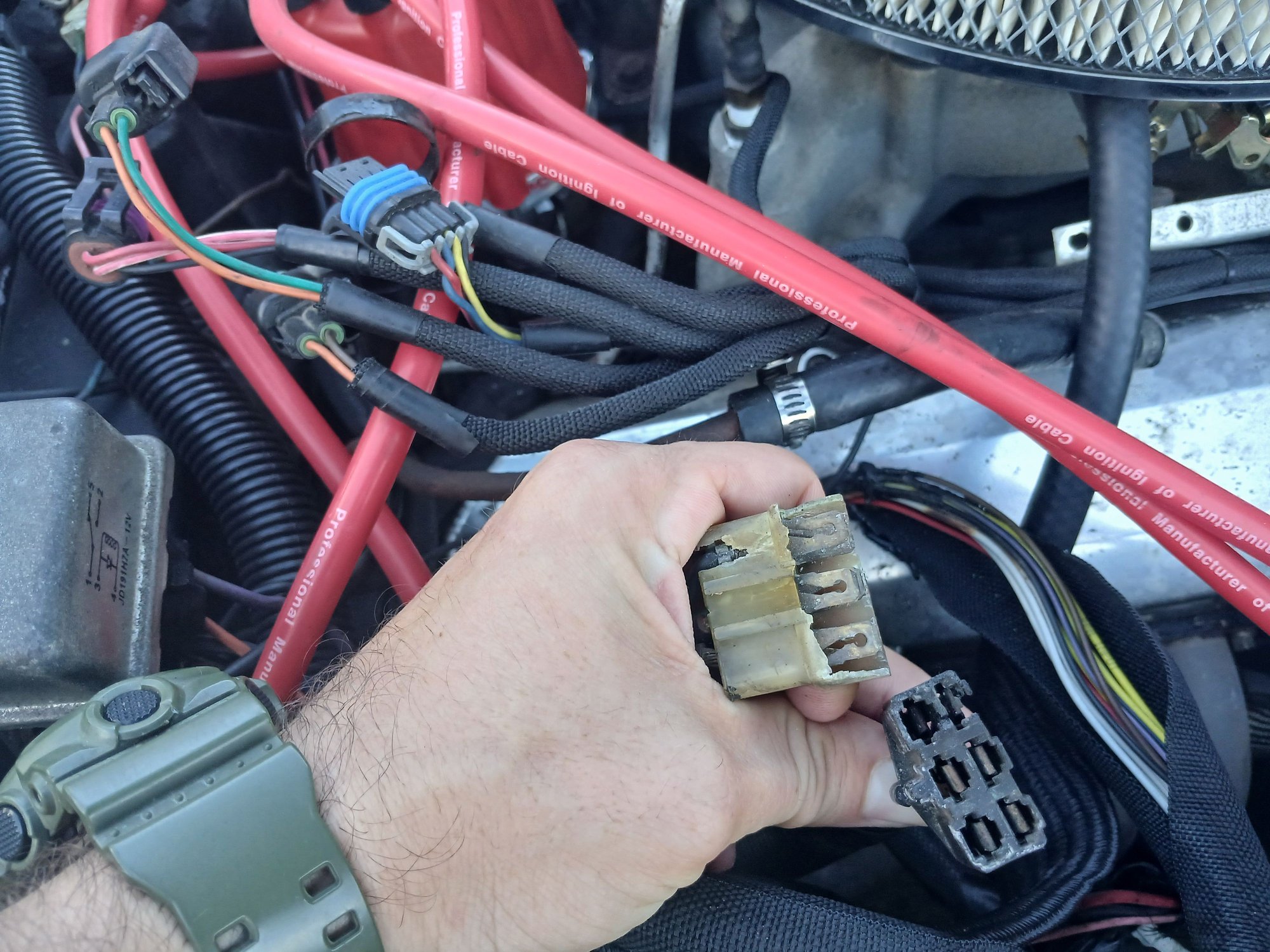

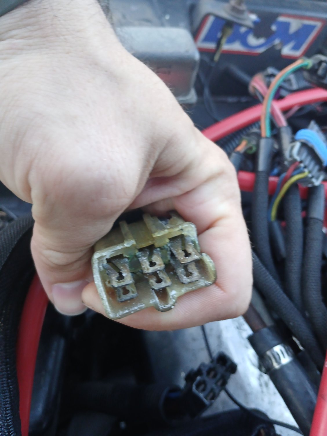

Thinking about replacing this engine wiring harnes. Nothing happens when the key is in acc or trying to start. Even with battery connected. Except when a connection is in a certain position. This includes powering the AC and radio. There's pictures of the current connections and what I am considering buying. Figured this would freshen up the connections. The salty Hawaiian air doesn't help things. This Corvette has been on island since it was made. Would it be worth spending the money to get her running again. Any advice would be appreciated. Thank you for your time.

I can get you the 2 part numbers for those housings. You would need to purchase a quality set of crimpers to install new Male & Female terminals.

I cut those off, trying to directly connect it. Those wires are cut and patched everywhere anyways. That's why I'm asking for replacing the entire thing. If this part is correct and stuff...

You have a few options, each having its own component of time and money.
1). Buy some contact cleaner (like DeOxit) and some tiny stiff brushes and carefully clean all the connectors. For the exposed wire, you can clean and apply a liquid tape.
2). Replace the harness(s).
3). Find some donor harnesses and splice in what you need.

https://www.topflightautomotive.com/...ter-extension/
On an 81, isn't that the "starter Extension Harness?
Top Flight # 29668

Yes, OP will also need the starter extension harness.

I don’t want to add more misery, but have you looked at the harness ( with a large connector) that plugs into the firewall? It has maybe 15 wires and there may be a screw that keeps it from getting unplugged. You may want to get a Chevrolet Service Manual for an 1981, and see where all the connectors are located.

Yes, starting in late 77 GM ended the engine harness at that connector shown in OP photo. It's placement along the firewall and behind the distributor is prone for getting moisture inside...
