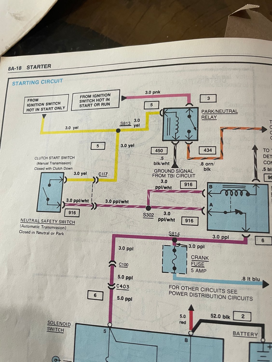

Doing some electrical. Can someone identify this part. Ignition on she clicks like a normal relay. I can’t find it in the books or on line. I’m removing some of the old alarm and trying to identify the tiggers. T tops,doors ,lights exc!!!

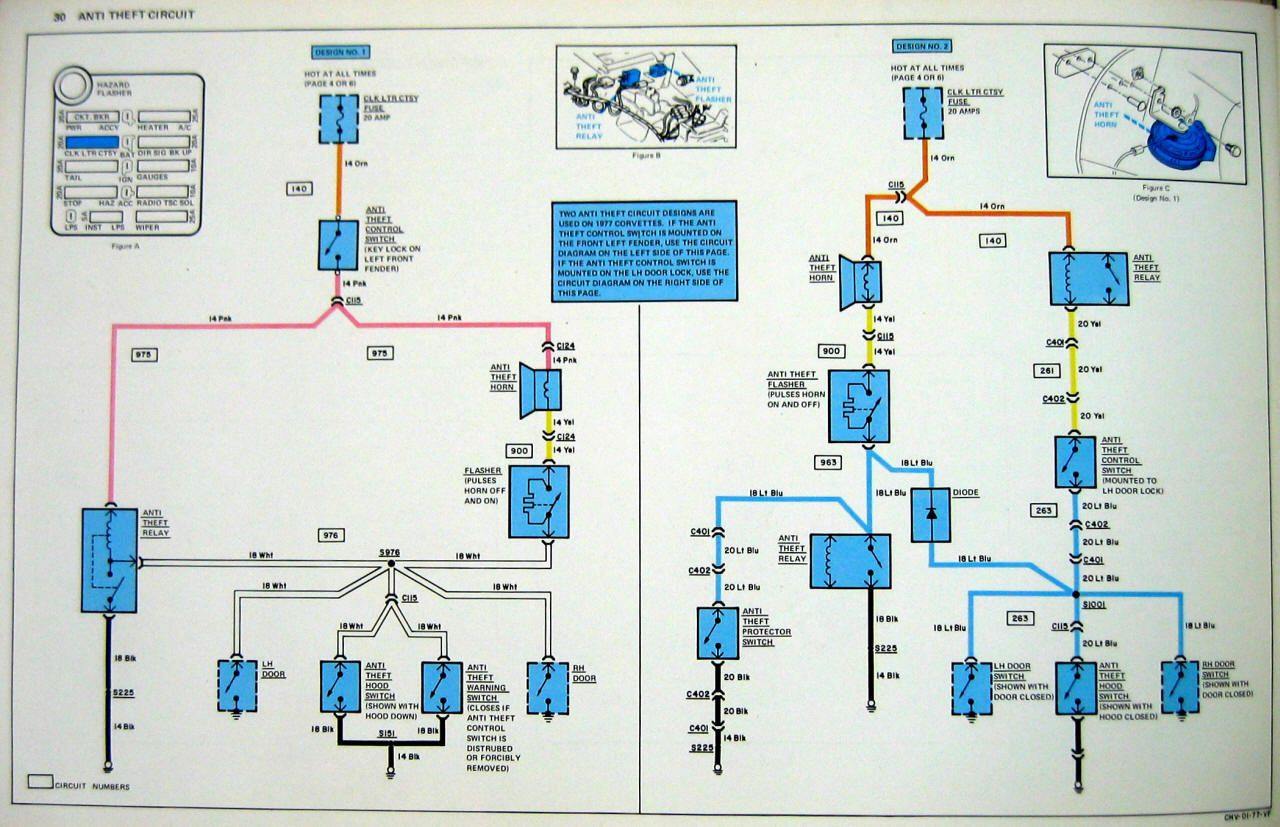

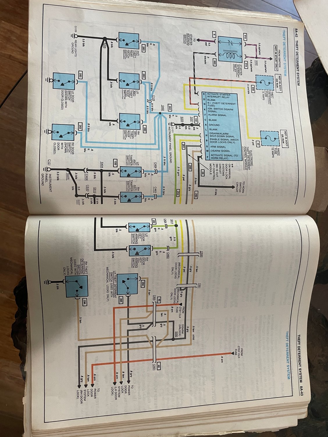

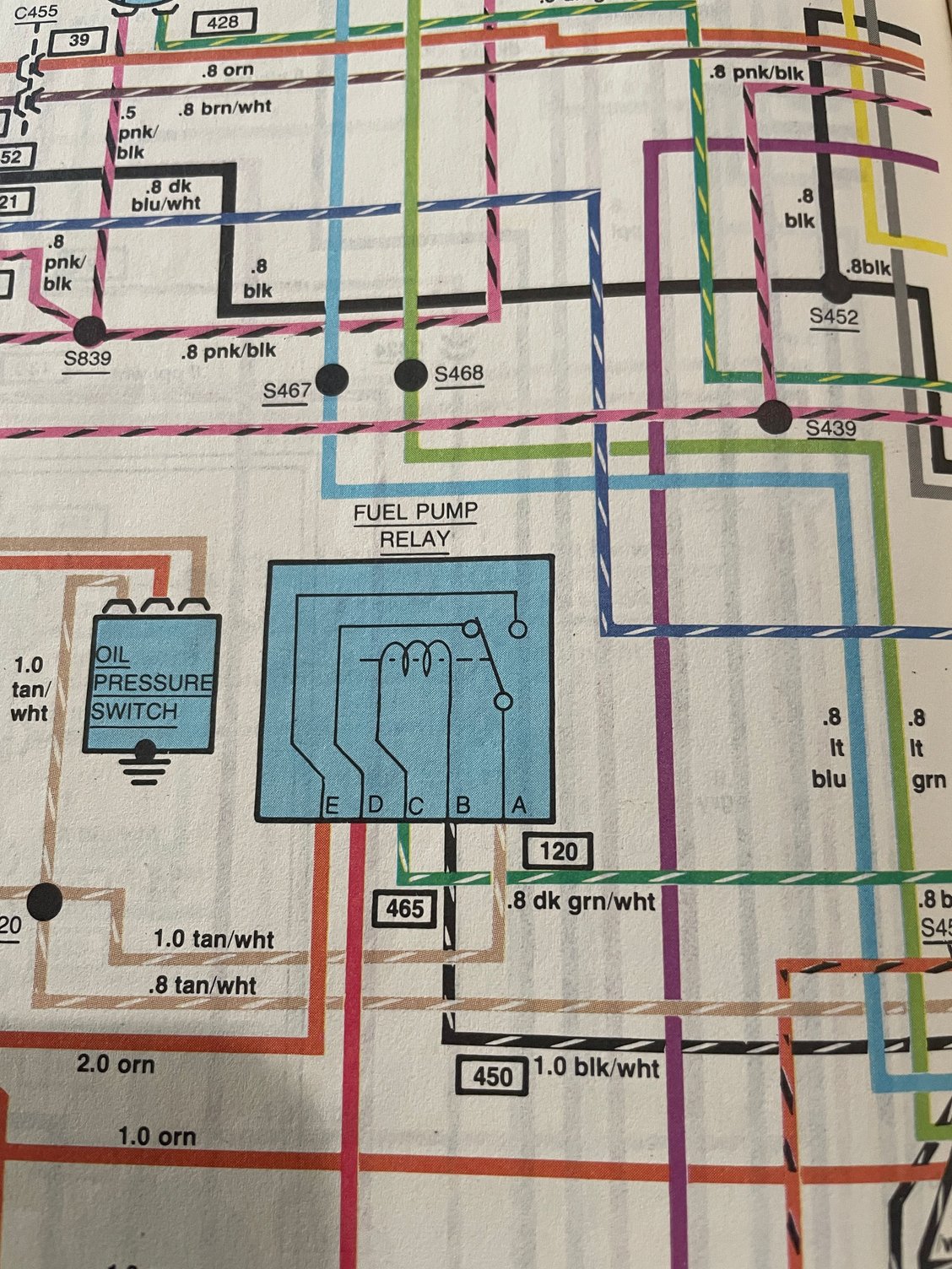

If this was an 82 it could be the Fuel pump relay looking at the wire colors. or park neutral relay
Theft deterrent system

The colors match up with the alarm relay

Hey guys thanks for the help. It an 1982. My wiring diagrams didn’t show me much. I try and figure it out with the ones you have and a lot of testing.
