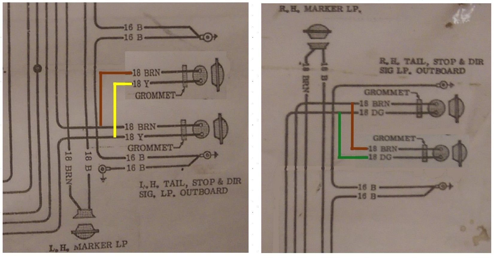

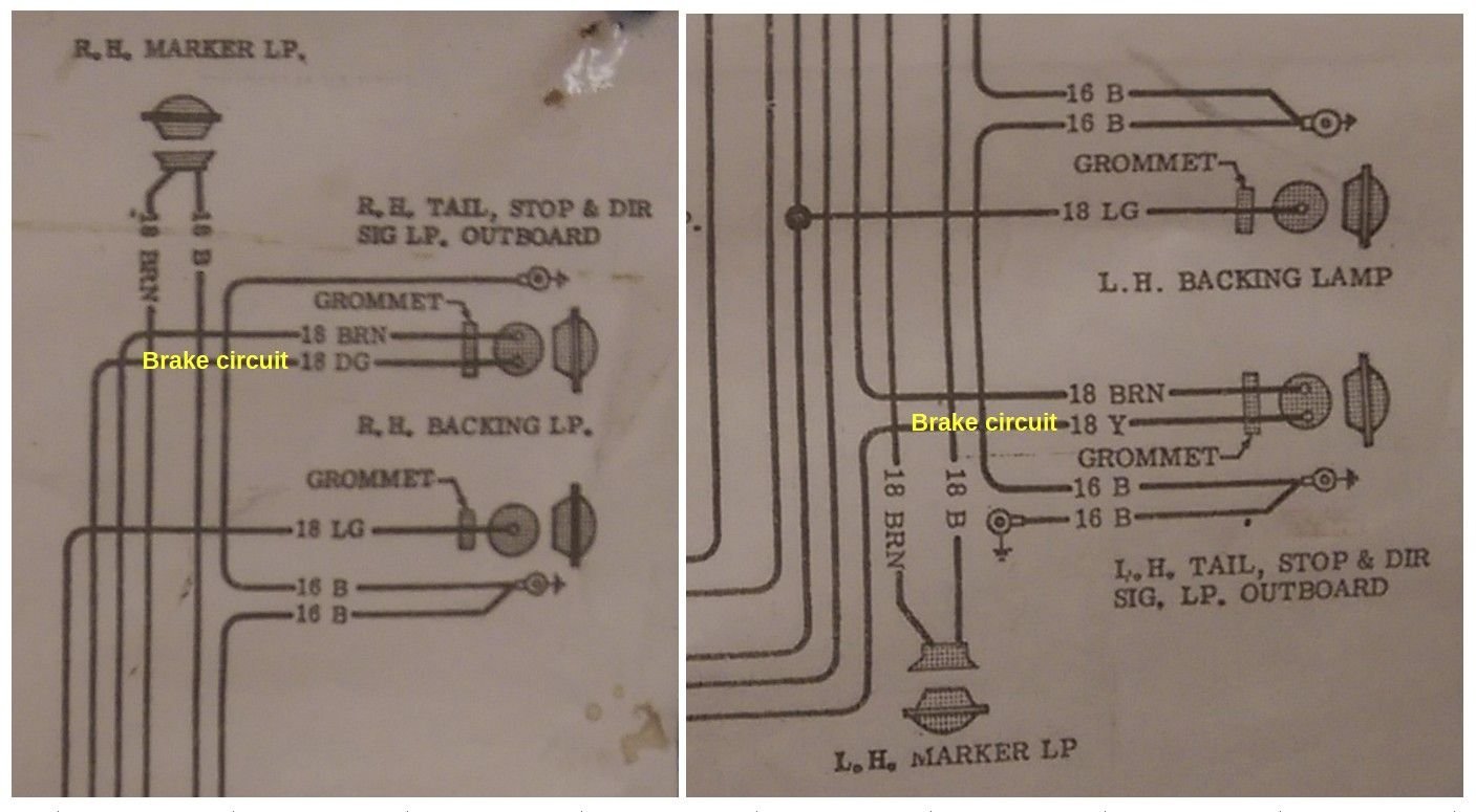

I finally crossed this off my list. I've been wanting to convert my 1971 backup lights to brake lights but the cost of re-pop parts, that may or may not be correct was prohibitive to me. I always look at the C3 parts for sale and found Bill (Bill17n72) listing of lens for sale at a good price. He even threw in the housing to boot. Bill even sent me $10 back because he thought they were not as nice as he thought. Stand-up forum member. Thanks Bill.
This information is from my 1971 Corvette. Your milage may vary on your year model.
I thought I was in for a battle as the tail lights and wiring harness is not the easiest things to get to. I planned on a few days but once I got started it all fell into place I had everything removed and cleaned up in a day and the second day was wiring and installing. One plus is my spare tire carrier has been removed for a long time. If it's installed it will have to come out. I managed to work around my mufflers etc. but they could be removed for better access. I managed to work around them.
I unbolted all the housing, including the two I was not replacing to clean them up. I got the wiring harness down and cleaned it up, repaired anything that was damaged but surprisingly it was in real good shape. I soldered and marine shrink wrapped in the new pigtails after making sure I have the circuits correct. On the 1971 the dark green wire on the passenger side is the brake light circuit and the brown wire is the running light. On the driver side the yellow wire is the brake light and again brown is the running light (sorry about my coffee stained wiring diagram ).
Spliced in new pigtails from Zip PN E-399. It's not correct for passenger side as they both came with yellow and brown wires instead of one having dark green. No big deal unless you want it to continue to match the original color coding.
New circuit
I cleaned all the grounds really good including getting a 5/8 round wire brush to clean inside the light socket. I cleaned all the housing and gave them a coat of metallic paint. I wanted something on the inside that would help reflect the light better. It's not NCRS or anything but I don't care about that. It will keep them from rusting like they were. Since I was using the outboard light housing from 1971 they have the fiber optics hole. Could have gotten creative and used the backup light housing but would have to swap the inner bulb housing to get the 1157 bulbs to work in them. I didn't want to go that far. I didn't mess with that and got some rubber stoppers from Amazon and plugged the holes. The brake light housings and the backup light housing mounting studs are not in the same location. A hole has to be drilled in the body for the brake light housing to work in the backup light housing location. Not a big deal.

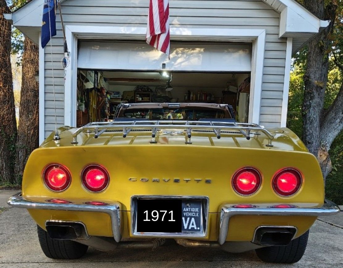

Results:
Before
After
