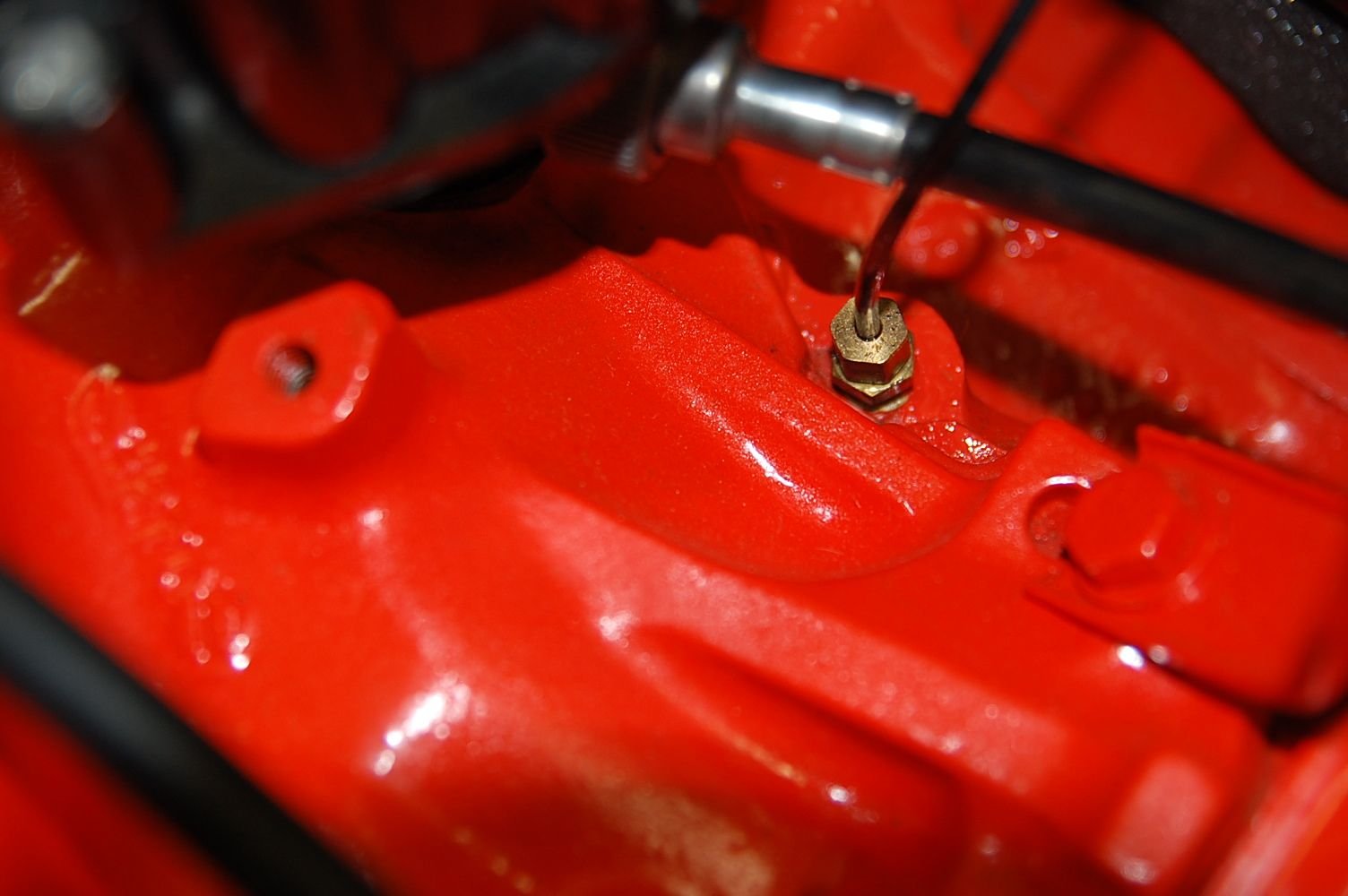

The early 70-72 small block system was pretty simple having a small brass fitting on the rear 'ledge' of the engine block near the base of the distributor, a length of plastic tubing of very small diameter that ran to a fitting at the back of the oil pressure gauge .
It did have a very tiny 2 piece 'collet' that fit in the end of the tubing to help keep it from collapsing. Some times this 'collet' is missing which can affect the connection and how the gauge reads.
It did have a very tiny 'collet' that fit in the end of the tubing to help keep it from collapsing. Some times this 'collet' is missing which can affect the connection and how the gauge reads.
