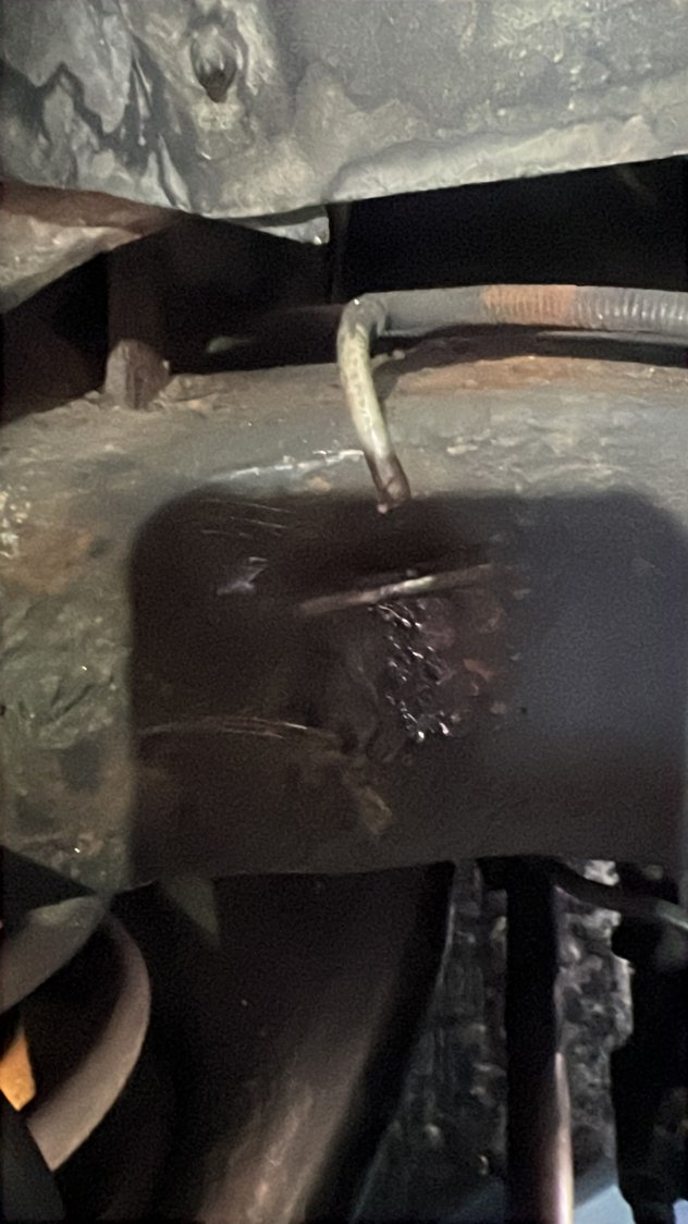

Help.
Removal tips pls.
Caliper end snapped. If I try and remove it from the Brass Block spiller I risk the same outcome.
I want to save the Splitter and not affect the other lines.
Cars on ground on stands. Ideally on my lift would be better but this all happened while bleeding.
7/16 Flair Nut wrench, nope. Will round it. The 3/8 on the caliper end nuked it.
Vise Grips. Shreds it.
Heat gun, nope.. heats up but nothing.
Map torch.. nope flammable.
I wanted to leave and make a new Double flair but I don’t have the room.
In a perfect world the front right comes off. New line and done…

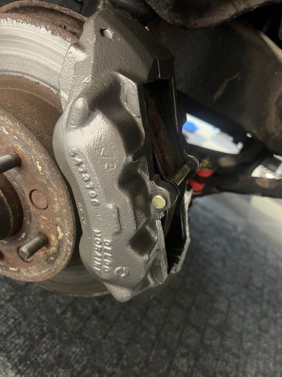

Thx Guys.
The proportion valve was easy with the lines cut. Everything removed.
for those wondering about the caliper rust. Brand new Calipers from Lonestar and the clear Cerakote treatment from yours truly. Slippy and clean.
why the old pads and rotors? Fear not, it’s only until I get the car at my other shop with the heavy equipment and 2 post I’ll drill them out. I have new ones and pads.
All this because wanted to bleed brakes… and the front right bleeder snapped. Was going to do this anyway but not right now… oh well

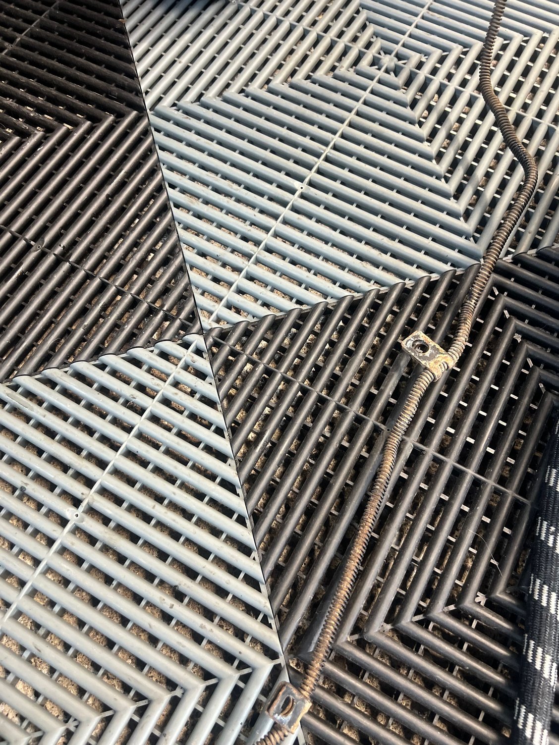

The Orig line.  Hardware will be blasted , coated or plated
Will clean as much as I can

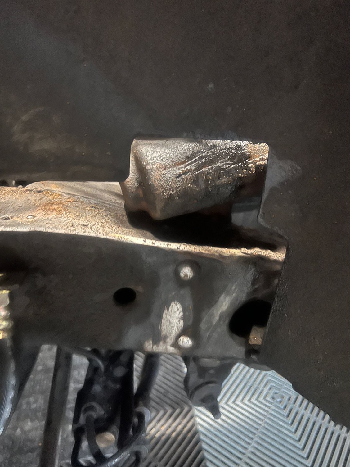

I realize that at there is a Snowball at the top of the hill but looking at that Brake Rotor sure makes me wonder when the last time the Trailing Arm Bearings saw daylight. The reason I'm saying this I recently had a 1963 SWC on my lift and the car has been beautifully restored. Only thing wrong is that somebody ran a new brake line around the one that runs through the frame. In other words the car has had everything rebuilt, repainted and made right. The one thing left to do is to do a frame off and that's what should of happened first.
I question the statement that the car was restored if they took this sort of shortcut. I changed out my '72 main brake line that also runs down the frame through the rear cross member and was able to bend and finagle it into place. I can't say it was the easiest line to replace with the body on the frame, but it was certainly doable.
Im just getting the car ready for Saftey right now.
This happened Because I even though you don’t have to bleed brakes for it where I live, It’s the right thing to do. The bleeder went, new caliper and lines, and then the hard lines.
Im buying the whole set as next winter I’m doing there rears when I pop the frame off. I have heard you can do it body on but why make it hard?
As for the trailing arm bearings.. bye bye. I’ll toss em and get new ones. Probable the whole arm.
My cars need to be mechanically tip top, rest assured it will all be done. Bushings, bearings and all squishy bits squishy.
