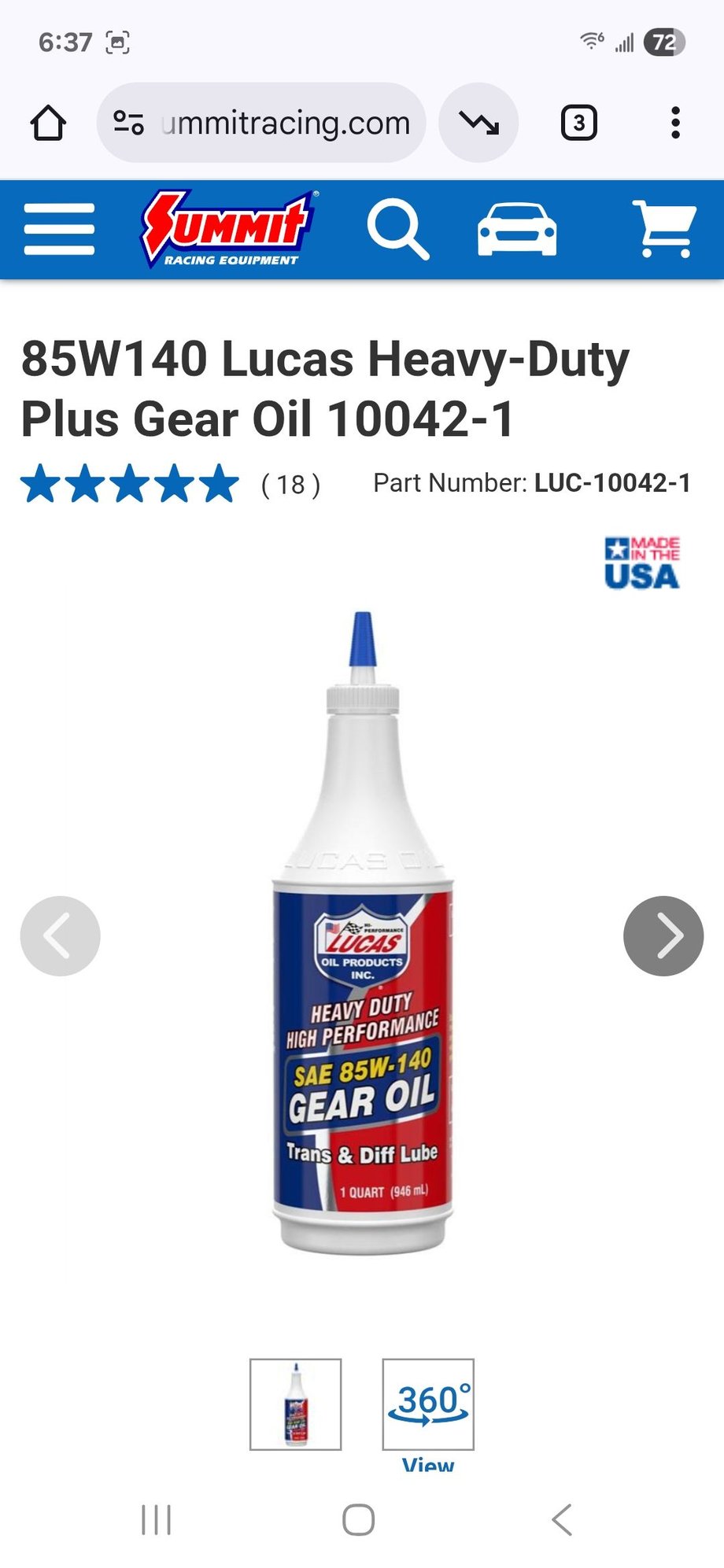

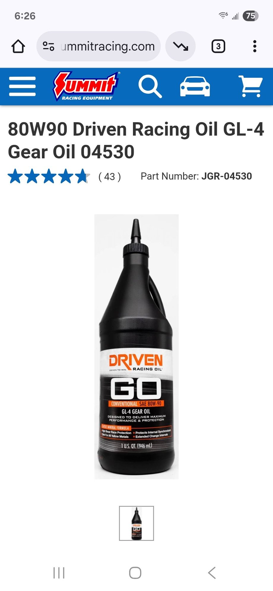

4 speed transmission fluid I plan on ordering this

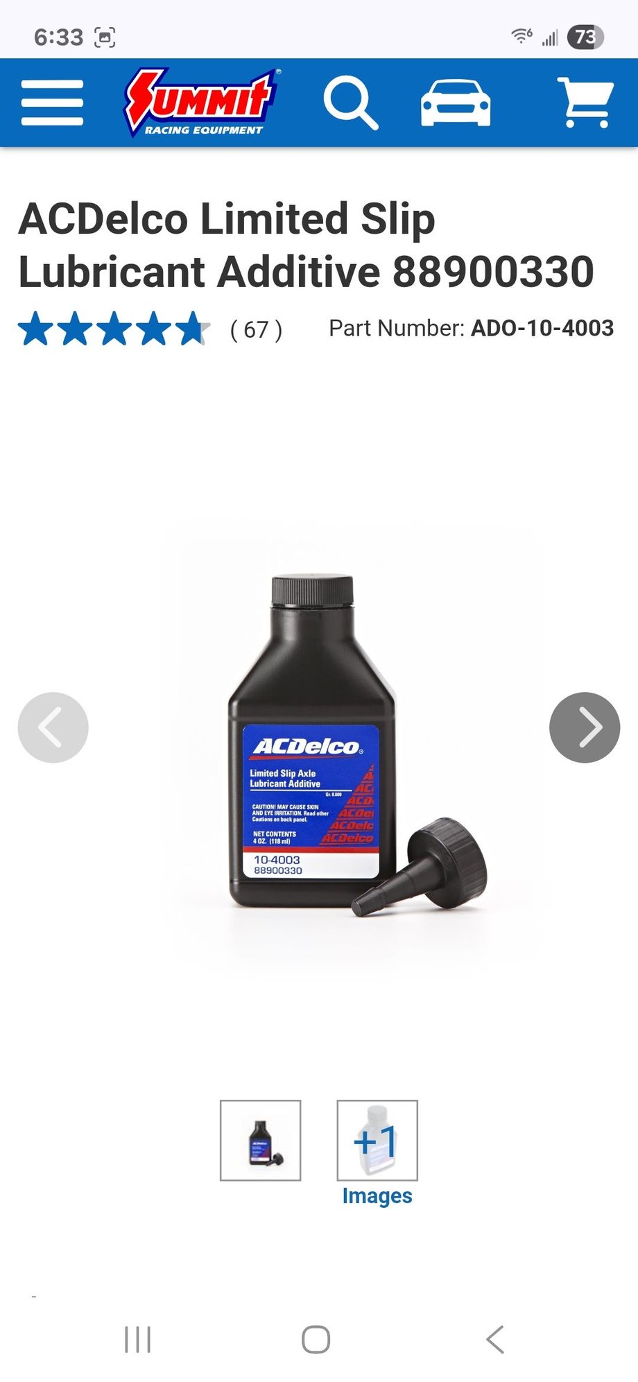

as for differential fluid I plan on this combination
I know opinions will be personal but is this all a good excepted products package.
I will research capacities, my 4 speed has a lower drain plug and I have a fluid pump for diff... when it comes to the diff, I will suck out as much as I can but when filling should I premix the fluid and additive to a specific ratio before filling... I read to add the additive first then the fluid but what about the unknown remaining fluid in the diff... will that not throw off the fluid/additive ratio or am I over thinking this.

I did my diff for the 1st time about 15 years ago. Used AC Delco 75w 90 & one bottle of additive.
I filled it halfway up, squirted in the additive & then topped it off. Been smooth sailing ever since.

No expert by any means but I use Mobil 1 15w-50. The other fluids look ok to me. Id add the bottles of posi fluid first to the rear diff. Yes, you will get many different opinions.

The Lucas gear oil is good stuff.
I personally do:
1 bottle Lucas gear oil
two bottles posi additive
fill with second bottle Lucas until full

Thanks guys... just wanted to verify what im ordering for trans and diff are good options, doesn't appear to be a documented ratio of diff fluid to additive and I read as many people suggesting 1 4oz bottle as 2 bottles of additive... perhaps I will go in the middle

I think your fluid brand choices are good ones. Nothing skimpy about either Driven or Lucas. I've used both in my cars and not had any problems.
I used 2 small bottles of GM posi-additive and don't think it matters much the sequence of when you put it in compared to the base lubricant -- it's all going to get mixed up very quickly when the diff turns. That said, I squirted about 1/2 bottle of lube into the diff, poured the additive into the bottle, shook it up and emptied the rest of the bottle into the diff. I don't recall how much base lube it takes, but think you're going to open a second bottle to top off.

Thank you... perfect, I wasn't concerned about the sequence only ratio... didnt want to get two bottles of additive in and not enough room for diff fluid if I couldnt get all the old stuff out... I will see how much I can remove with the pump and judge from there.
