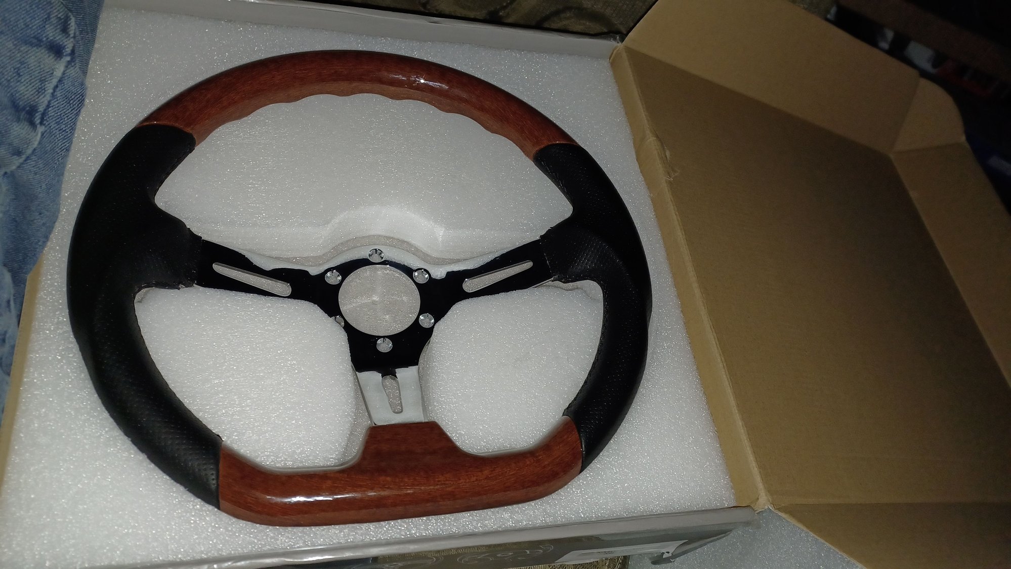

This should have been easy to figure out but I have failed. I got an aftermarket steering wheel for my '73. It has 6 holes. Well, the original steering wheel also has 6 holes. But they aren't aligned the same. This wheel has screw holes at 12 and 6 o'clock, and the stock wheel has holes at something like 2 and 10 o'clock. They won't line up.
So, what adapter do I need? Some sort of 6 hole to other 6 hole? I know there's a simple answer... (Non-adjustable column.)

This is the wheel. I wanted something more modern looking and I'll get a little leg room with the D shape. And it has a little retro look, the three slotted spokes like stock. I have the wood accent interior; this goes pretty well with that too. Was not expensive either. So, I'll make it work.

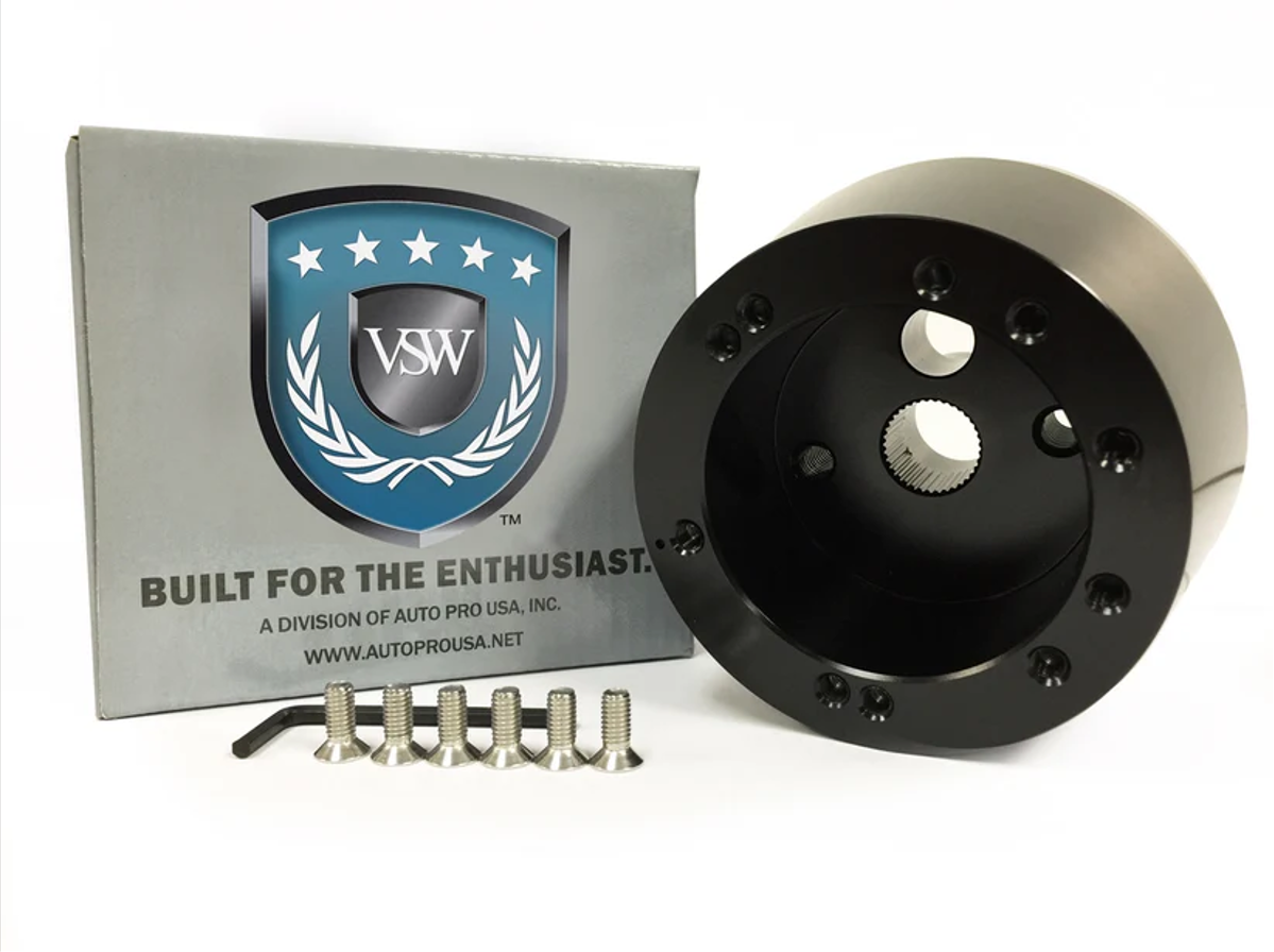

Here are some hub adapters.
https://vswsteeringwheels.com/collec...S6-Hub-Adapter
The steering wheel in my 80 is from VSW (formerly Volante). It bolted right on. They have lots that are a drop-in replacement for our cars (any "S6" wheel). The S6 Step Series are a direct replacement.

Thanks. I'm thinking this one would work but it's more of a replacement hub than an adapter. I ordered one of the 1/2" adapters, they are very cheap, and I plan to fill in then re-drill the outer ring of holes to match the stock hub. If I can't make that work, I'll look at getting this one.
Flaming River Columns w/ GM Spline Style | S6 Black Hub Adapter | STH1035BL
