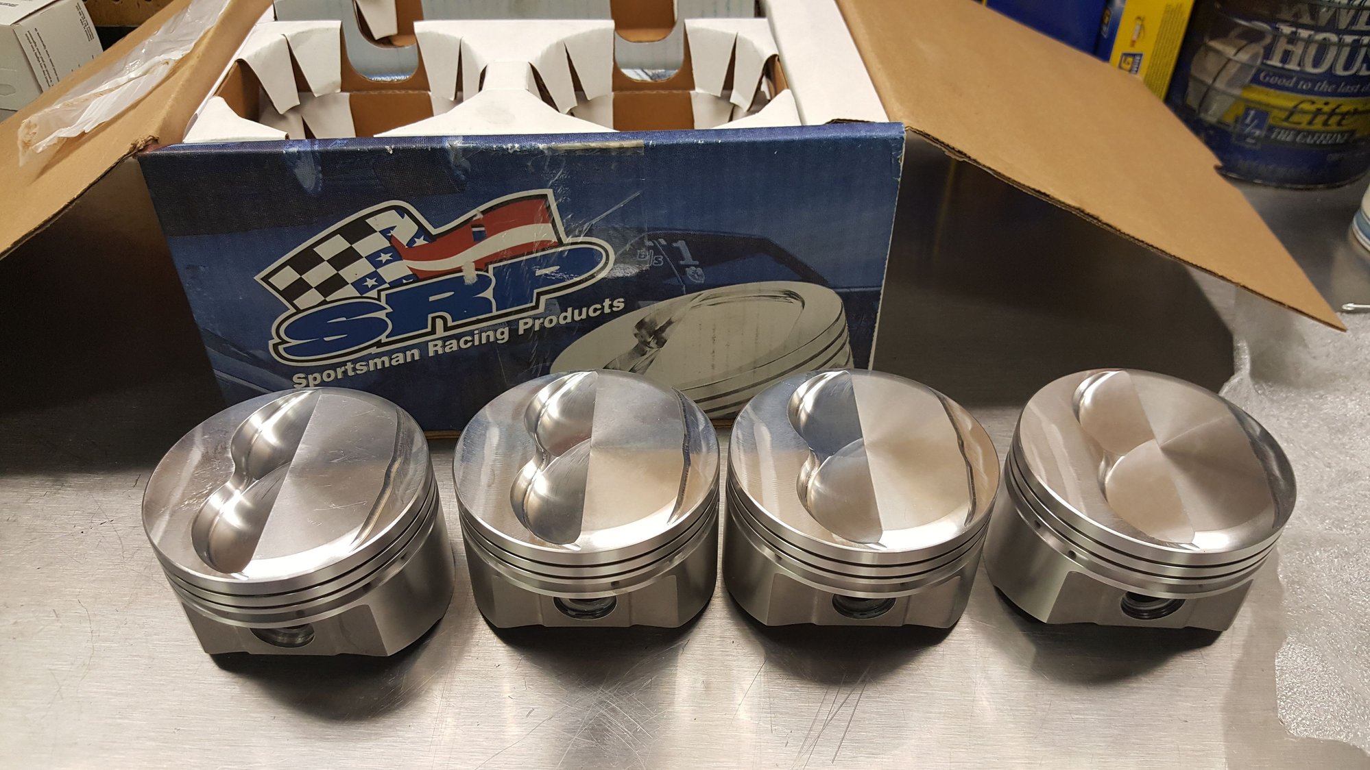

SRP forged pistons is what I would get.
Get Mike Jones to grind you up a solid flat tappet custom cam to match. You will not regret it. He can make it work great with your high compression. I have 10.7 C/R, his cam with pump gas, a smooth idle and no issues. That would work perfectly for what you are shooting for.
Another way to go would be an LT-1 repro solid lifter cam with EDM drilled solid flat tappets. You might want to drop the C/R to about 10.5 to 1 for that GM spec cam.
The EDM lifters give you the best chance to live with the oils and parts we have available. I would buy Howards lifters if you do not go with a cam from Mike Jones. His cams and lifters are the best you can get.
Mahle pistons are great as well.

For those who harbor a romance with the Silv-O-Lite brand; its parent company is United Engine & Machine (aka UEM). Thereby, one of Silv-O-Lite's "sibling" companies is branded ICON.
FYI --- ICON concentrates on Forged pistons.
OTOH: I prefer piston brands as stingr69 suggests; as well as CP-Bullet, JE, Diamond, Racetec, Ross and Wiseco.

that's what I would like, to maximize torque, I would like to keep the original crankshaft, will bore the cylinders .30, I was going to go with the TRW (L-2304F) forged pistons but what you would recommend?.also what would be good roller cam and lifters in your opinion

I apologize, but I'm not comfortable with recommendations that deviate greatly from a well thought-out recipe.
L-2304F is a quality piece (it IS virtually same as what's OE), but is heavy as a tank and uses old-fashioned tractor style wide rings and it has a dome that will continue high compression. FWIW, brand TRW no longer produces engine parts; Sealed Power aka Speed Pro manufactures L-2304F.
While your steel OE crankshaft was a very good one when new, and may still be in fine condition, it cannot offer benefit of larger/longer stroke (More Torque).
If you're going to continue with OE stroke & high compression, CF member stingr69 offers a good recipe. Perhaps Mike Jones will grind you a cam designed to maximize torque (although No grind can emulate longer stroke). Regardless, Jones' products & services are as good as it gets.
