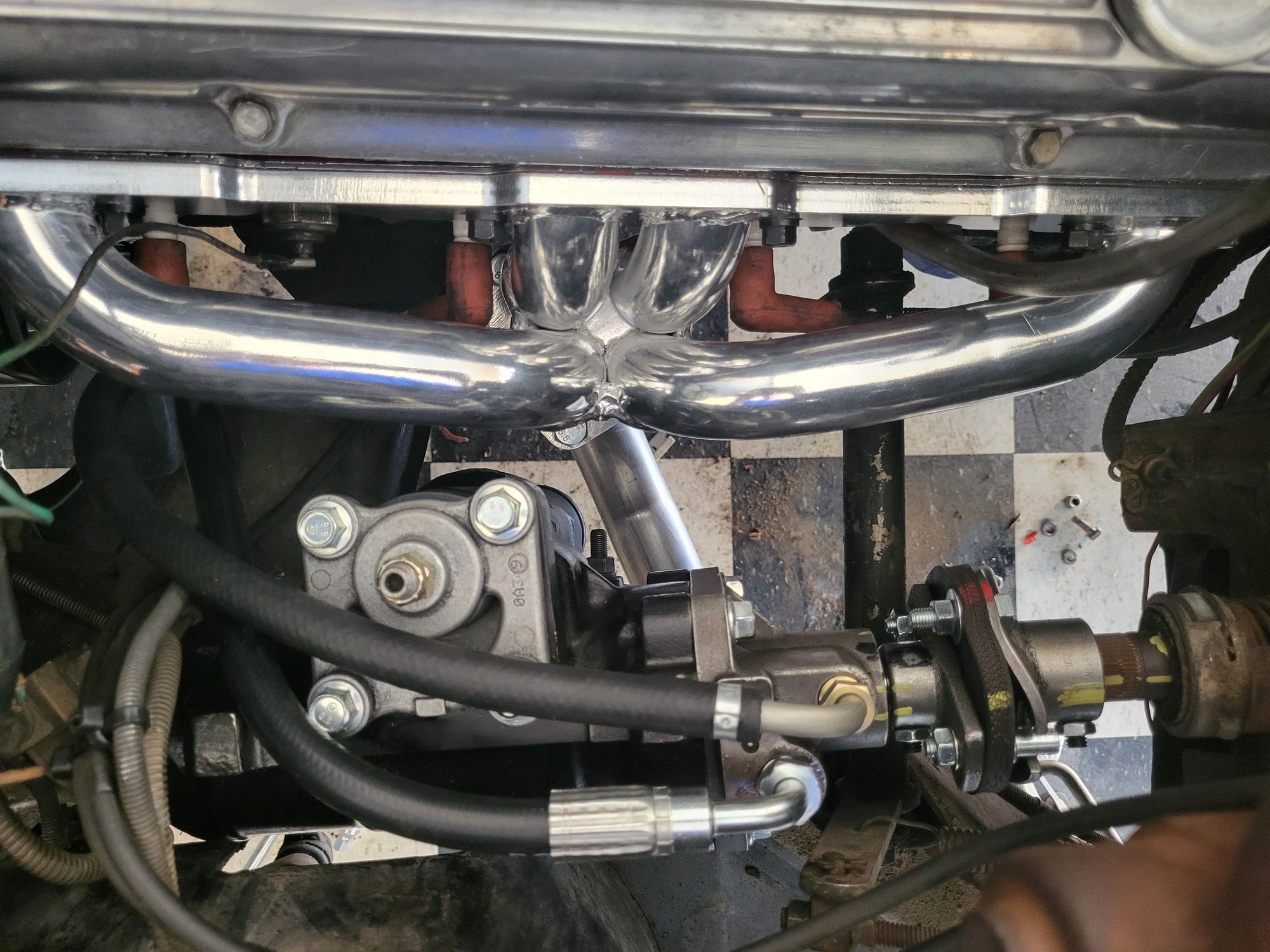

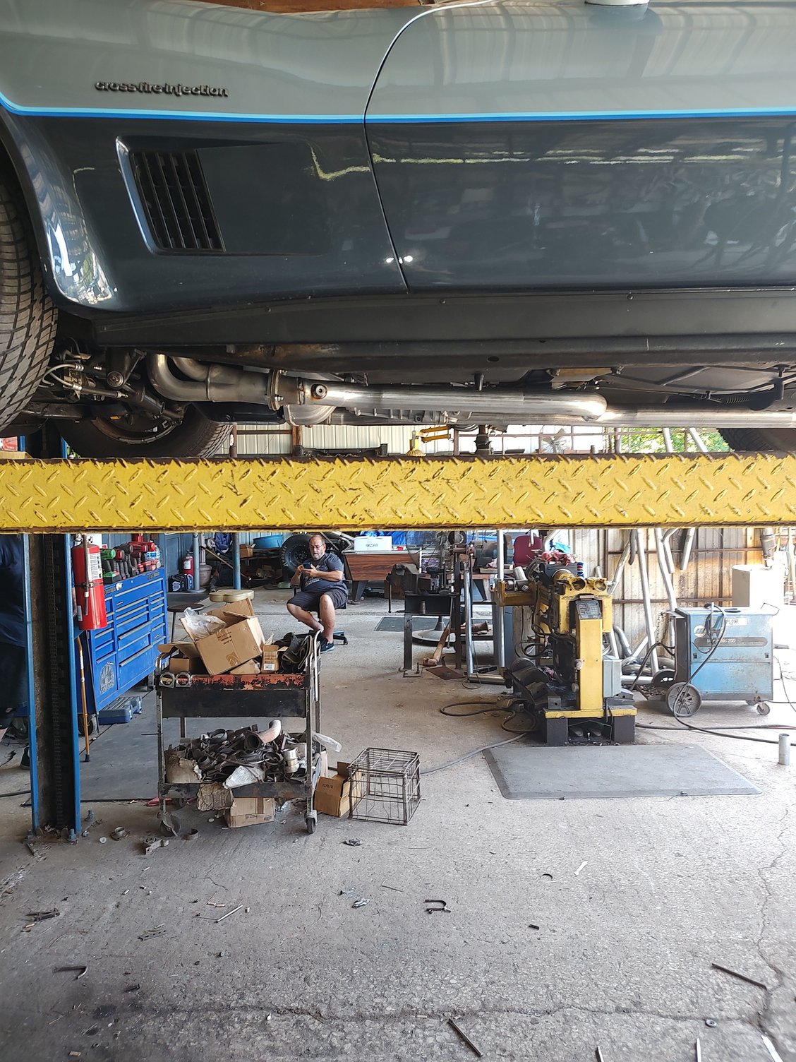

I just installed a set of similar on my 70... perhaps not the same performance? but they look and fit perfect for $200, I did the shorty headers to attach to my side pipes, happy with them and the sound... easy install, came with collectors and hardware

purchased them on ebay, wasnt expecting much in quality but wanted a better option for factory style side pipes and didn't have manifolds... easy weld up from collectors to pipes, turned out to be better fit and quality than expected. 2.5" collectors and love the sound with the more mild Highflo pipes, longtubes with side pipes wasnt an option for me, perhaps an option based on what the OP was looking for.

im in Arizona and don't get too concerned with these rusting down the road but for the reviews and $200 was a good short tube header that works with auto and 4 speed, mid length typically won't work with stock 4 speed configuration, not sure the OPs transmission.

I considered the block hugger style initially but too close to the engine and engine mounts... these exited very close to the factory manifolds... I just cut the exhaust flanges and welded so virtually the same line, maybe an easy option for OP if keeping original exhaust.
