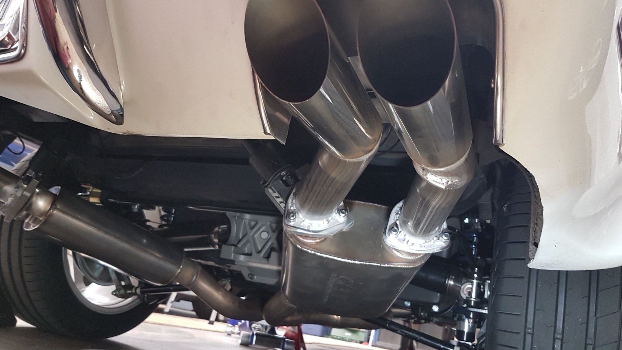

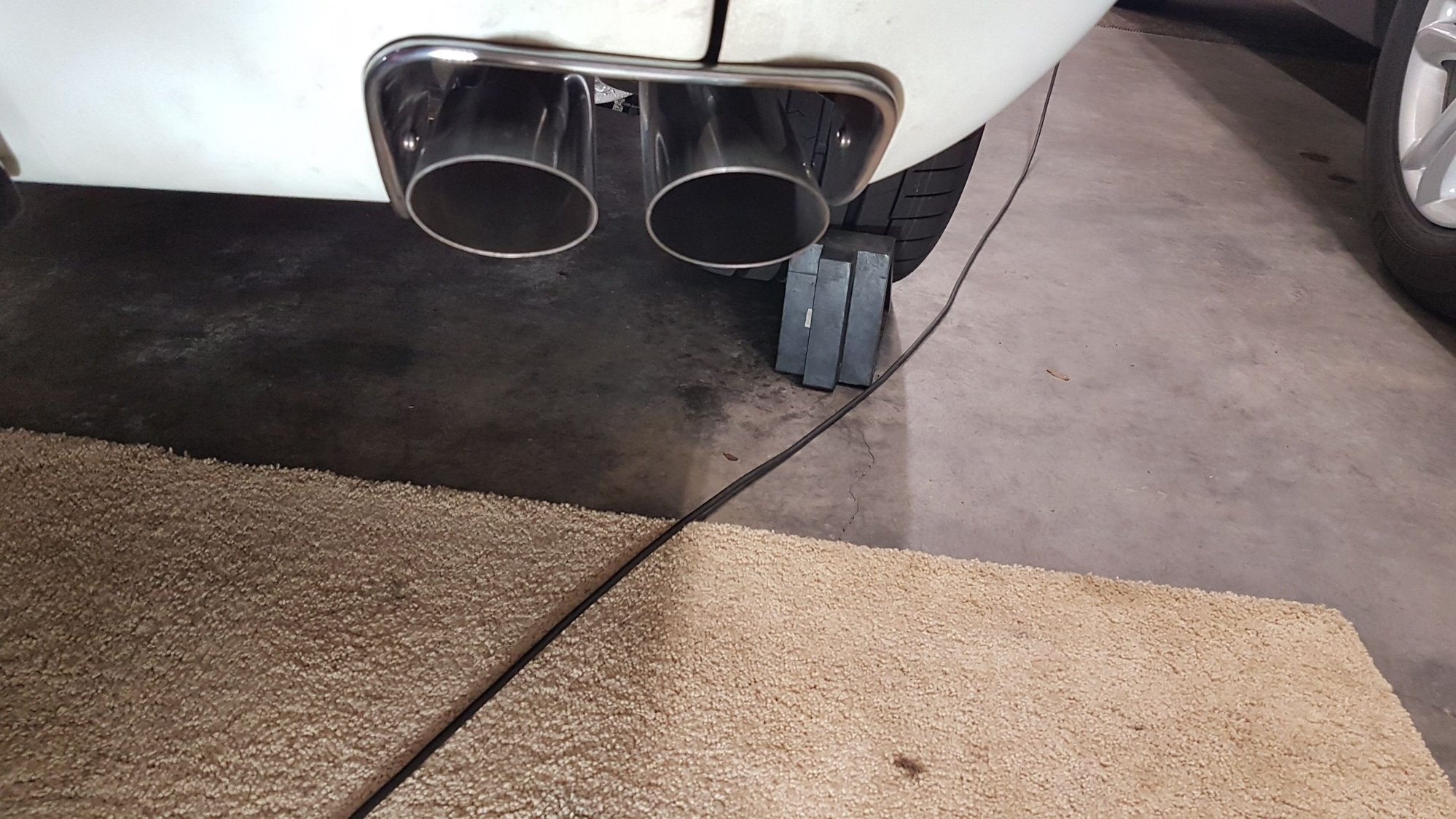

I am pretty happy with this system from this E-bay seller. The system has an X pipe integrated, which helps with attenuating sound and improves performance (slightly). The mufflers are included and have dual tips instead of square. The sound is pretty mellow. Probably like a Magnaflow system.

Looks great. I like it better than the rectangular tips. Maybe the op could modify the.stock tips to slip over the round tips. Or even gab a box but personally I'd leave it as is.

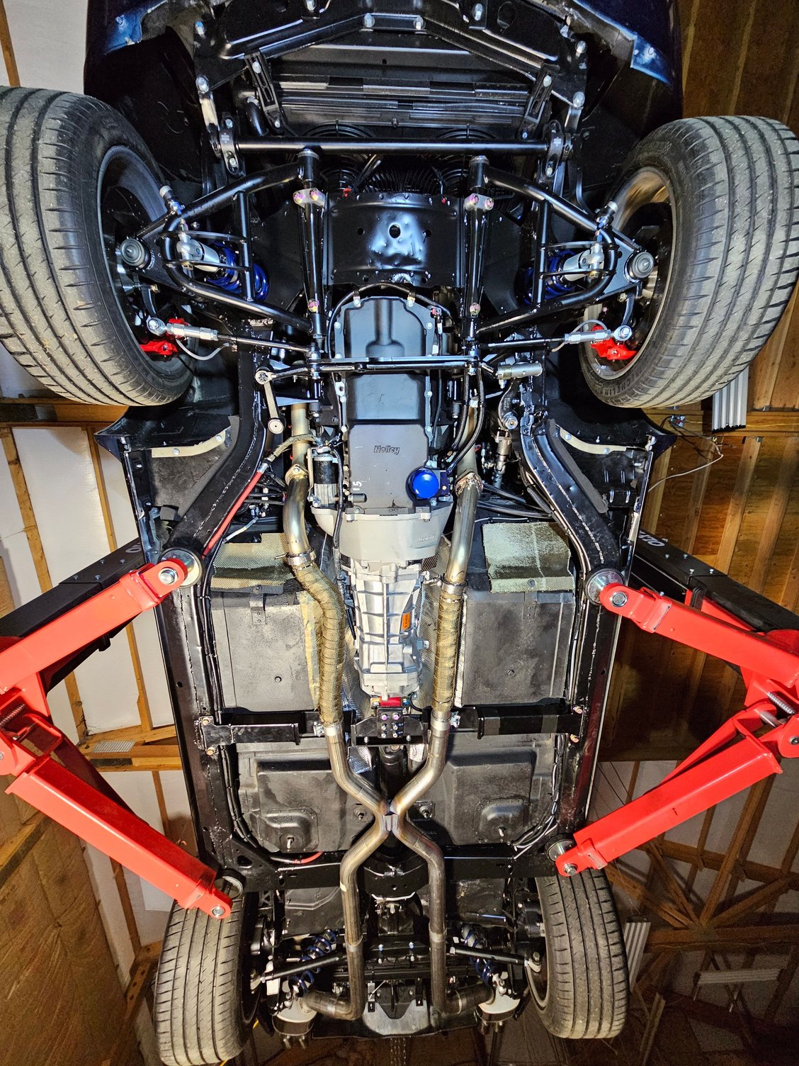

Great looking exhaust! Can you share some pictures of under side and how it is connected to the headers?

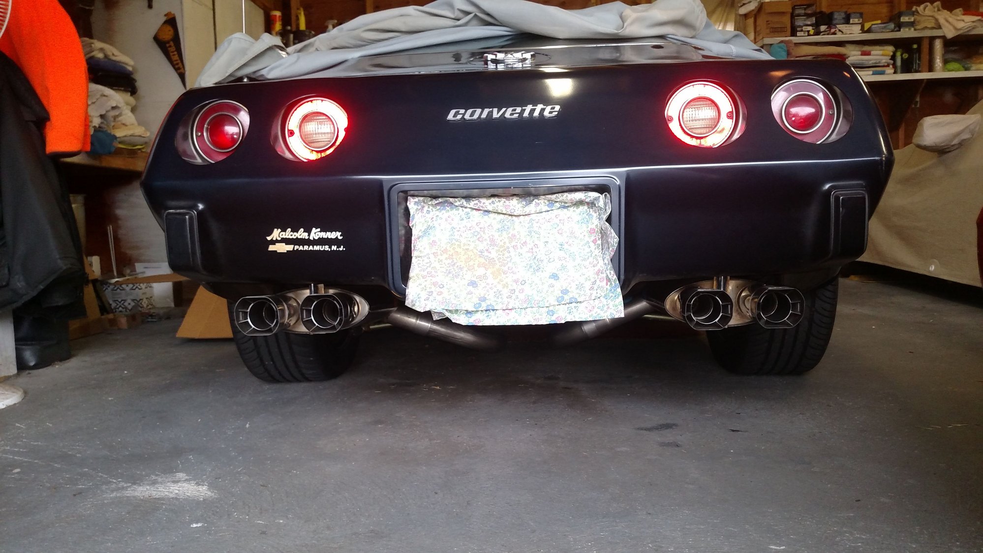

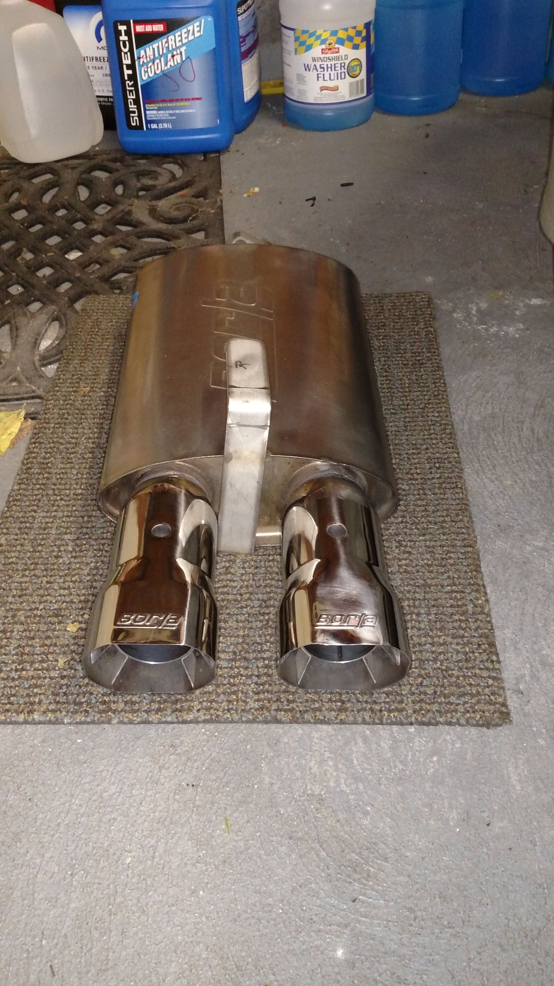

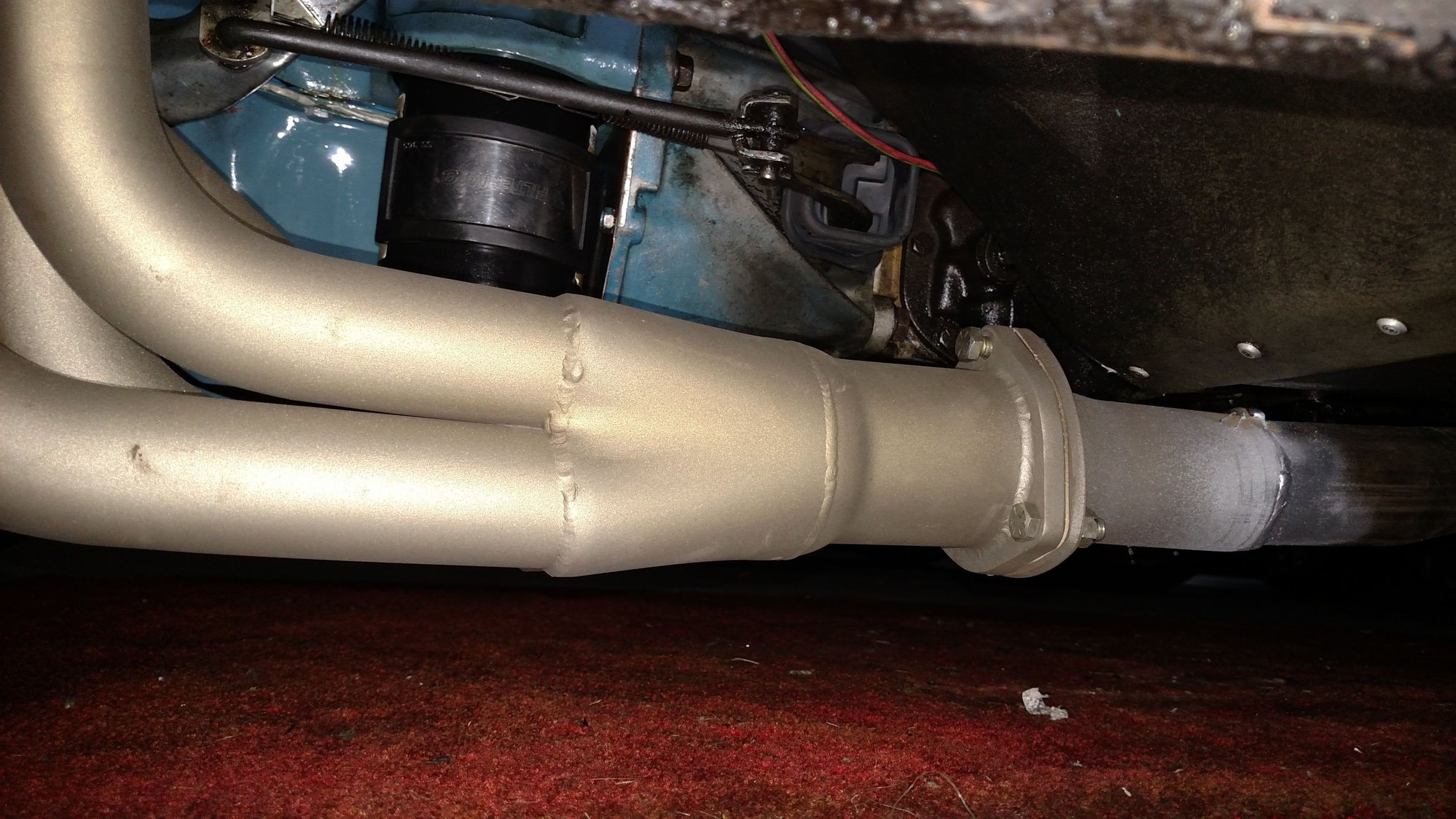

Below is my rebuilt/upgraded original L-82 355 with Mid America SS 2.5 inch exhaust, installed originally by me in early 2000's, adapted to later ceramic coated SS 1 7/8 inch headers, custom finished with C4 Type S Borla square tipped mufflers.The C4 Borla Type S mufflers (not cheap but worth every $) are, in my opinion, having used or heard too many mufflers to list over the last 45 years, far superior to anything out there with a smooth mellow idle sound, no motor boat sound like most SBC mufflers, allowing easy conversation at cruise with light to moderate smooth rumble, pretty aggressive only when pushed.
Old Nov 1, 2025 | 02:54 PM
RocketJSquirrel's Avatar
RocketJSquirrel
Joined: Nov 2023
Posts: 134
Likes: 173
2026 Corvette of the Year Finalist - Modified
2025 Restomod of the Year
Note that I have Hooker Blackheart cast headers on a 6.2L LT1 swap, and a Gforce removable cross member, so from the X pipe forward, it is not stock. I had to do some fabrication to get it to tie into the system that I noted in my post. Most aftermarket systems are from the X pipe rearward.

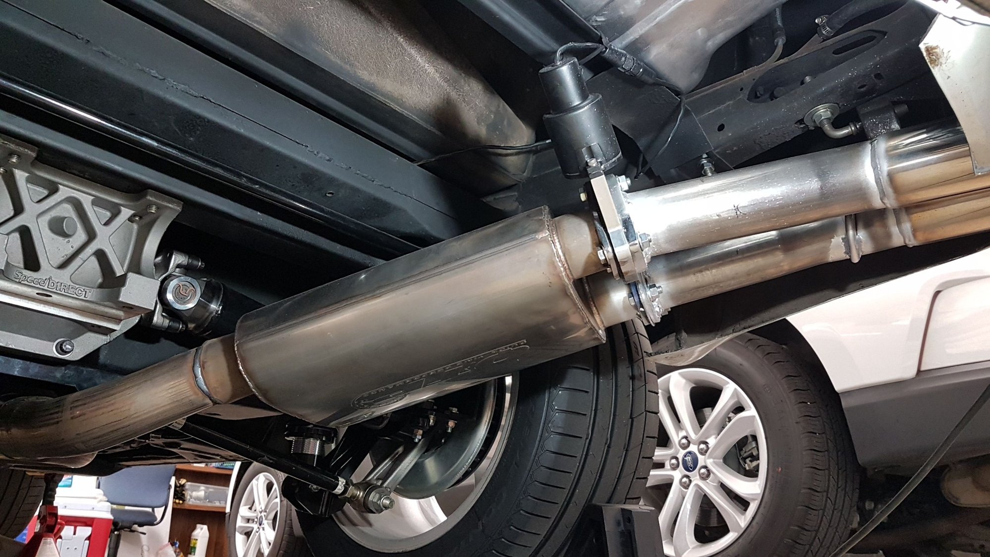

I trailered mine to an exhaust shop to get this system installed. The mufflers are 2.5" diameter, long QTP Quick Time Performance units. I ordered it with key fob actuated electric valves to have a dual mode setup. Relatively quiet for everyday driving, or louder when you want it to be. I really like the sound in the quiet mode.
Remote control valve for straight thru
