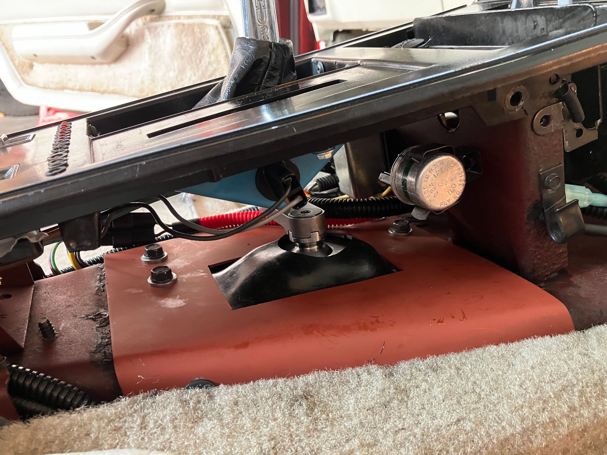

Does anyone know of a shifter boot that will cover the new hole that needs to be cut when swapping in a T56? I was going to weld in a new piece of metal, but I imagine I'm still going to get some heat and air coming in, so I figure a rubber boot would be better - plus it'll make it easier if I ever want to replace the shifter in the future.

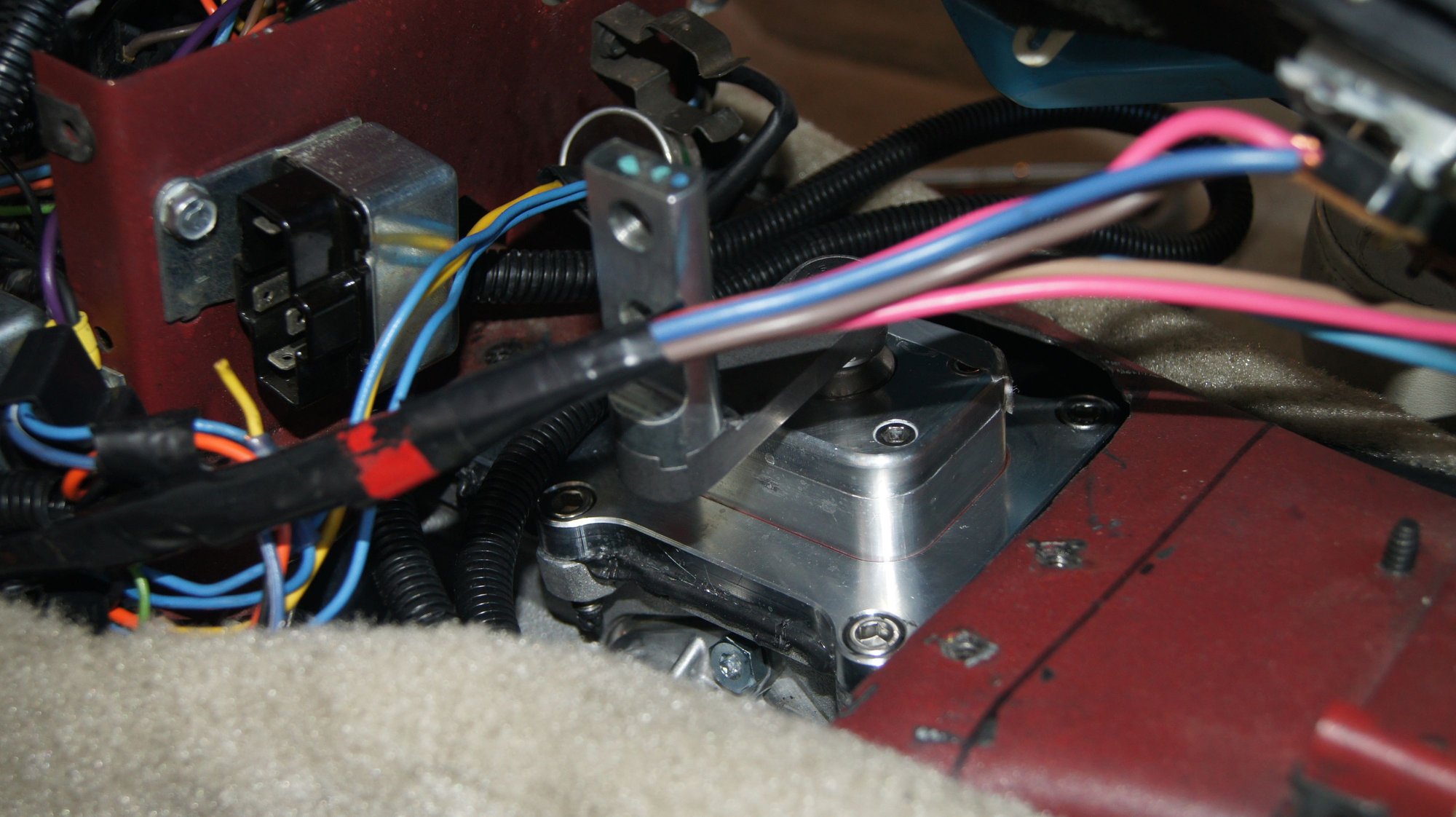

I made a metal custom cover with rubber seal for my T56 magnum 6 speed conversion from auto. I used the factory bolt location for the auto shifter to help secure the custom plate.
