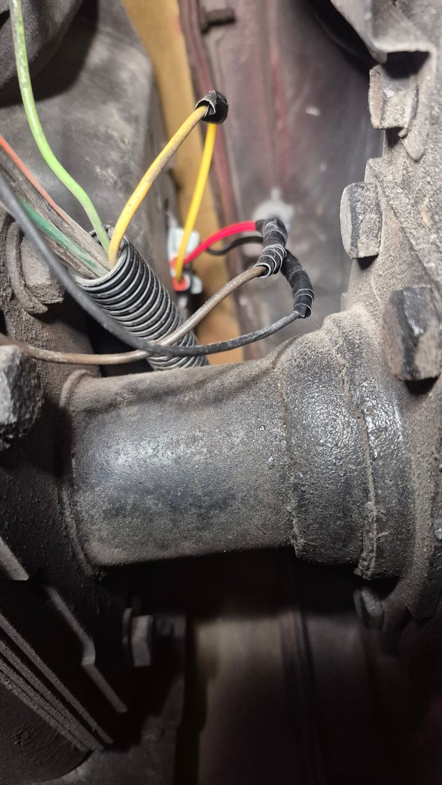

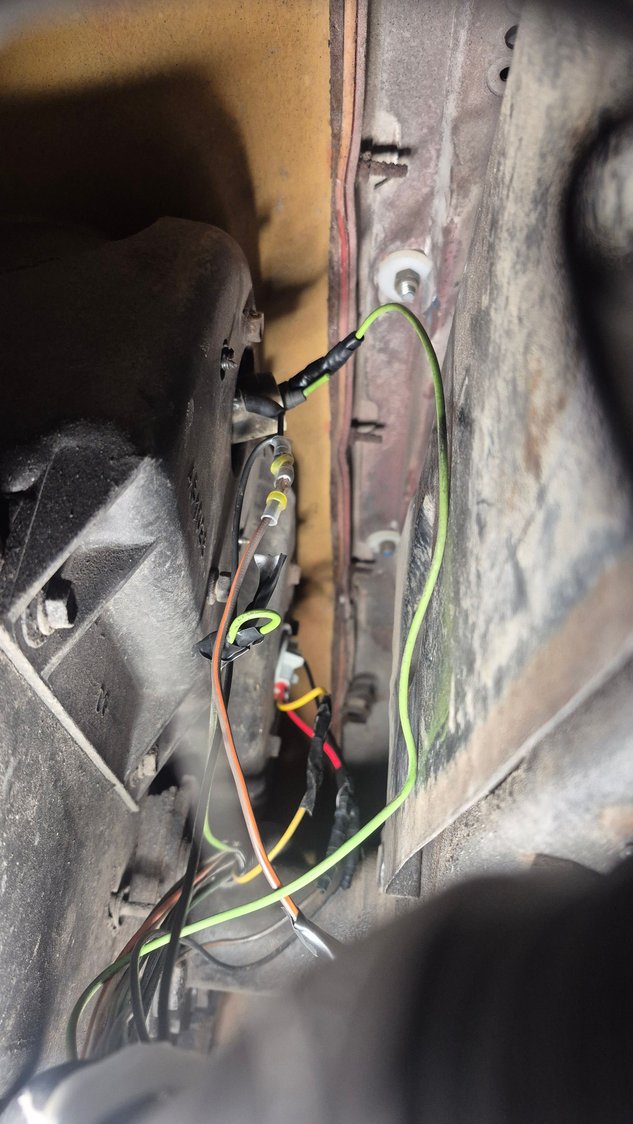

Okay so the pictures I'm posting are of the wiring setup redone to where now the brakes turn on when I hit the brakes headlights are on but now the turn signal doesn't work

Only thing I changed from the way it was was add the new socket an redo the ground bc it looked like someone just took a couple chunks off an wrapped it around so i cut an spliced in the new ground to get a better connection and the reverse light had an extra wire that is capped off now

the top photo is the new light socket an the bottom is the reverse light which seems to have a dual filament socket that i had cut an capped off

The brake lights go through the turn signal switch. On all years. So, still can't help with precise wiring as I haven't a clue nor does anyone else on here as to what year car your working on.
if your signals are not working. Start checking, do you have power to the turn signal flasher? Not the 4 way flasher, that's a different one. Do you have power coming out of the flasher? Do you have power on that wire at the base of the steering column? When you engage the switch left or right Do you get power on the correct wire coming out of the column? What color are these wires. Who knows. We don't know what your working on.

sorry about that yall wont believe what the dng problem was......the place we bought her from wired everything *** backwards so me following the instructions like a good boy scout.....not put them in the proper way not the Jerry rigged way they had it
