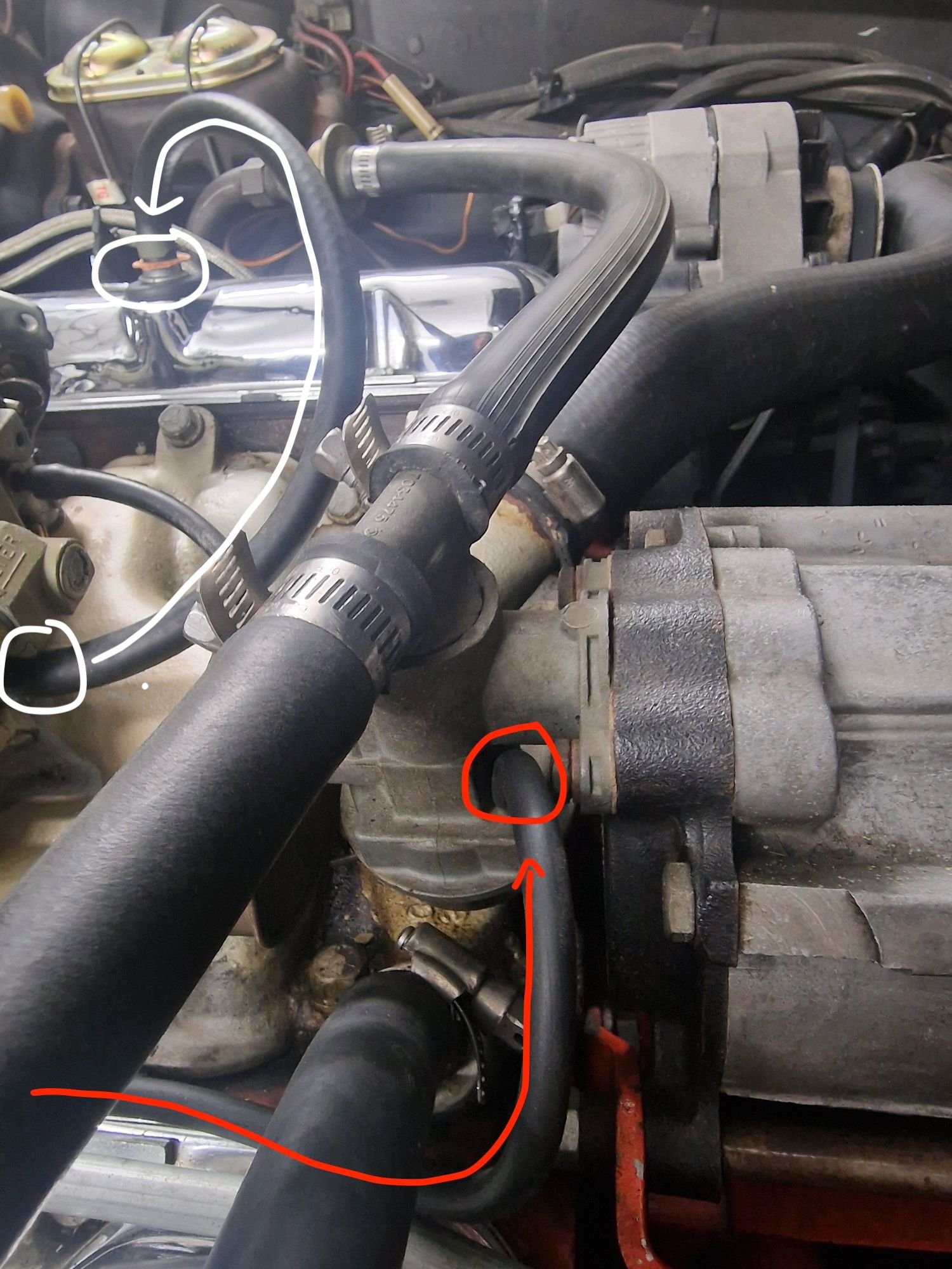

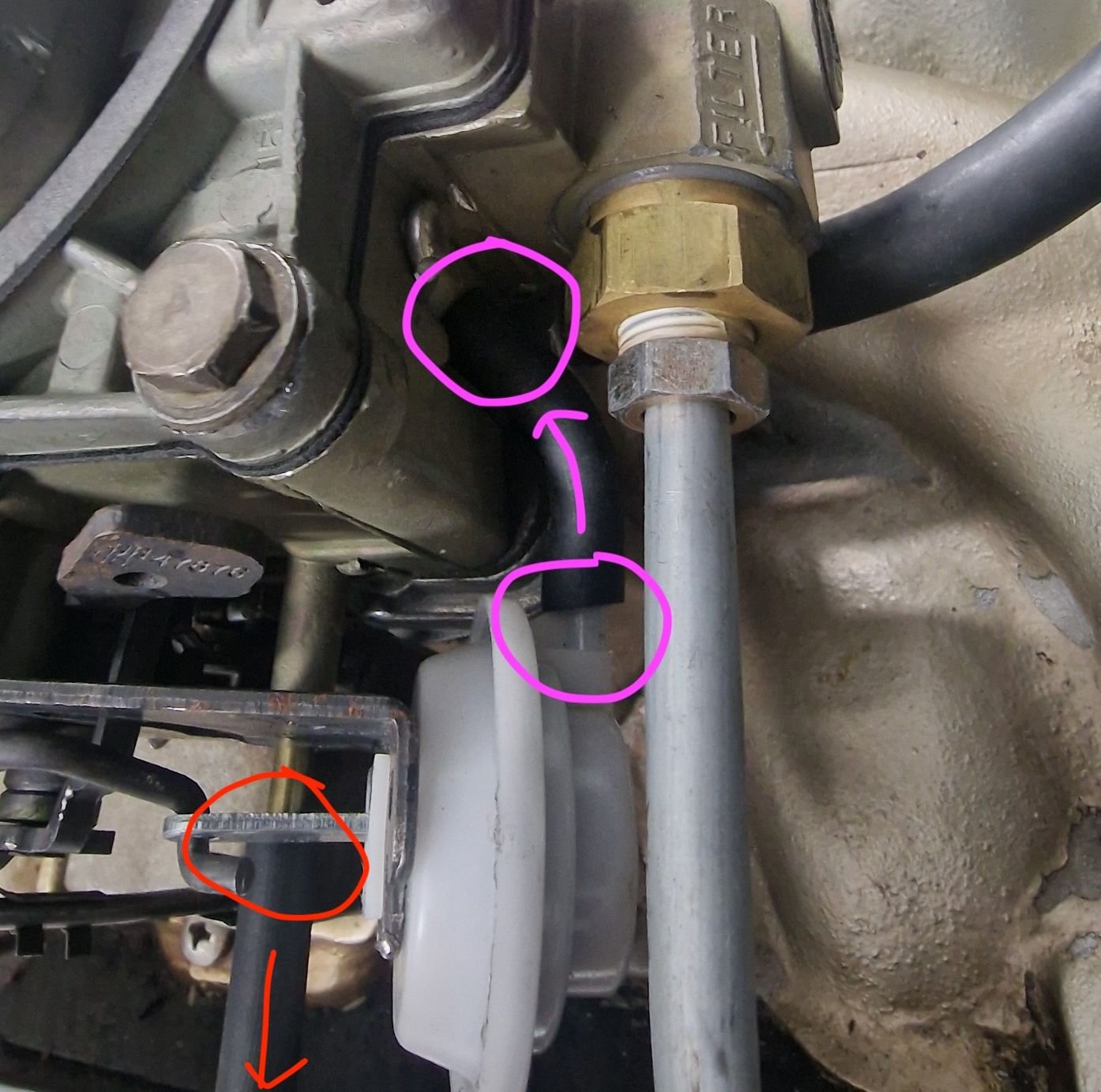

Can you please help identify each colour?
Yellow = to wipers/headlamps from intake manifold
Dark Blue = capped from intake manifold
Green = ?
White - ?
Red = ?
Pink = ?
Light Blue = ?

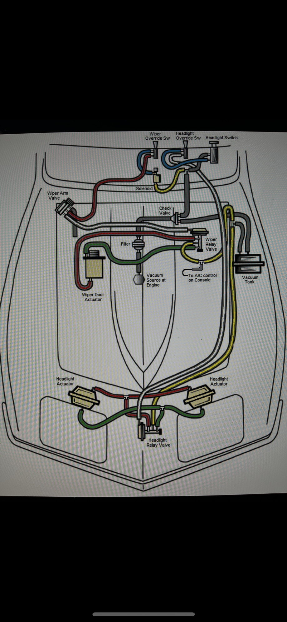

Maybe these will help!
Thanks! But these relate to the wiper door and headlamp vacuum hose diagram, which, in my photos, all stem from the yellow line. All the other colours (green/red/light blue/pink/white) are not linked with the wiper/headlamp, hence my question what they are related to?

Be aware that you have a hacked, commercially rebuilt carb that likely has a host of problems that can cause a bad idle... e-mail me for a paper outlining just a few dozen of the problems that your carb will have. I can see that your carb has been pieced together from several different year carbs - only your float bowl is a '69 part. It's what's known as a "Frankencarb," and the Frankencarbs can seldom be set up or repaired to run right.

Originally Posted by chrisdotmt
it would still be nice to know what all of the other vacuum connections are and what goes where?
There is no single, all-inclusive vacuum hose diagram. Your Assembly Instruction Manual (AIM) has all the details on vacuum hose routing for each subsystem in the applicable sections of the manual, and shows all hose routings and installations for each subsystem (i.e., emissions, accessories, headlamps, etc.). It will not show the hoses that are a part of a component, such as the choke pulloff hose you have circled in your one photo above: You can obviously see that the hose is the vacuum signal for the choke pulloff, so no explanation should be necessary for that. Just go through your AIM and tag every page that has a vacuum hose schematic, and by the time you've tagged every page, you will have a complete vacuum hose routing outline. Here is one such diagram for 1969:
