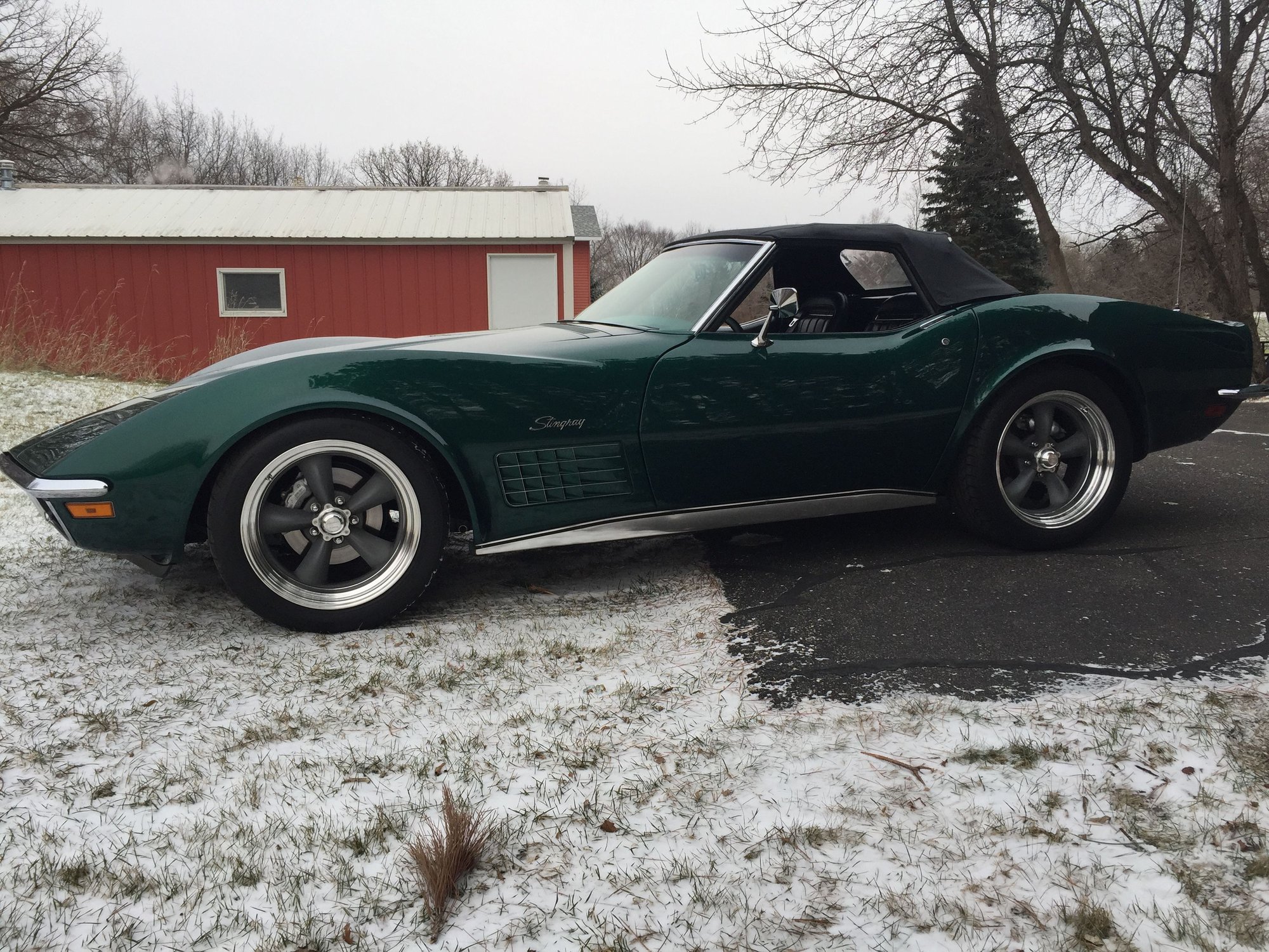

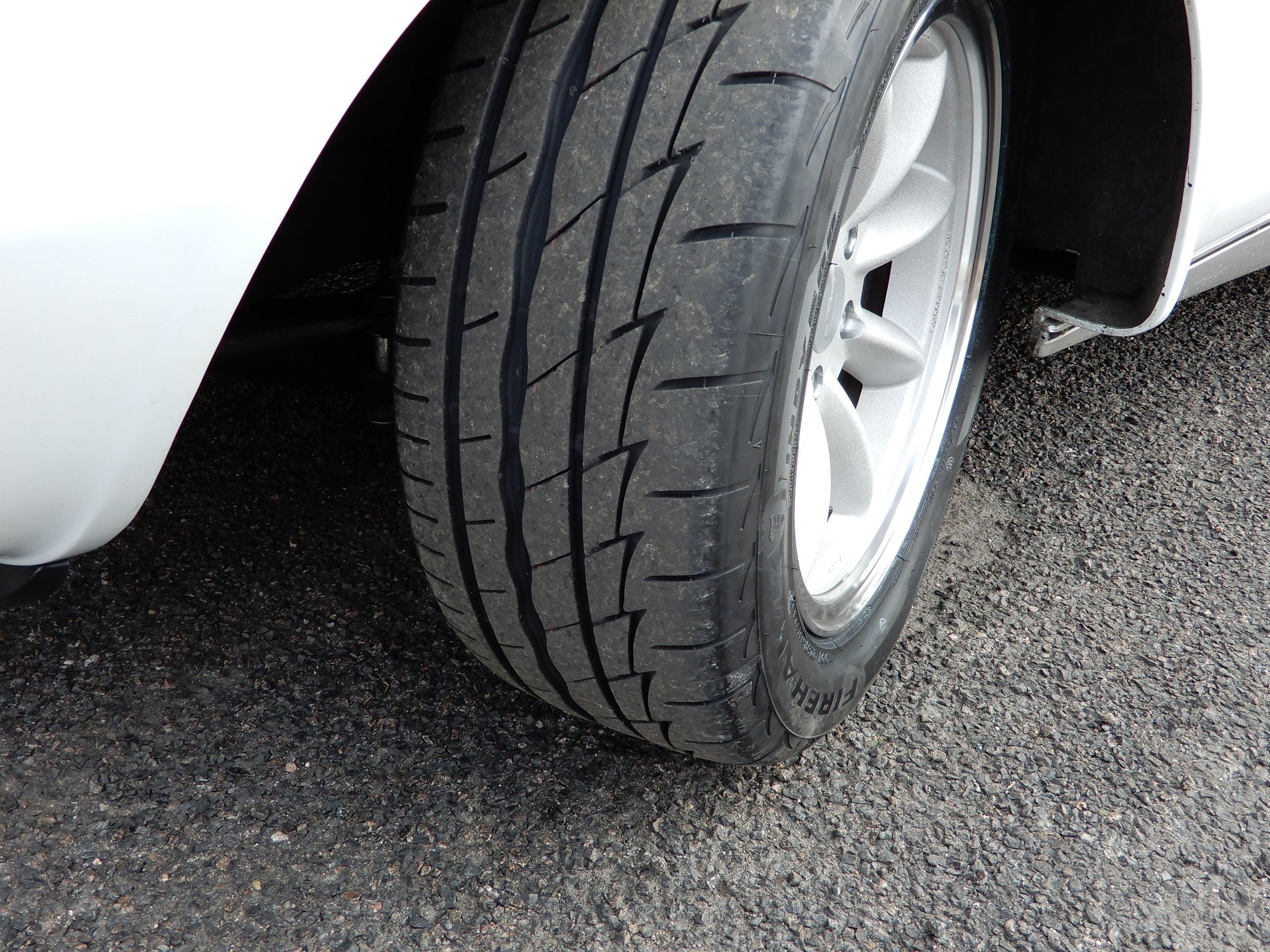

I have 255/50r17s on the front. The decals are from Tredwear. I like the look, but I’m not impressed with the longevity like I talked about in the thread.
I leave the car parked in a heated garage in the winter. I’ve only had the Nittos over last year, but didn’t have any issues leaving them on. I’ve heard of people increasing their tire pressure to reduce the chance of getting flat spots.
Good choice not driving on tires that old. When I first got a different ‘76 it was on tires from 1989. That was a fun drive home.

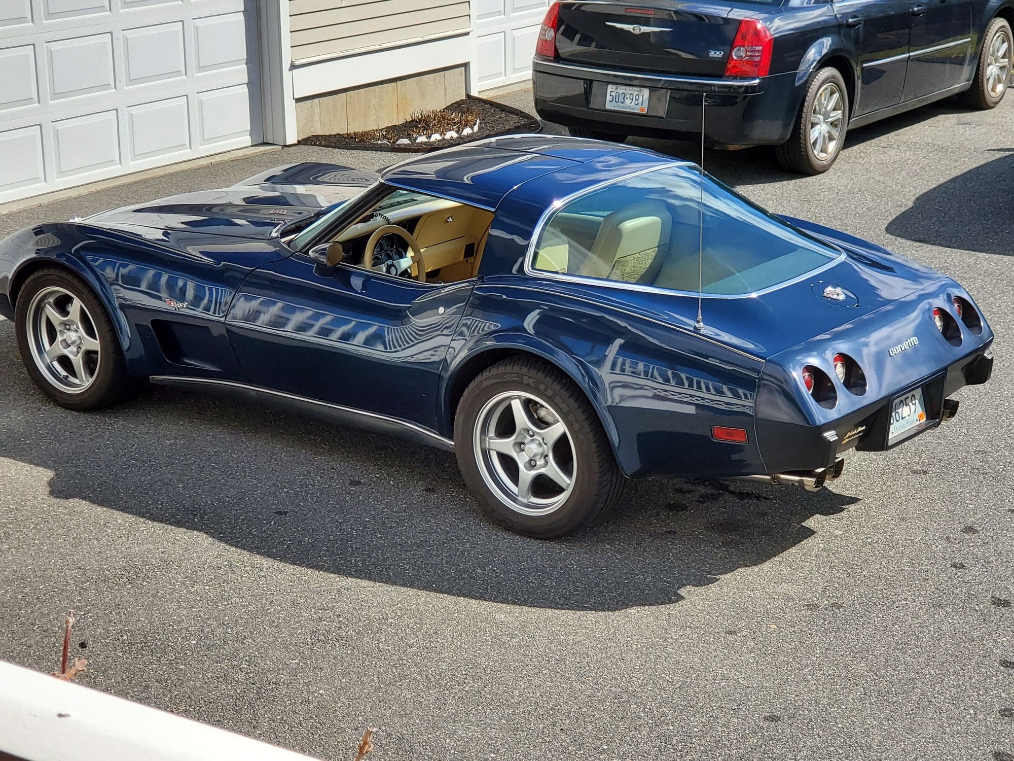

SLP 17 inch rims with Kuhmo 255/45/17 ZR Ultra High Performance Summer Only tires in front and 255/50/17's UHP summer only in the rear. The 255/50/17 is the same overall diameter as the OEM 255/60/15-27 inches.^^^^. Due to the 3.70 gears I wanted to not use a smaller rear tire which would increase the rev's even more at speed! I use the 245/45/17's in the front which lowered the car 1 inch, allowing for the proper forward rake, back to front, instead of the tail dragging, rear lower than the front look of most C3's, especially the later years, 78-82.
Go with 18 inch rims, if you can, since there are many more options in that tire size.
As for the warning posted above about summer only tires being used with the precautions mentioned, I have never had an issue using UHP summer only tires in colder temps below 40 degrees and I have much experience with this scenario for many years, past and present.
Just for context, besides my 78 L-82 above with UHP summer only tires, I currently have Cooper RS3-S's on my 1994 Mustang GT for several years now, Michelin Pilot Sport 4S's (in my opinion the best UHP summer tire currently available) on 2 other cars, one a daily driver, and a no name UHP summer only tire on my DD Chrysler 300 2008. I will and do drive any of the cars, aforementioned, in temps below 40 degrees and MUCH lower with zero adverse effects. I would never drive a summer only tire in snow conditions since the tread is useless with snow. In addition, just like with any tire, extreme cold will harden the softer rubber on a UHP summer tire more than an all season but I have never experienced dangerous driving with these tires in very cold weather. When driving an UHP Summer only tire in extreme cold, I am just more cautious with aggressive driving. As for potential tire damage, lets just say, I don't buy that warning (sounds like the BS of trade tires every 5-7 years with no damage or wear, even when stored in a garage) and never have experienced such an occurrence, with an n=10+ UHP summer only tires over 20+ years....many sets!

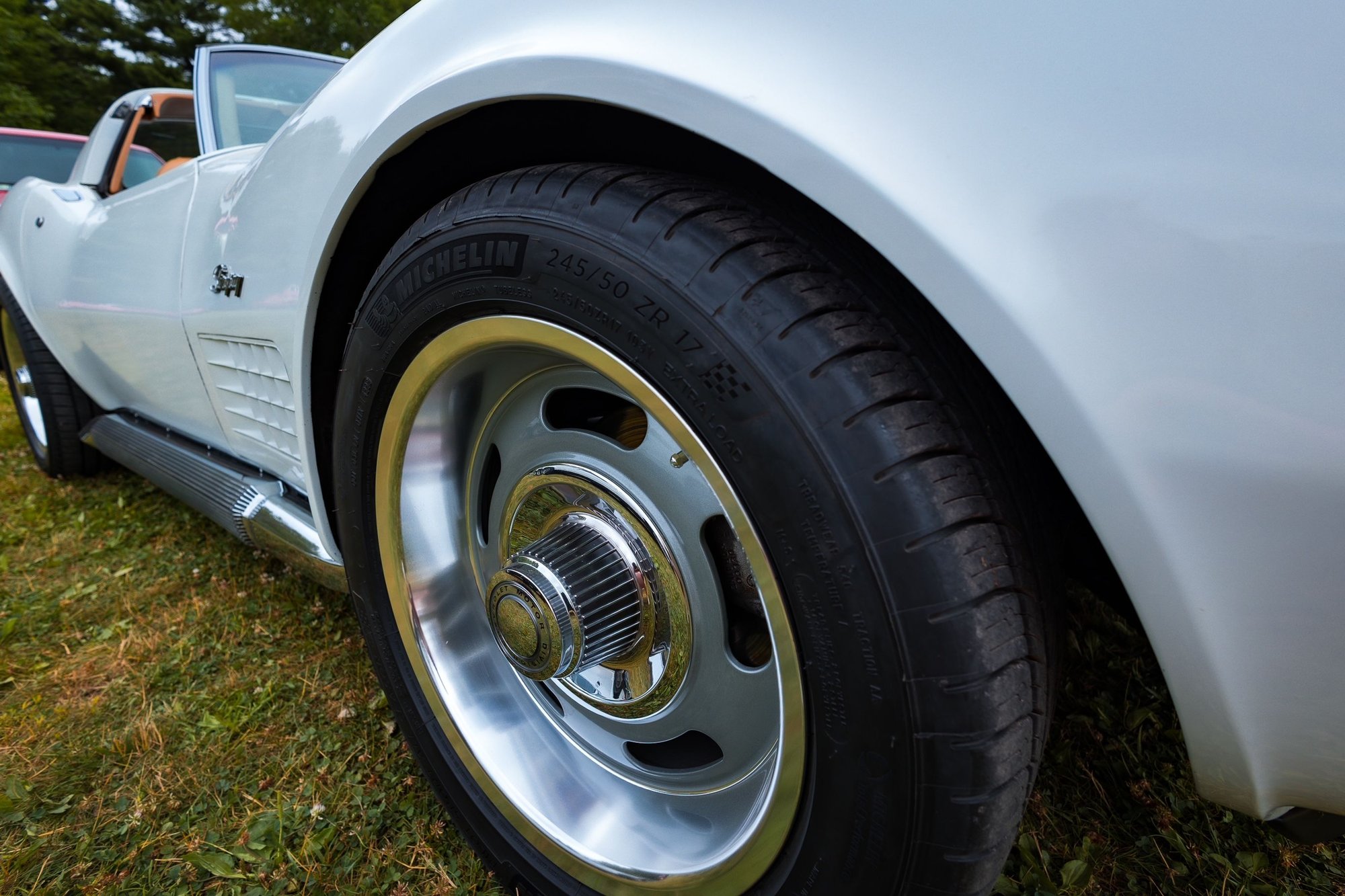

An excellent tire..
Michelin Pilot Sport All Season 4 Ultra High Performance All-Season Tire for Sportscars in 245/50ZR17

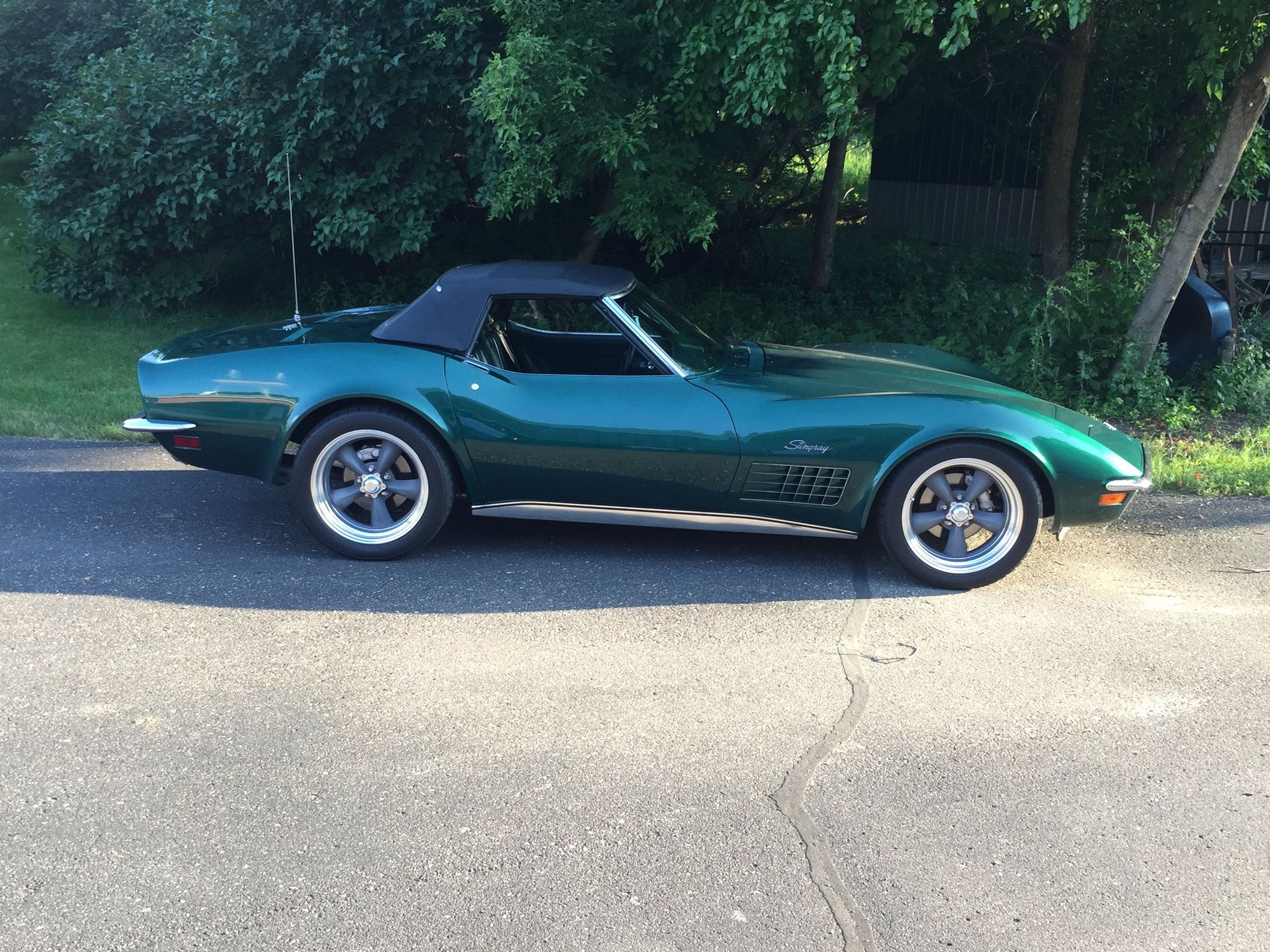

I would go with a all season tire of some brand. My current hot rod is a 80 Camaro with 18" General all season tires. Never had it on snow or ice but I think it would be OK?
As said above I would go with 18" due to the larger selection tires and wheels.

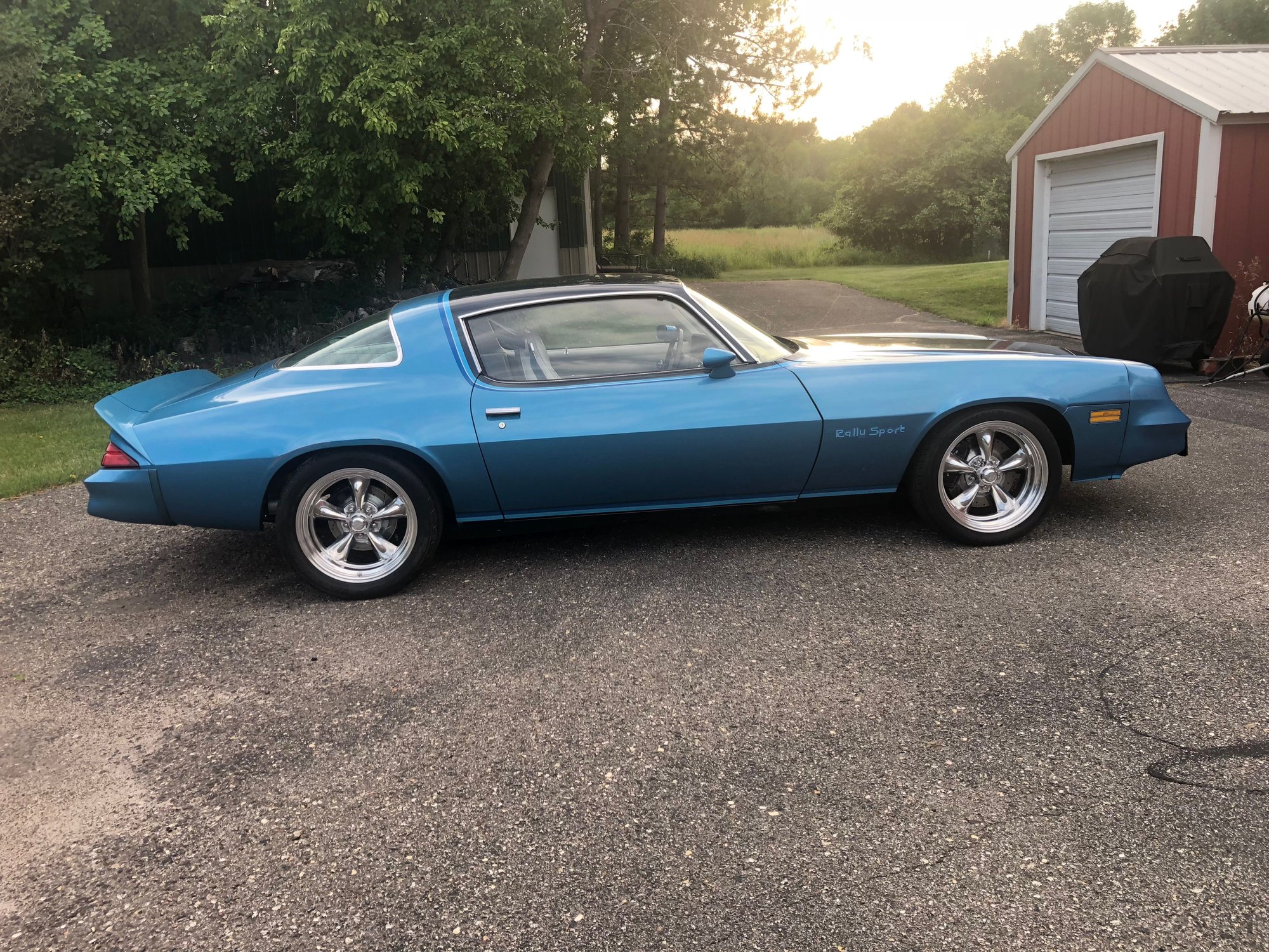

Pic of my 71 with 275/40-18 rear with TT2's 8" wheels. 245/40-18 front TT2's 7" wheels. Gray spokes.
Pic of my 80 Camaro with polished TT2's. Same wheel size.
