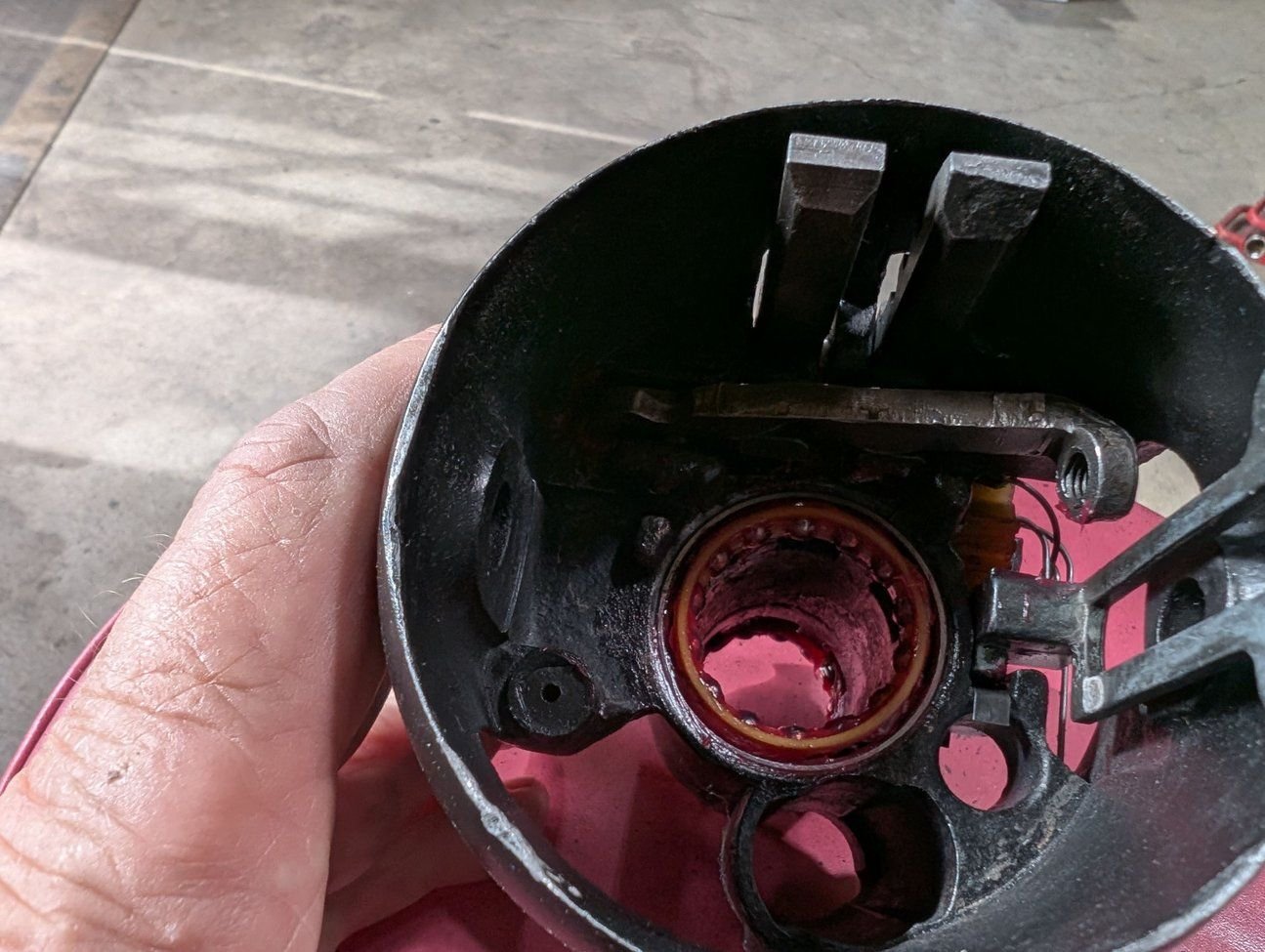

Here are some pics I found on the forum to show what I'm referring to as far as ball bearings. Looks like they cleaned off the factory grease and added new grease:
This is a pic showing the white plastic sphere on the shaft that is greased. So needs to be plastic safe:

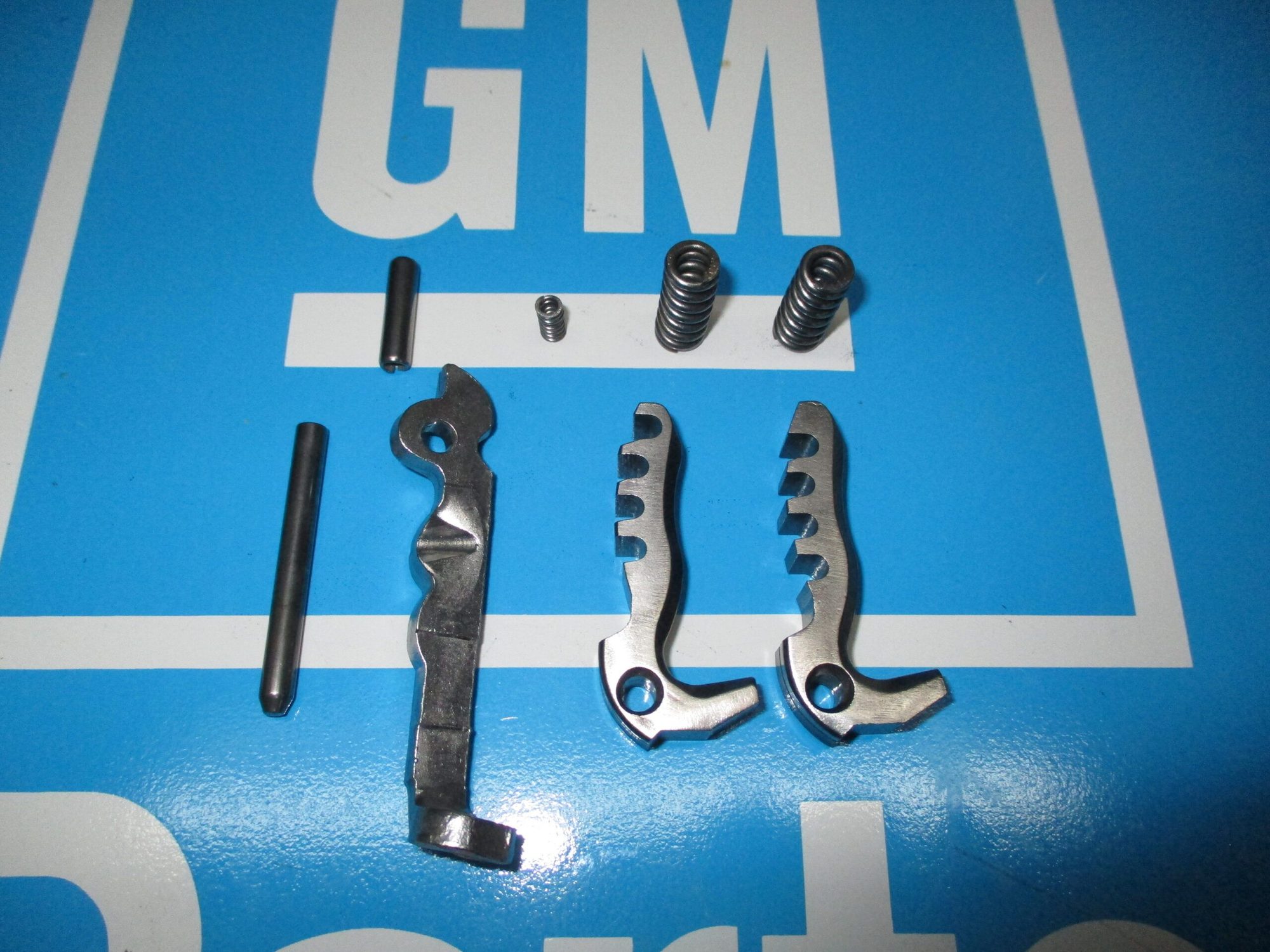

Thanks. I have already read some of his stuff in the downloads thing I saw people posting and did read about not greasing shoes. Had been doing research on what exactly he was talking about. And I assume no grease in the grooves of the two metal bars as seen in the below photo? And no grease in the two bar things you see at the top of the housing in the below 2nd photo?
If I have the correct locations NOT to grease. I believe he's saying if you grease those areas, then the steering wheel's "tilt" may could change without you engaging the tilt lever.

Those first couple of pictures are mine from a column I restored for my 69. I use the Mobile 1 Synthetic red grease as it does meet the GM spec. I think I just sent you a message as well.
