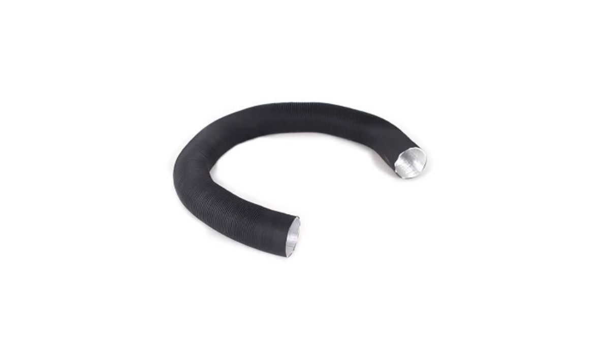

Speaking of duals. I don't have any of the flex hose (which I've seen online) but the plastic piece that they connect to is missing as well. So right now it's only taking in engine bay air. I've been looking online for those pieces but not sure where to get them. Any suggestions?

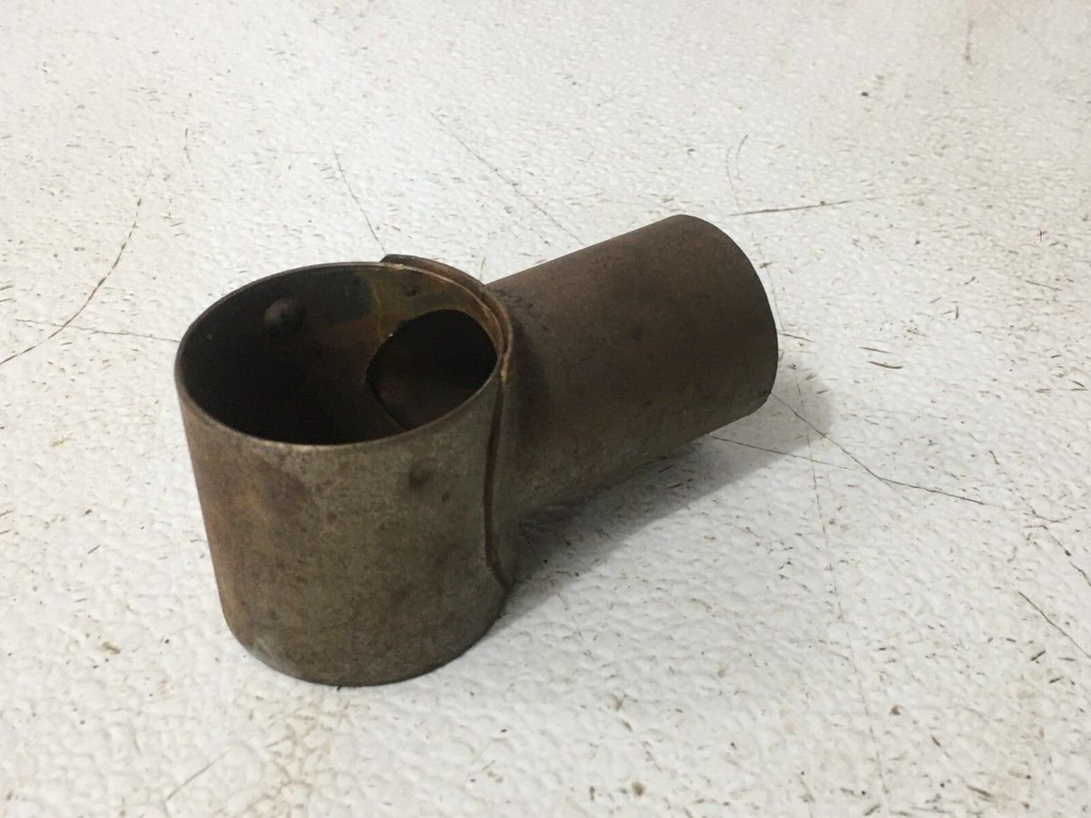

The heat stove elbow and pre heat hose?

The factory dual snorkle unit and the airbox that goes with it on top of the rad is the best performing air cleaner unit for these cars albeit a bit ugly.....the L-82 had a chrome lid.
This air cleaner, you carb and Edelbrock intake will support up to 400hp......pull an cap the vacuum line line going to the cans.....they go to a distribution tee on the water neck. All of that **** can be removed and don't worry about the flex tubes....they were to help the car warm up faster.....which is questionable.....it only made it think it was warmed up.....
Air cleaner center duct over radiator only on Ebay

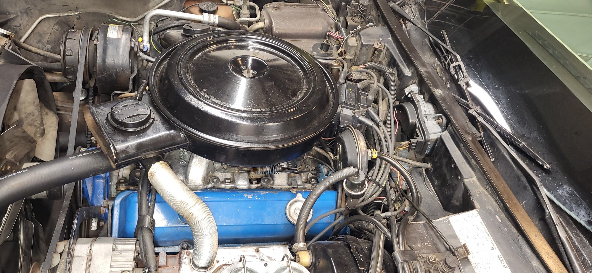

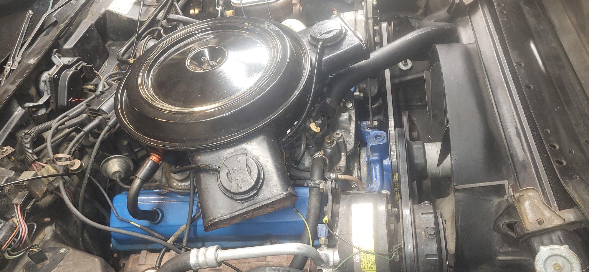

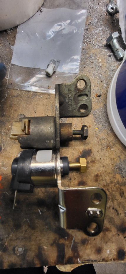

Some pics. Can anyone tell me what the thing is in the last picture. I bought a new one but it seems "shorter" than the old one. Someone told me that this is for when you use the air conditioner it will "pop out" giving it a little more throttle to make up for the power usage of air conditioner. I can't find any info on this and what it exaclty is for.

Not sure that's an L-82 check for a 8 inch balancer. 79 L-82 corvettes had aluminum valve covers too.

That's a nice clean loooking set up. Kinda what I'm looking for. The engine bay needs some cleaning up, as the pics I posted show.
