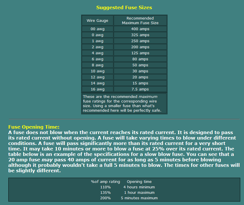

A fusible link, fuse and/or circuit breaker is designed to JUST protect the wire from melting-
What temp the wire gauge is rated at is what size you would fuse it-
BTW - just about all new cars use FUSES rather than fusible links- as they are a lot more serviceable.-

Thanks to those who offered suggestions. I suggested a 30 amp circuit breaker as it would be easier to get off the road with a circuit breaker than the fuse link. The original fuse link was 14 gauge, the wiring is 10 gauge so rated for 30 amps.. Even though I usually would want to replace things with original, I feel there might be a better alterative today. I have decided to replace the fuse link with a new style spade type in-line fuse holder and start with a 30 amp fuse. That way if it blows, repairs can be made on the side of the road. The original fuse link did not blow, but moisture got in and the fuse link corroded and broke. again thanks to all,

I agree, a fuse is only there to protect the wiring. Since the original circuit is made up of both 12 and 10 gauge wire, an in-line ATC style fuse holder should work with a 30 or 40 amp fuse. The alternator is a 37 amp unit. The original fuse link was a 14 gauge fuse link, so I should be ok and would be easy to fix if it blows on the road. I have decided my original idea of the circuity breaker is not a good one. An ATCV style fuse like most of the today's cars use should work and not be too much of a change.
