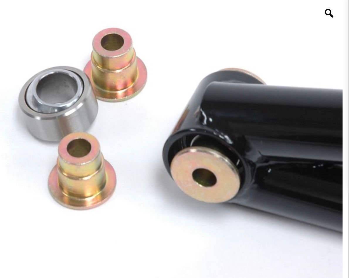

I've often thought that some sort of cam shaped washer installed somewhat like this arrangement could fix the trailing arm's rear steering effect on the cart. As the arm rotates up and down, the cam compensates for the steering angle change in the arm. The world wide market for a fix like this is maybe 10 or 20 people. One of you guys needs to get busy!

Geometry wise, the only way to get rid of the rear IRS's self-steering bumpsteer, is to ditch the trailing arms, and go with 2 forward links, and 2 horizontal toe links.
Then you have toe control.
The hub portion of the trailing arm moves in an in & out arc, while the front pivot point is fixed.
Yup. In my imagination, the front pivot would no longer be fixed. It would move left or right riding on the surface of a cam as dictated by the up and and down tilt motion of the trailing arm.. And as a sort of a bump steer correction. One degree up, X-degrees over. Sounds like a good grad school challenge. Maybe. The gold colored fittings in the picture would become a more complex surface (the "cam").
My trailing arms are from Global West with the ball shaped pivot. A little more freedom of motion but it deoesn't solve any geometry problems. No zerk fitting either, that's kind of cool

That looks a bit like the bushing Van Steel installs

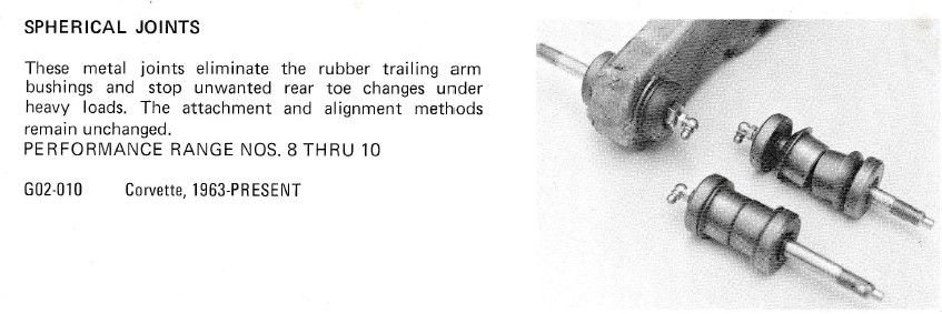

Could something like this be used if made to fit trailing arm?
