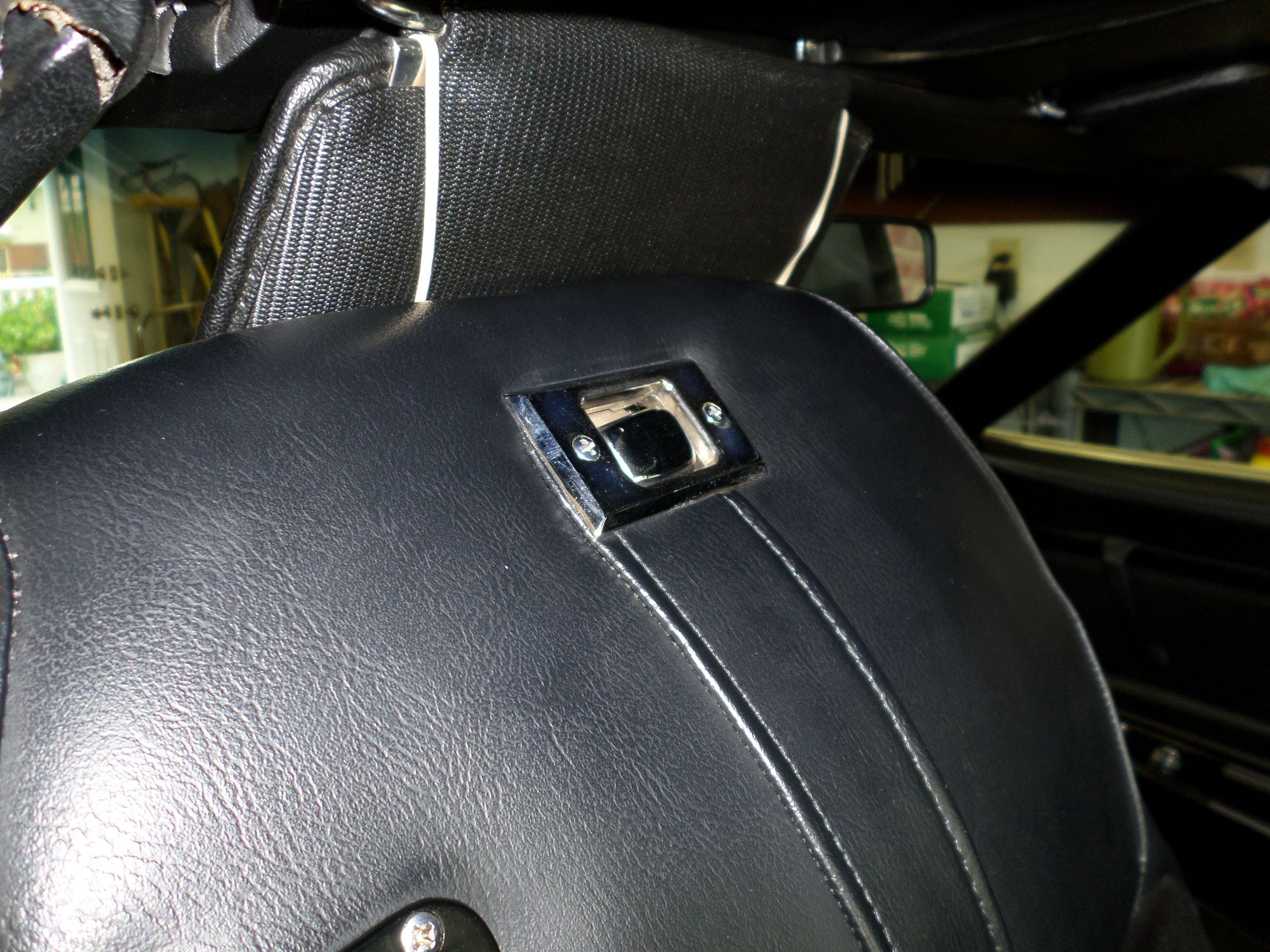

Hello,
This is the button that is pushed to release the seat back so it can be tilted forward.
Regards....

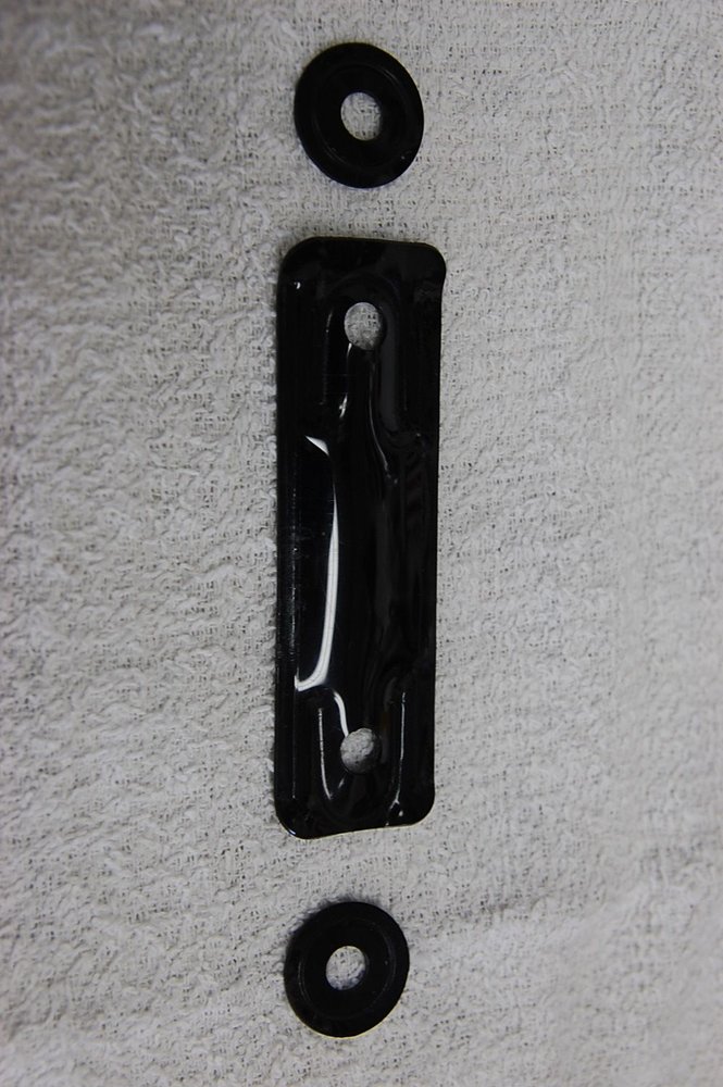

Release 'button' for seat back
Seat base where shim plates and washers are used to change seat back angle

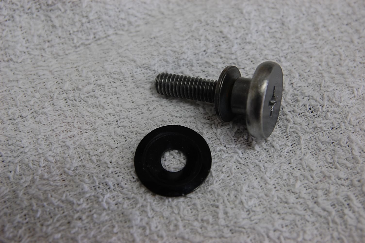

Seat base hardware
Seat base parts

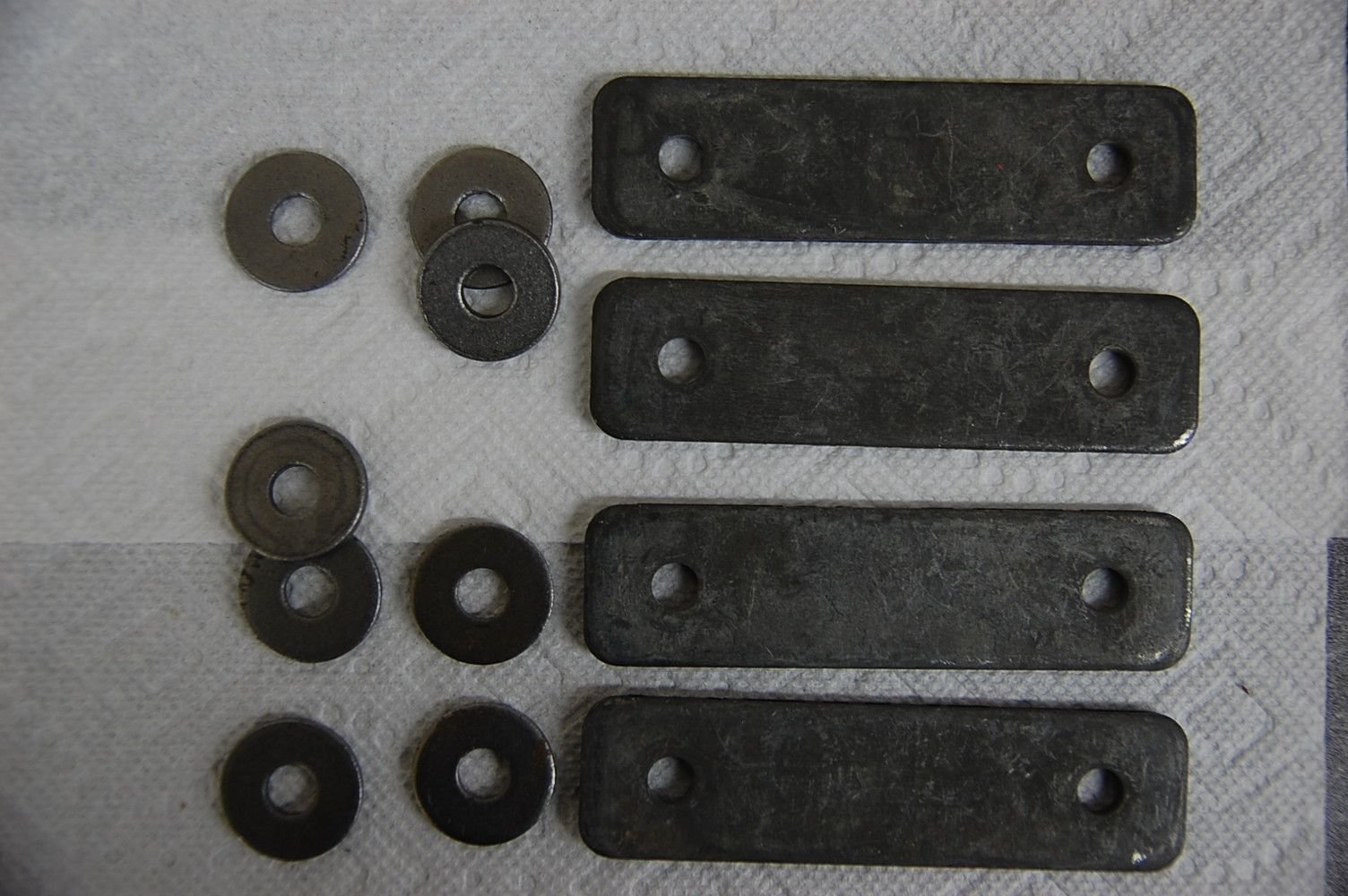

Seat shims... plates and washers.
