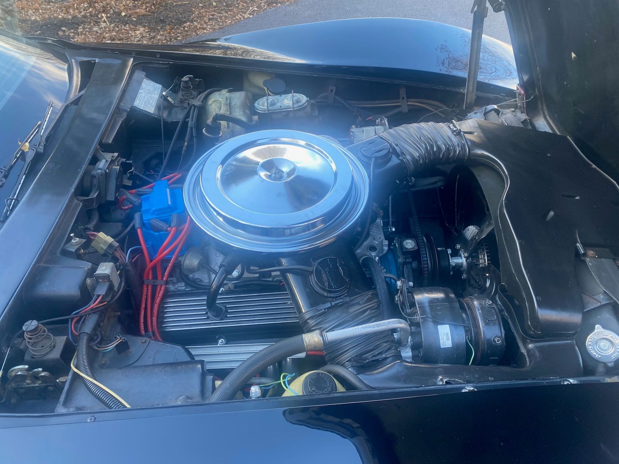

Hello good people of Corvette Forum!
I have a 79 L82 4sp w 70k miles. Bone stock. So I am upgrading the engine so it runs and sounds like a real Corvette.
I would love everyone's thoughts on this set up. Specifically am I OK on hood clearance?
AFR 195/64cc heads
Edelbrock Performer RPM intake
PRW 1.6rockers w 7.75 pushrods
Doug's D334b headers
Stock L82 cam
Going to rebuild the Q Jet carb.
Will run through 2.5 exhaust and Flowmasters.
Are the springs in the AFR heads too stiff for the flat tappet cam?
Anything else to look out for? Drone from the Flowmasters?
Thanks all
John

Will it fit? Yes it should, I ran a very similar set-up for many years on my 77.
Here's the thing thou, the drivers side motor mount on manual cars is notorious for letting go. When it does and you launch it hard. . . .
Well, I ended up with a nice star crack in my original hood.
I highly recommend you concider Moroso solid mounts. I got tired of replacing stock type motor mounts.
And I know everyone on here will say keep the quadrapuke!
I put on a Holley with the correct RPM manifold.
Your changing the exhaust, the heads, the compression, even the cam by going 1.6-1 rockers. You will need to tune that quadrajunk. Tuning parts are as rare as rocking horse ****. And people that know how to tune them properly are also rare. So, rebuilding it yourself won't get it close. Send it to Lars. Or put something on people can tune.
And yes I believe that is really good advice.
You'll want to recurve that distributor as well.
And why are you putting mufflers on it? I thought you wanted it to sound like a Corvette!
Haven't had a muffler on mine since the 80's!
Have fun!

I rebuilt/upgraded my stock L-82 engine 4 speed with 66,000 miles in 2014 with a complete bottom end refresh, reconditioning many of the L-82 OEM components like the L-82 rods, L-82 forged crank, etc. with new JE forged Racing pistons, new rod bearings, new oil pump, etc. Based on my research and talking with many experienced forum members along with my local GM Chevy expert builder in my area, I went with AFR's (strongly recommend their heads) BUT the 180 64 CC, not the 195's, despite the 195's flowing slightly more CFM at higher RPM's (where my engine rarely would be), but will be more sluggish than the 180's in the low RPM range, with the 180's having much stronger mid range torque. My experience now 11 years years on with the AFR's is spot on with this assessment.
As noted on previous posts recently, the L-82 cam with some compression is actually pretty impressive for a flat tappet cam and will be even better with 1.6 ratio rockers. My OEM L-82 was running comp cams 1.5 roller tipped rockers at the time of the upgrade which I reused on the rebuilt L-82 355. If you do want to replace the OEM L-82 cam, I would highly recommend my Howard Roller Retrofit cam with .525 Lift/LSA 110/duration 219/225 versus the L-82 cams .450/.460 lift/Duration 222/LSA 114 with the roller cam just making more power everywhere in the power curve versus a flat tappet cam, even with similar specs.
As for the intake and carb choice, the Edelbrock RPM is a good choice BUT will not fit the L-82 OEM dual snorkel cold air cleaner intake system (you will need a drop base open air cleaner), if you plan on keeping the OEM setup and look, like I have and did. I reused the OEM aluminum L-82 intake manifold, mildly ported by my engine expert friend, retaining as much L-82, as possible within reason, considering this 78 C3 is confined to street driving with occasional high rpm blasts. I wasn't looking for maximum HP/TQ everywhere but ended up with serious HP/TQ, even with a few compromises, like the L-82 intake . If I would change my intake manifold, I would consider also the GM SBC ZZ4 intake since in most test I read it produces the most power, very similar to the OEM LT-1 intake BUT 1/2 inch shorter. If you have the OEM L-82 Quadrajet send it to LARS for a rebuild/tune, but definitely keep it, even if you use a different carb. I did not have my original Qjet and have been using a Holley 4175 650 CFM vacuum secondary spreadbore (which is designed to be a direct replacement for the Qjet) for 40 years with tremendous success on both the OEM L-82 and the L-82 355 with some minor easy tuning.
I run 1 7/8 inch LTHeaders through 2.5 inch duals to C4 corvette Borla Type S SS mufflers, custom fit to a C3......pretty much optimized exhaust for my setup with an incredible unmatched sound, IMO, for a SBC Corvette....no motorboat sounding exhaust or drone but more of a tuned SBC V8 sound...very unique.
