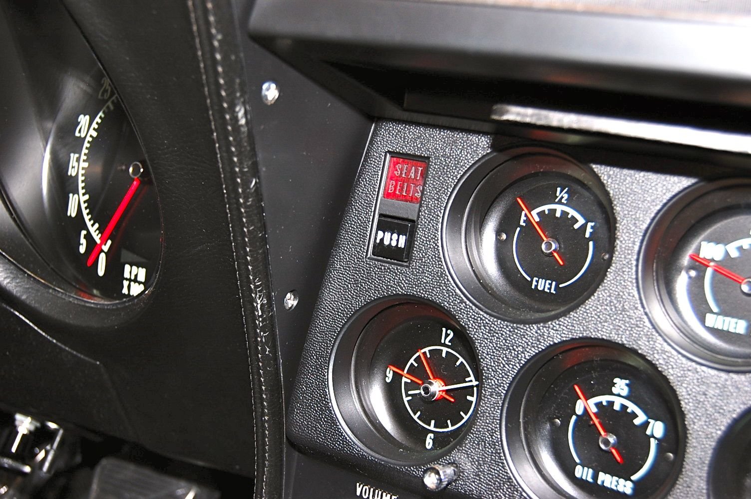

Hello,
You're wise to look for an unbroken original.
There's an easy to spot difference between an original bezel and a reproduction bezel.
Try to find one that has good chrome plating on it...the black paint finish can be restored.
Regards....
The 'bar' is part of the casting.
After 71 the switch was deleted so the bar went away.
It's added to the reproduction bezel and the 'seams' can be seen.

Yep, the reproduction is from a '72 mold. They just glue in the seat belt warning lower section and the divider to create the '69-'71.
