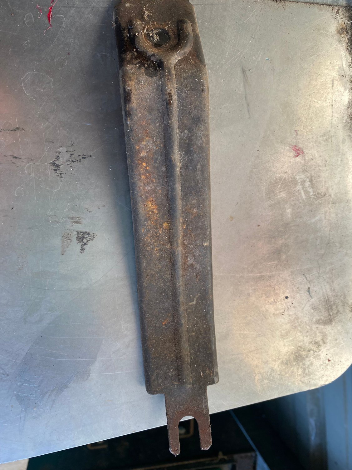

Sorry…came off a 1978 C3 a few years back and can’t remember what they are!
please see pics. Thanks!!
Part 1. Photo 1.
Part 1. Photo 1.
Part 1. Photo 2.
Part 1. Photo 2.
Part 2.
Part 2.
Part 3.
Part 3.
Part 4.
Part 4.
Part 4.
Part 4.

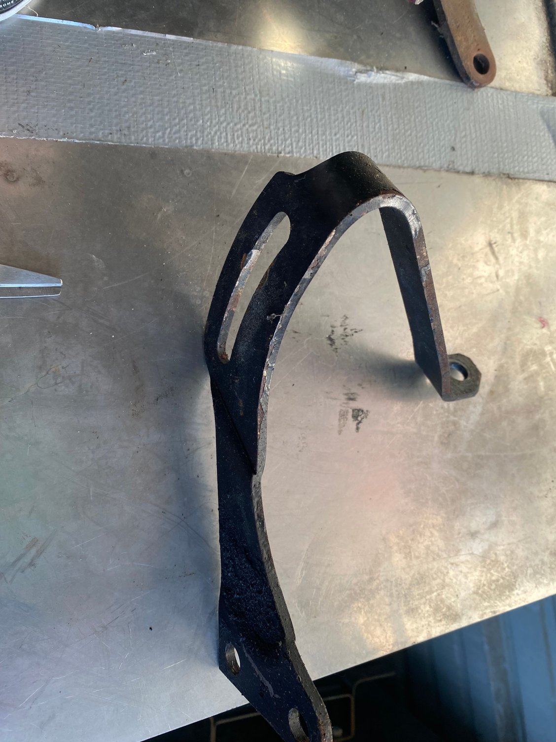

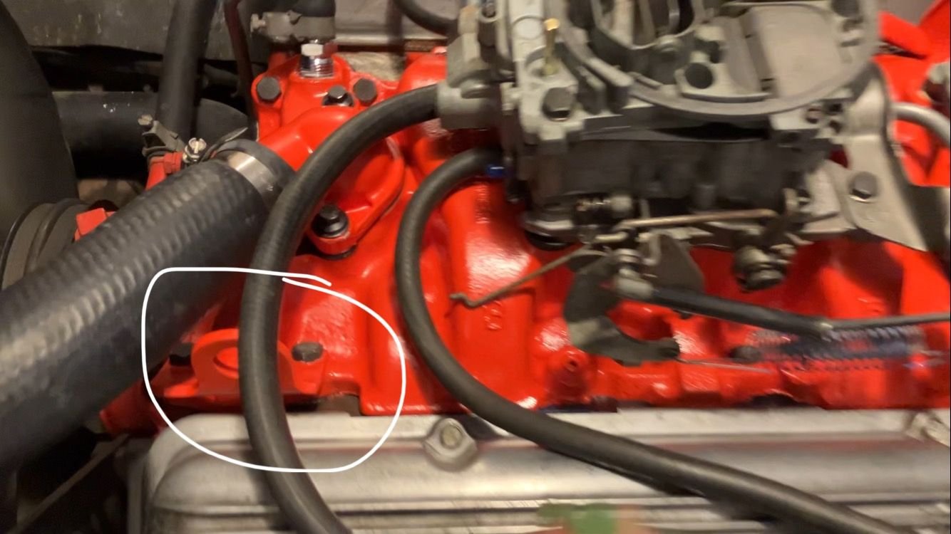

The picture #3 shows one of the engine 'lifting eyes'.
The blue paint is a clue.

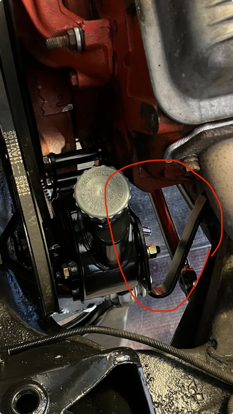

Part #1 is the power steering pump bracket

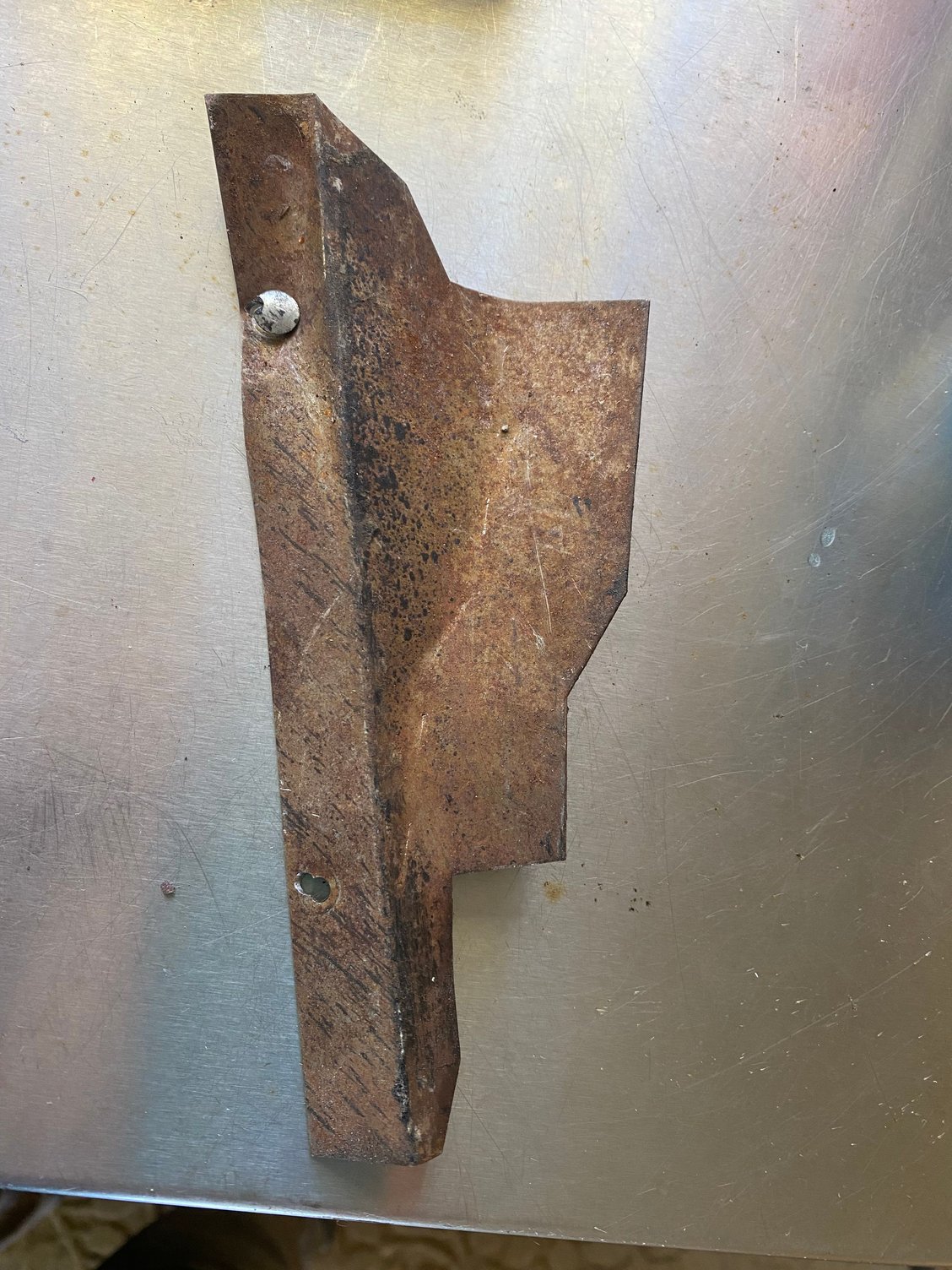

Could Part #2 be one of the ignition shielding brackets? Just a guess - haven't looked at mine in a while...

Part 1 is one of the two PS pump brackets, it attaches to motor mount and rear of pump. Part 3 is the engine hoist hoop attached to intake.
