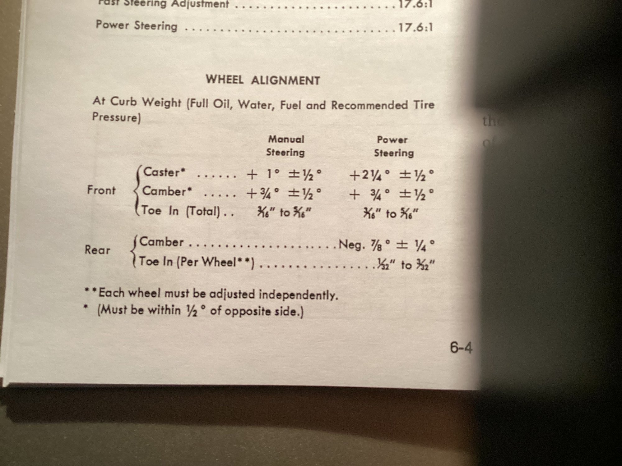

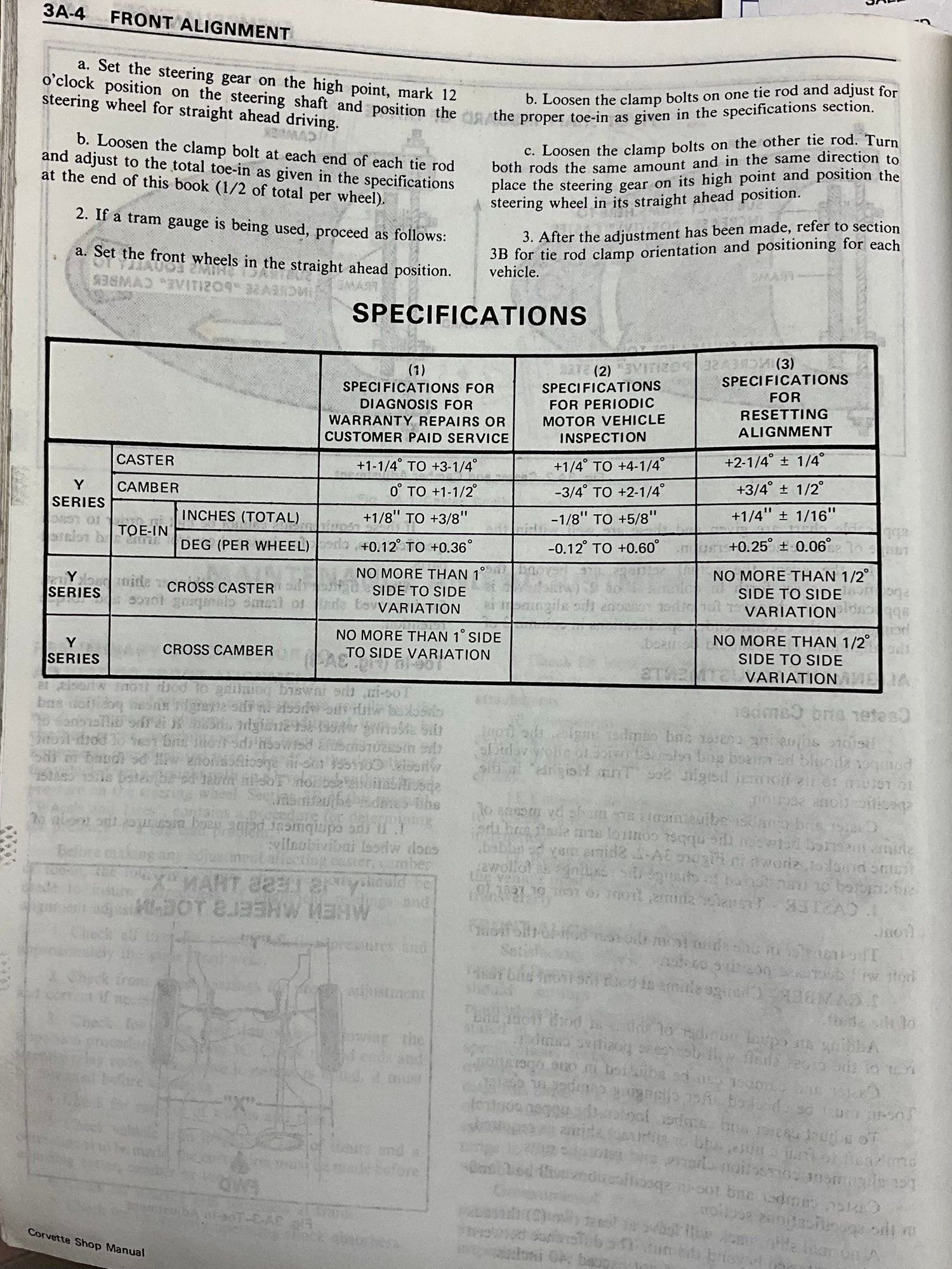

I have had a number of C 3’s over the years, however the 1976 I have now just does not feel right while driving it. The car just seems a little unstable while driving down the roads. I confess I am not schooled on the front end geometry of the corvettes, but I have a feeling something is not quite right. The vehicle is a power steering model and has 70,000 mile and I have checked for undue ware on the front end and all seems tight.
I want to take it in for an alignment and would like to be sure I have the correct alignment specifications. The owners manual has a set of alignment specifications, and I have seen other manuals with similar specifications, but some what different.
So my question is should I use the specifications from the 1976 Owners Manual or are their a better set of numbers from the past experiences of other members?
Thanks in advance from the Forum Members.

The biggie I have found as far as not wanting to drive straight is toe-in - both front and rear need to be toed in.
When I drag raced my '59 I toed out my rear axle as under heavy acceleration the wheels want to toe-in.
Later on for dedicated street driving I had to undo some of my "performance" modifications
Couldn't figure why my car wanted to wander until I found GM Tech Bulletin regarding needing toe-in for straight rear axle cars.
Re-bent the axle housing to achive toe-in and voila - nice rock steady - car just drives perfect now

Thanks to you USMC 6113 and QIK59, I was thinking maybe the Caster not being correct. I want to have good numbers to tell the tech.

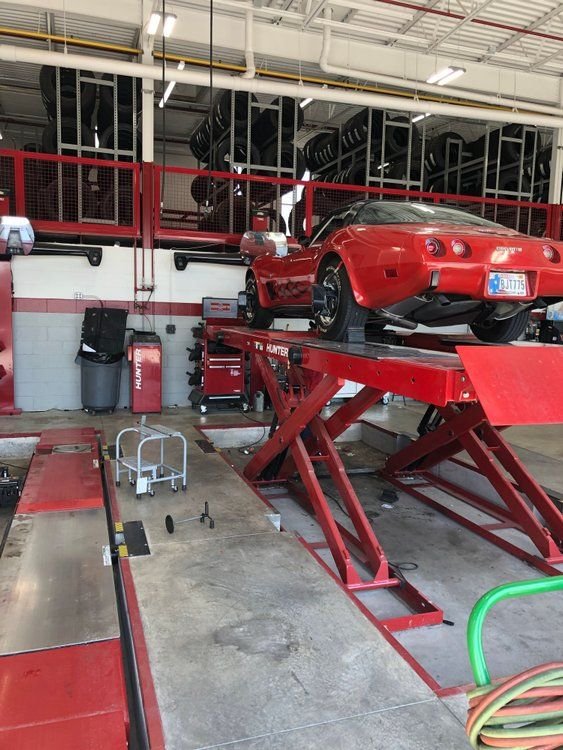

Lots threads on alignment
https://www.corvetteforum.com/forums...ent-specs.html
i used the reset factory and very happy street spirited driving.
you need to find a good alignment shop and bring rear shims. Triple check all bushings and traling arm idler arm etc..
i know not part of alignment but check your axle end play for wear. I am still surprised how it improved handling when throwing the weight around from one side to another.
i do not have the van steel settings or experience to compare but again, drives perfect for me no track.
good luck!

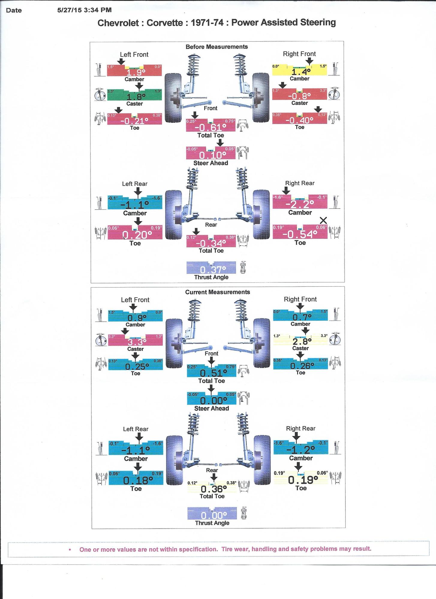

this is my 71, drives perfect and I've put over 25k miles on the setup. Car handles great and no abnormal tire wear.
I know there is a slight twist / kink in the frame, but it never affected the car.

Any recommended Corvette specialist in IN
hi, im in fishers noblesville and found belle tire off 37 and 141st. Guy was named chad and not always there. Hope he still is! i tipped well and he spent a lot of time tweaking.
