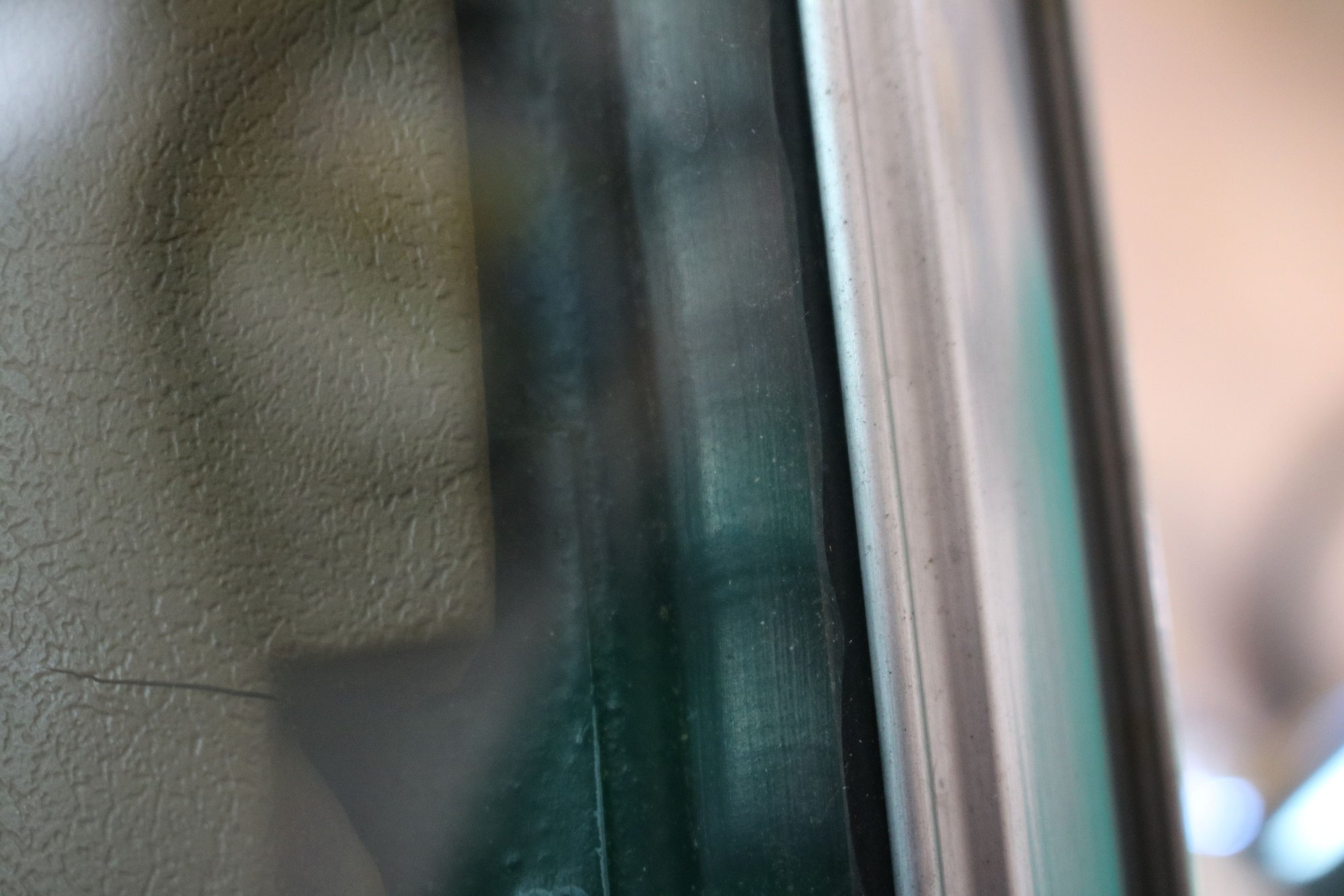

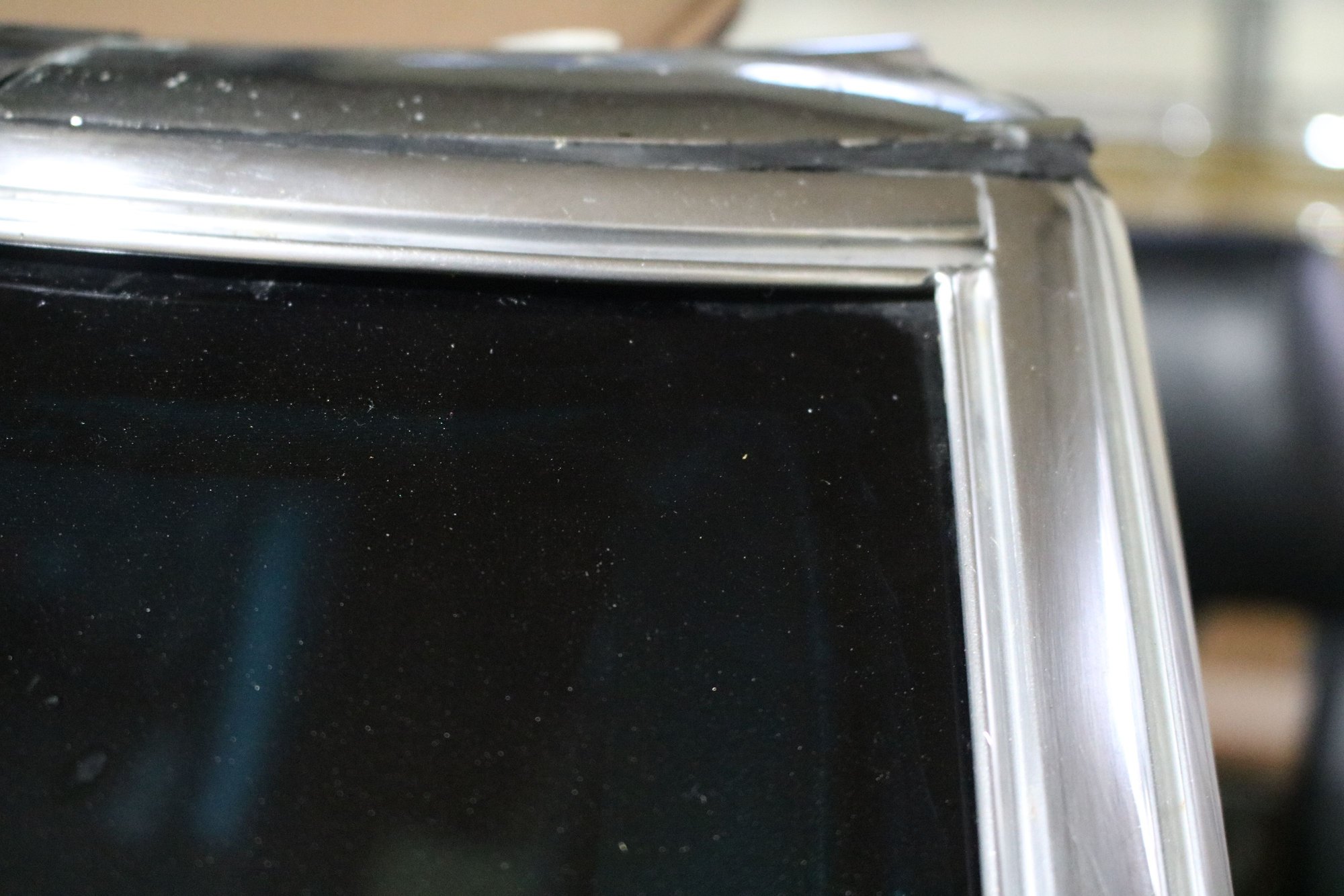

I had mine installed by a muscle car guy a few years ago and he just put a thicker bead of adhesive to raise the window up so the SS molding has no gap. Not sure about the thickness difference. He explained that the factory use Butyl strip adhesive which was thicker than the caulk gun adhesive they use today. Todays windshield adhesive is applied much thinner that the old butyl strips.
I guess it's not a thing anymore but Safelite did mine and they had the windshield in stock. Not NCRS or anything but I don't care about that.
I found the picture I took of the thickness of the adhesive applied:
SS trim fits well:
