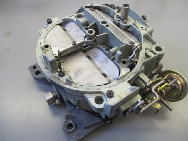

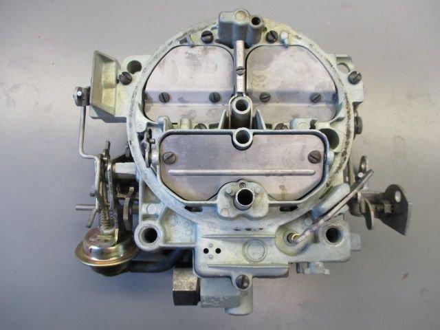

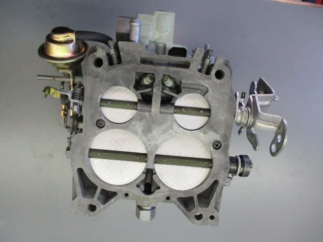

For the Quadrajet gurus... from an external view any red flags here, assuming 72 service replacement?

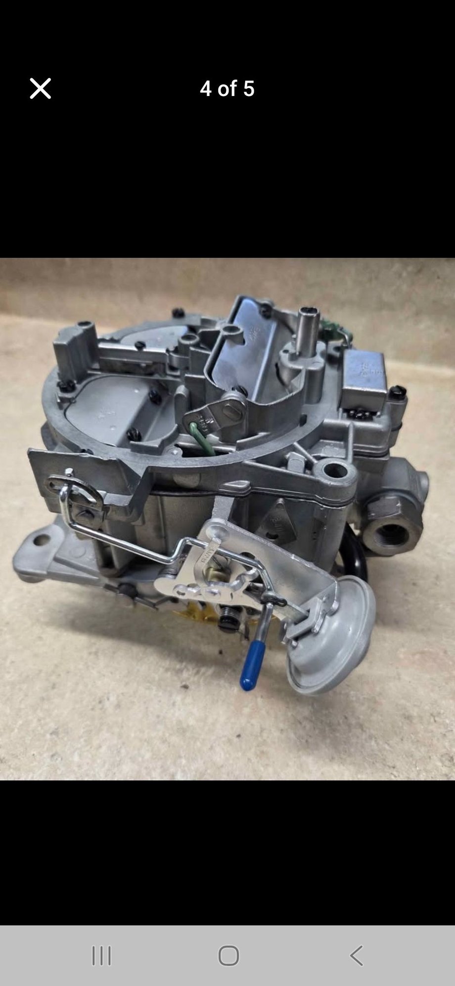

The entire body has been sandblasted or chemically stripped, removing the goldish greenish brown color that they’re supposed to be. If I had to bet, I’d say it’s been commercially rebuilt, meaning it could be a mish mash of all sorts of different model parts, probably never even tried being run on an engine.
Here’s the same carb # in the for sale section with the correct finishes. A better piece at a probably much better price.

Also like the thread I linked says, that’s for a 1969 350/350. Here is how to decode the numbers.

First, that's not a '72 carb. It's a 1969 Service Replacement for manual transmission only.
Secondly, it's a hacked, commercially rebuilt carb that has been sandblasted and stripped of all coatings. E-Mail me for my "Commercially Rebuilt Q-Jets Problems" paper for a list of just a few of the 100 things that will be wrong with that carb.

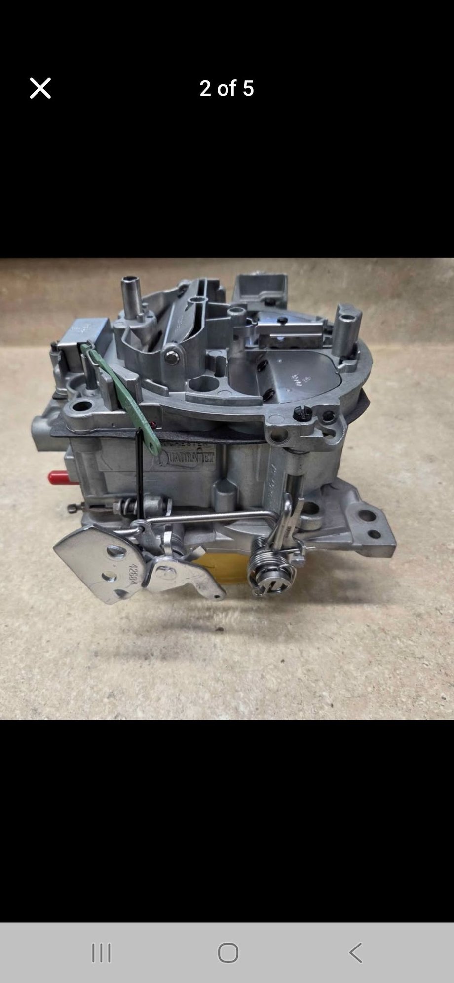

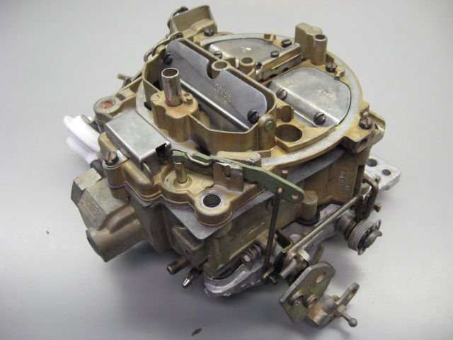

This is what a small block '72 should look like:

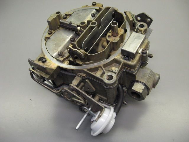

This is a 7029207 1969 carb:
Lars
