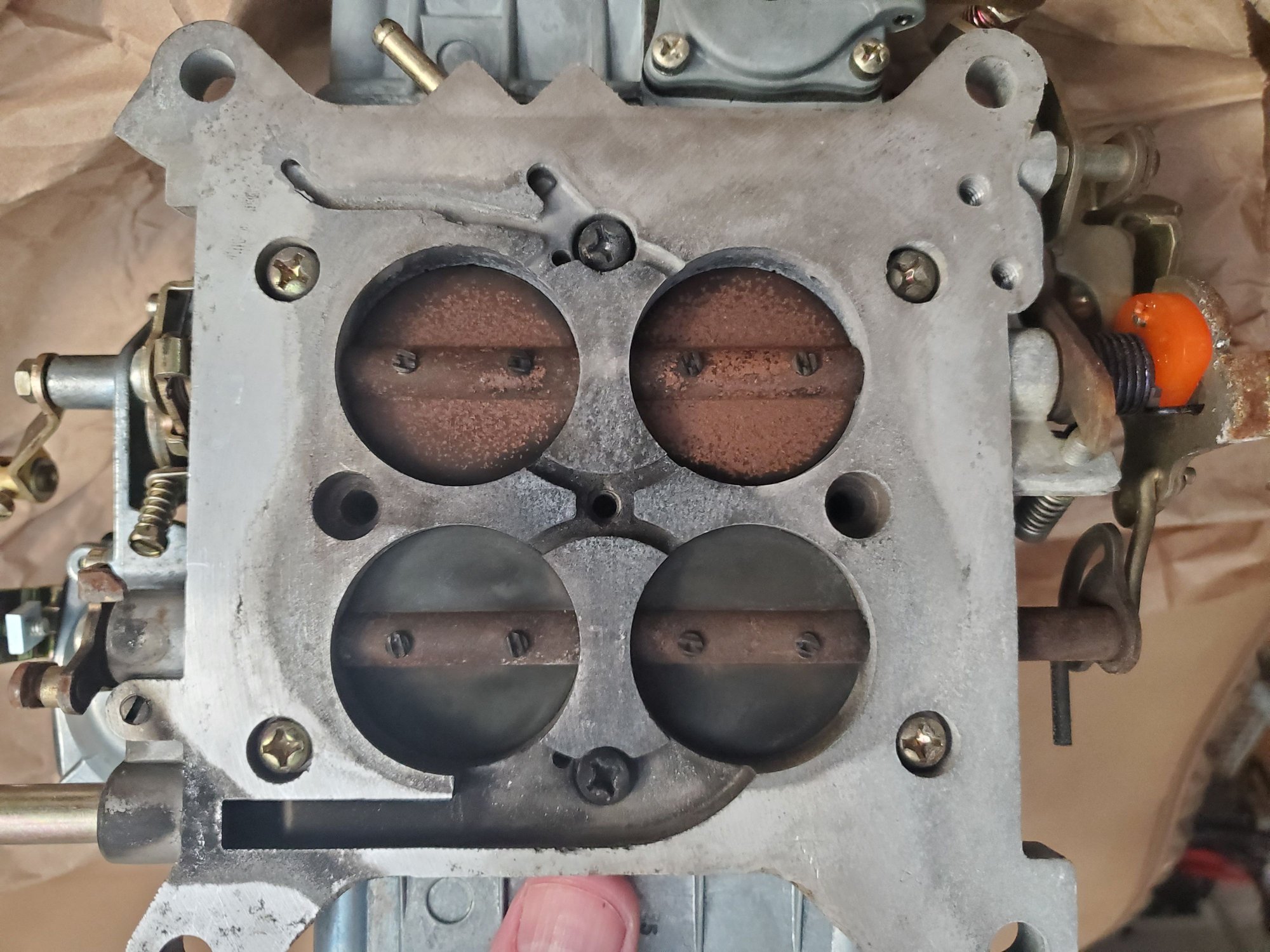

2. When inspecting it after re-discovering it, I noticed one of the secondary blades had oxidation (surface rust) on the underside. Would just sanding it and using something like CLP on it be good? Or do I even need to be concerned. I do not know enough to know whether or not that underside oxidation would cause something like pooling or not. If not, no worries. If a problem, and rebuilding, then I can replace it.

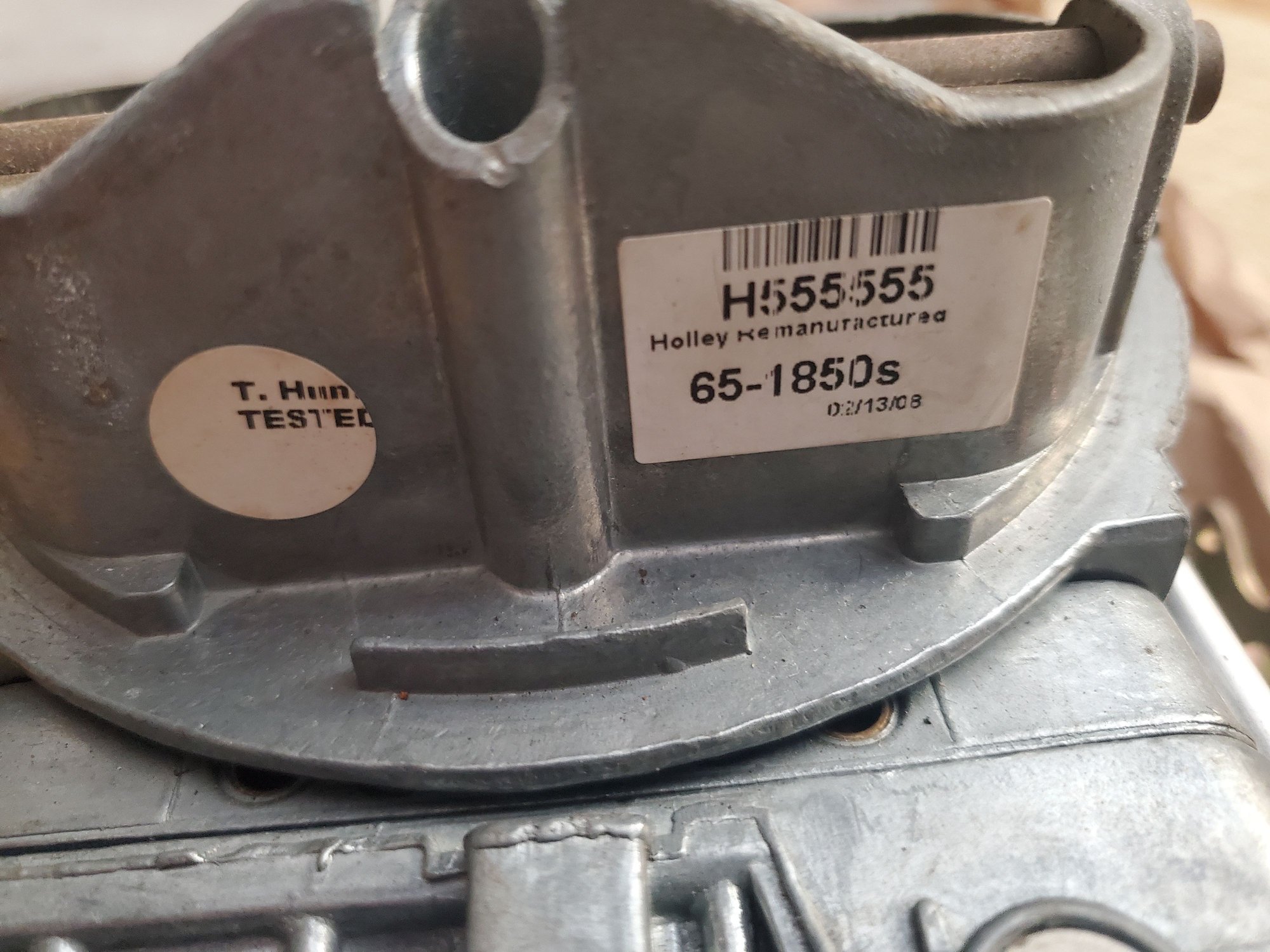

What is the list number of the carburetor?
Can you post a picture of the problem area on the secondary blade?

The carb will be just fine for general driving n the difference in HP vs a 780 will more depend on tuning. For the surface rust, try some WD-40 and fine steel wool or white scotch bride. Either should work.

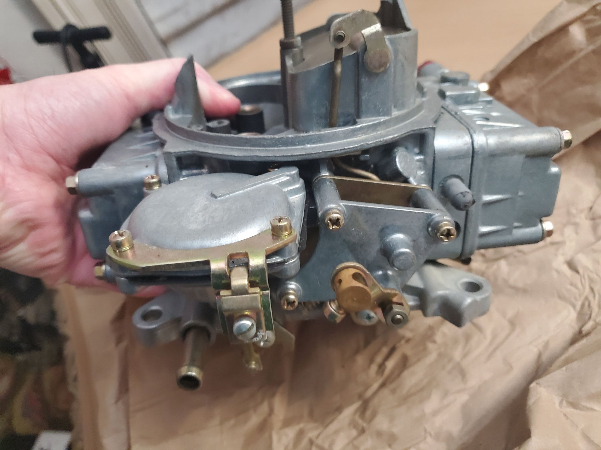

what sort of choke does the 750 have. For everyday driving I would want a reliable unit that starts easily.

Thanks for that info! I have not looked at it in a bit, but will tomorrow. I’m pretty sure it is a mechanical choke. I do not remember running power to it, but could be wrong.

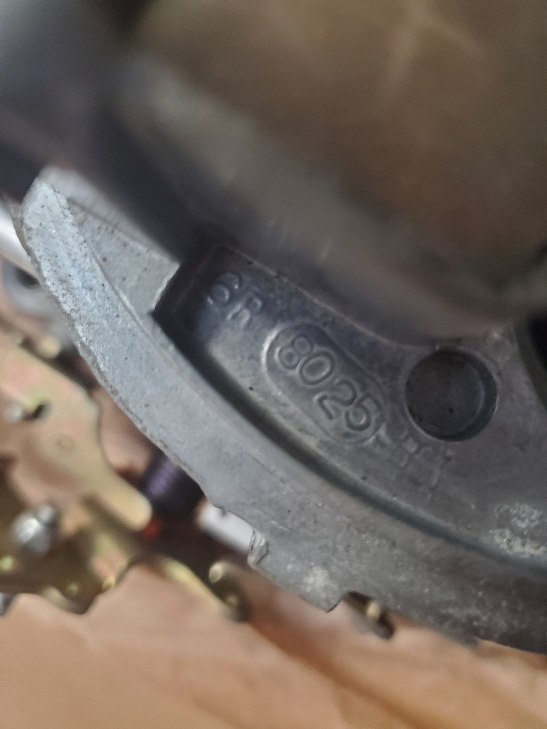

Ok, so after seeing you guys questions above, I went out and pulled it out of the box. I’m thinking I may not have kept the old one off the ‘69 after all. I think this may have came off of a ‘68 Firebird I had. Man am I getting old because this isn’t what I thought I saw when I re-found it a year or so ago.. I remember selling an Edelbrock and a Holley. I'm th8nking the Holley I sold was the 750 I had on the '69. 😔 I think this one is a no go. Air horn stamping is is 6R 8025 B1 and the reman sticker says 65-1850s. From my brief research, this is only a 600 cfm carb. Not really thinking it’s a good idea. And looks like the blades are somewhat rustier than I thought. Oh well. I can list it up for sale locally. Sorry to waste ya’lls time.
